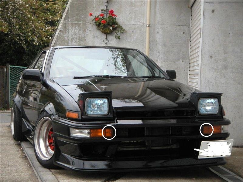

    Yeah it is a Kouki trueno. I believe the lights you are referring to are the parkers.
    The ones I'm referring to are in the picture below, excuse my shoddy photo shop skills lol

    The lights you have circled are the parker lights.
    It's a green wire no trace going to it, at the rectangular plug.
    If currently the outside lights are switching on when you turn on parker lights;
    you need to take the power feed from the red with yellow stripe wire.
    Re pin it to the green wire,no stripe.
    This only applies if when you switch to parker lights,the outside lights turn on.

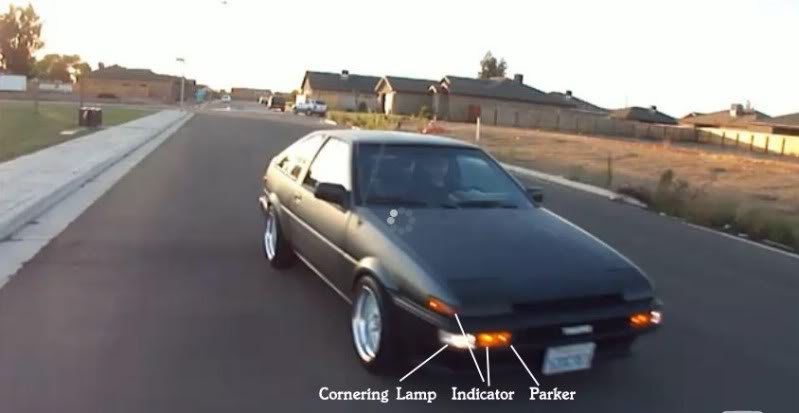

    Here's a pic with the lights labelled. Did this for benefit of those in the US, who usually just wire up ALL the lights to come on ALL the time.

    Oh okay, so those are my parkers. I've always gone by the assumption that the clear corner ones are the parkers.
    So the corner clear ones are meant to come on as well as the orange parkers?

    Here's a video of how it should work.
    It would be handy to have a switch turn on both cornering lamps. They light up the sides of the road quite a bit.
