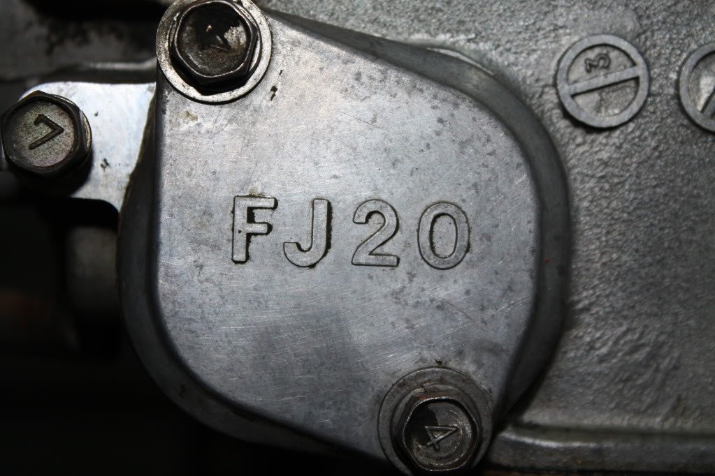

    more updates, stripped the fj down and since i've been scrubbing away like crazy to clean this motor.
    products that were needed:
    petrol
    degreaser
    brake cleaner
    paint stripper
    turps
    soap and water
    tools needed:
    tooth brush
    3 types of wire bruses
    paint scraper
    wire wheel
    its taken me ages to clean the crank case the head and the block. haven't cleaned the rocker cover at all coz that'll be repainted in red crinkle paint.
    the layers were tar, paint, oil, dirt, more tar, more paint. how weird is the burnt orange colour? was probably in a whacked out bozo car.
    sr clutch fan fits perfectly only fj part i was missing.
    much better

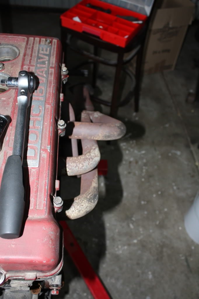

    test fitted the fj20e headers i picked up. they fit perfectly. measured them up and they'll clear the firewall in the spot on position.

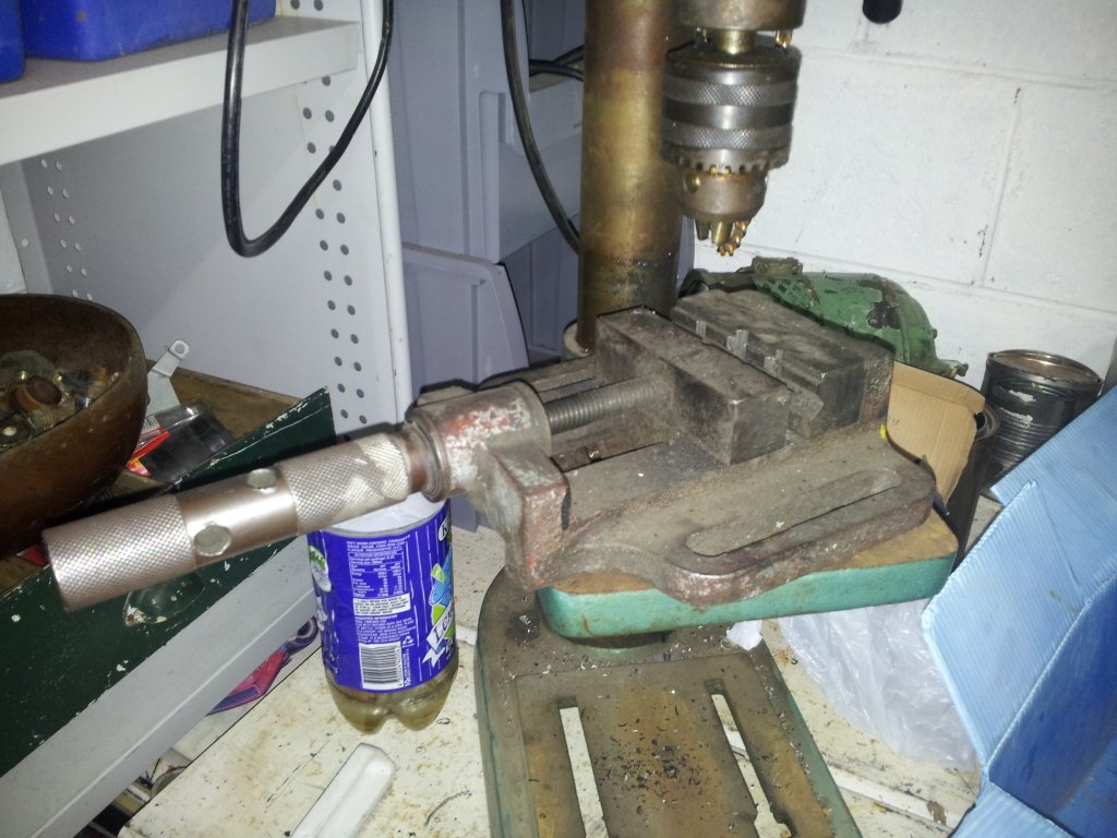

    then i knocked up this little bad boy to take off some of the excess alloy before using the same technique to file and sand each wheel. they still need alot of work but im getting there. i've improved it further by bolting it to the floor rather than the jack

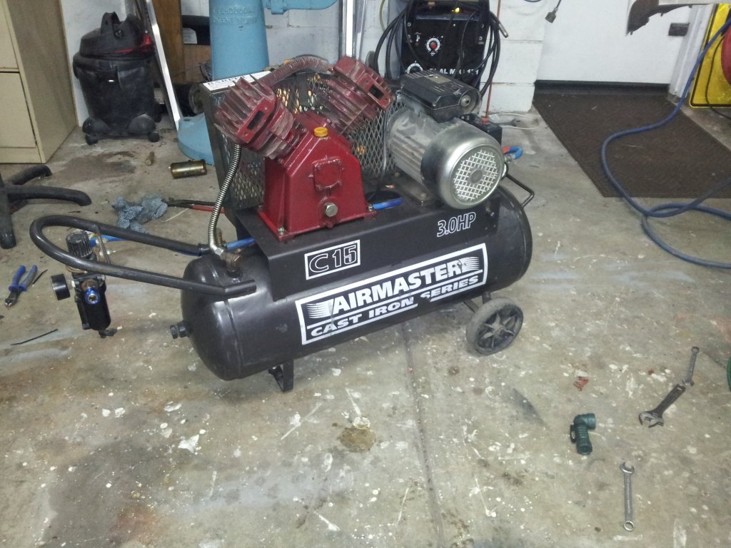

    about a week later i went to a closing down sale of an engineering factory and picked up a heap of awesome stuff for really cheap. bout another compressor for $100 its a single phase 3hp 15cfm twin pump 50ltr. th bloke said it wan't working very well and didn't turn off due to a faulty pressure switch.
    got it home cleaned it up adjusted the pressure switch and replaced a gasket in the pump and it was running like a dream! $500 saving on that one

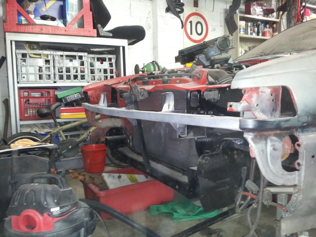

    mkII front apron only had a mkI on the car when i bought it

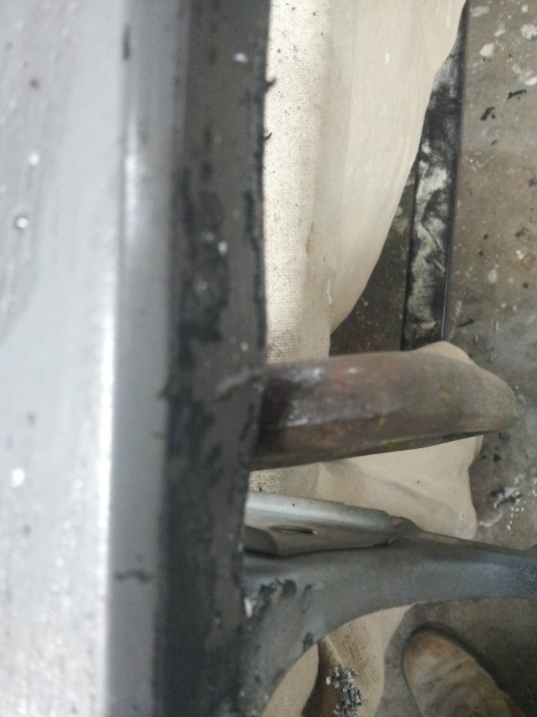

    i started work on the panel below the grille yesterday. as with just about every one i've ever seen it had some damage on it. maybe its because they are really fragile...? who knows. on face value it looked to be in excellent condition so i just thought i's sand it and be done with it. but as i began to sand away just like the bonnet underneath there was some previous repairs and some bog. so out came the stripper and it was back to bare metal again. under the bog on one side i found rust. so out came the welder. now some dickhead left the argon gas on last time he used his welder so it was all gone! a whole ****ing tank! so trying to repair a small rust spot was made really difficult with having to build up chunks of shitty welds to give me enough material to work with.
    but in the end it worked well enough.
    i had to use the same method on another spot. it was really thin so a trick i learned was to clamp a piece of aluminium to the underside of the sheet metal to act as a heat sink to stop from blowing holes from excess heat. works well
    next was the kinks in the side from the piece being bent then bent back to shape. so u get a stretched edge. to fix this i got out my map gas torch and heated the area till it was cherry red then taped it flat with a dolly underneath. then heated it again and cooled it rapidly with a wet rag to make the metal shrink back again. im really getting the hang of the panel beating
