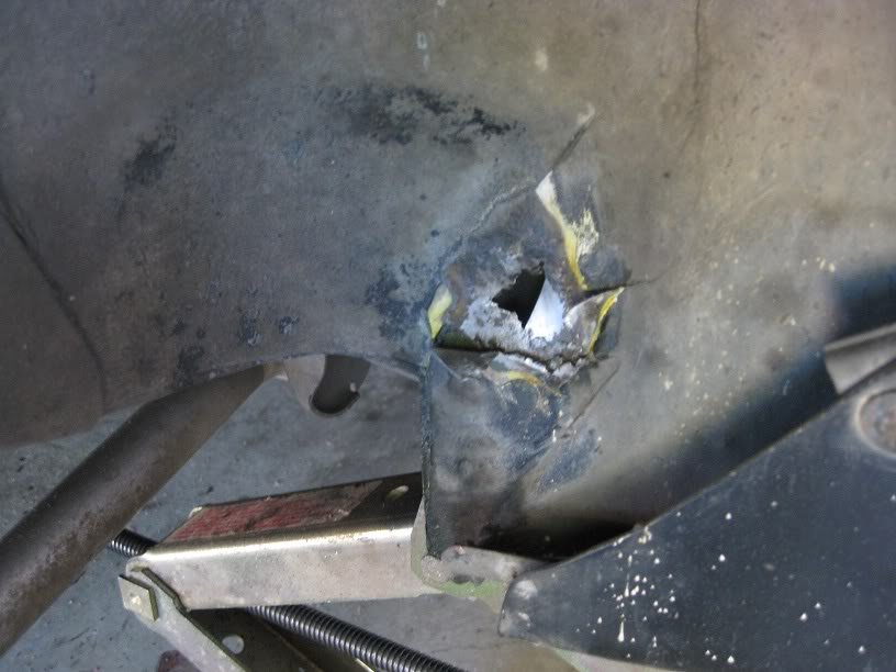

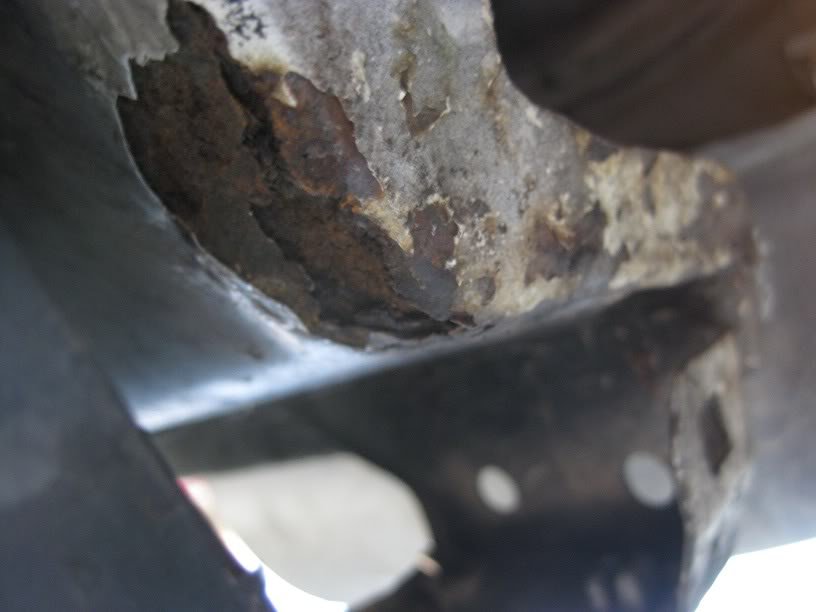

    Veteran timbo's Avatar
    Tim?
    Wild West
    2,145
    Opinions on these spots please:
    Veteran haveaparty's Avatar
    Mar 2010
    Brett
    Crestmead
    1,159
    There not to bad timbo. Bit off plate and she'll be good as new haha.
