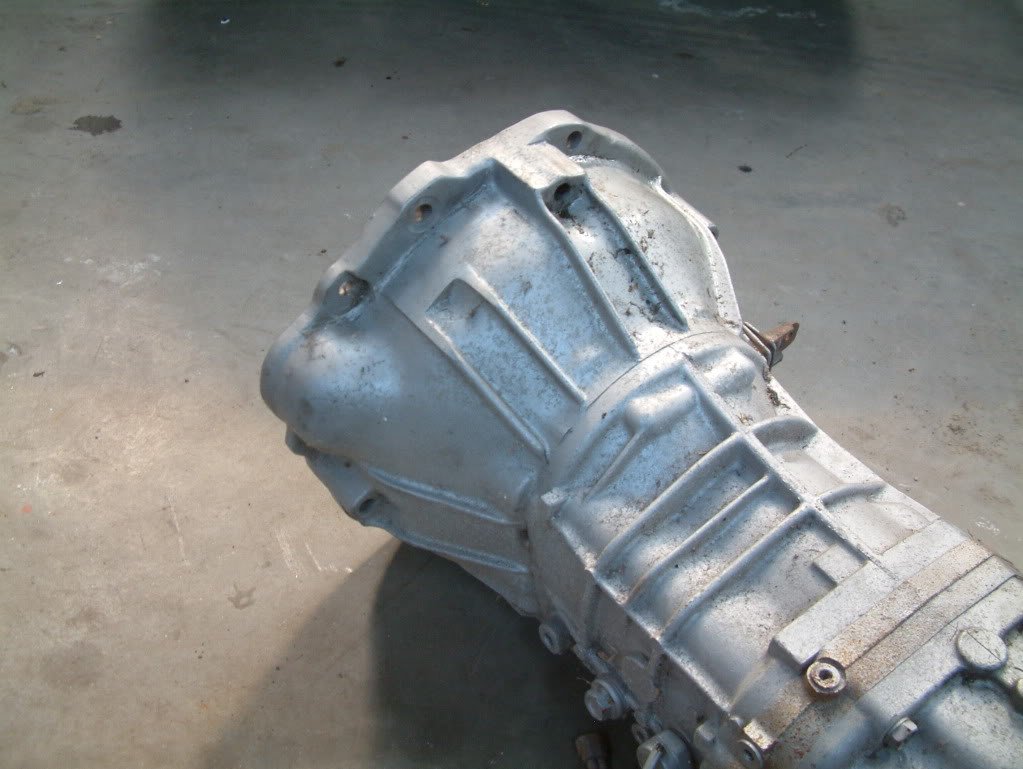

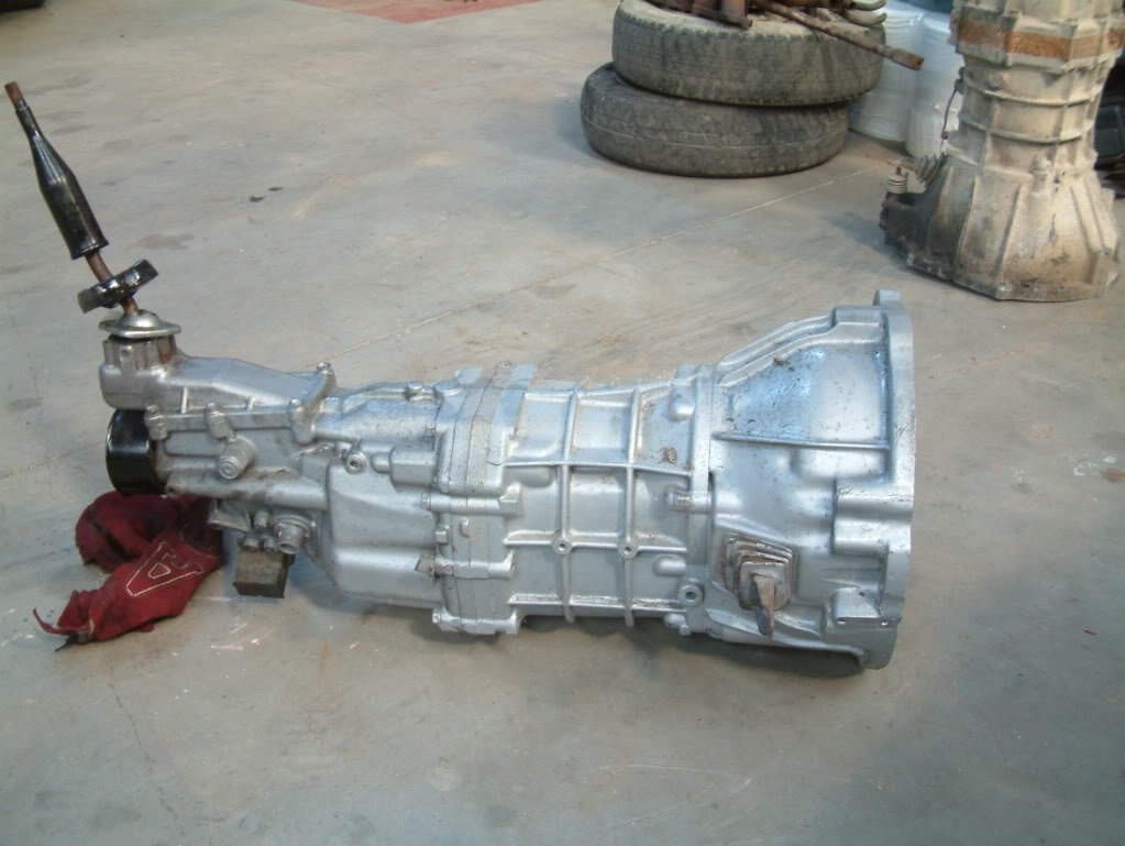

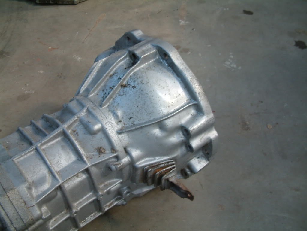

Car - Charmant
motor / part in question - W series gearbox
problem - Identification

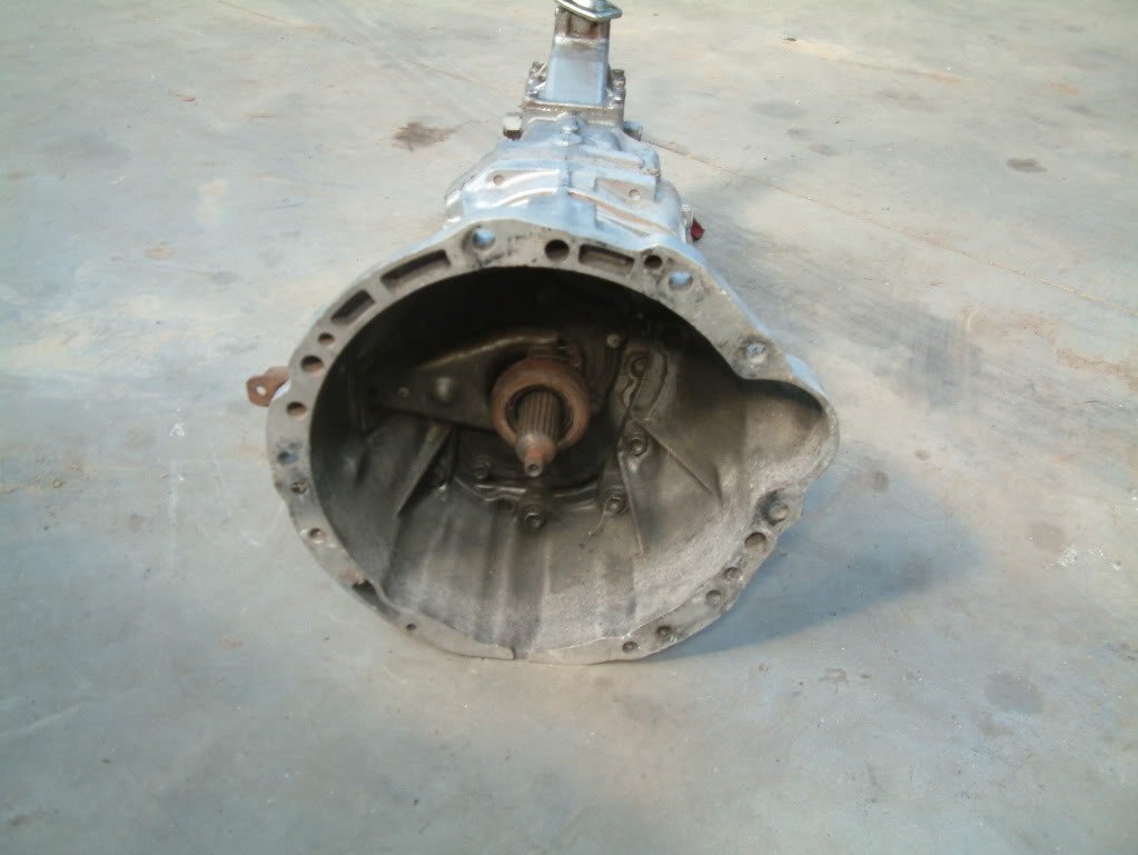

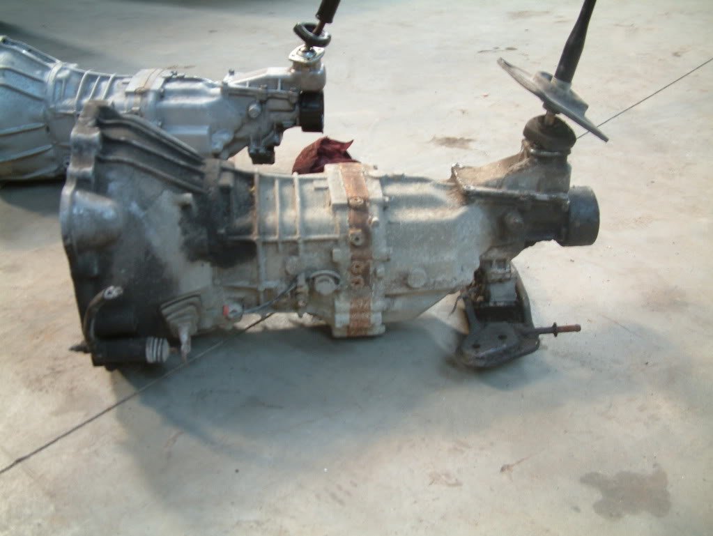

Bought a W5# and adaptor yesterday and looking to id the gearbox and adaptor bell as I need to get a mounting for this and curious about the bell.
Think the rear of bell to shifter was 21" but forgot to write it down but was told it was a W58 and the center piece is steel

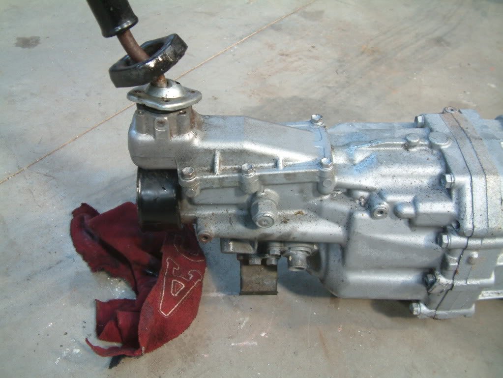

I also got this W5# from a CE70 which has a 19" shifter position is it much of a job to replace shifter setups?
This also needs a mounting.
Thanks for any help.
FWIW, the adapter is a modified K motor van one from Malaysia. First box could be RA60, second SA63 but really a few possibilities. The trans mount is pretty much universal so no problem there. Any kelpro book can help.
Thanks. Is it just the NA jza80 W58 that has a different bolt pattern for the mounting, as I fell into that trap before so want to get the right one this time.
No Kelpro here in Ireland unfortunately and cars OE with w5# are scarce enough here.
yeah any W shifters are interchangeable (apart from the "remote" ones like you said). You have to change the top 6 bolt plate and the selector seat as a set, which requires taking the extension housing off.
12371‑34030 is a genuine number that will work. You guys seem to get genuine parts for next to nothing over there anyway![]()

The box from behind the C engine is most likely to be a W56:
The same as a W55 with shorter first and second to suit the diesel.
