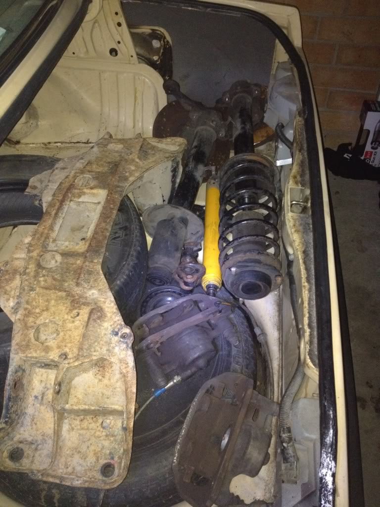

    So tonight I went and purchased some gear for my suspension conversion.
    Parts include:
    2 x AE86 Sprinter Struts
    2 x AE86 Koni Shocks
    2 x AE86 Calipers
    2 x AE86 ventilated rotors.
    2 x AE86 power steering arms (For more lock)
    2 x AE86 Castor Rods
    2 x braided brake lines.
    In addition to the suspension, I also picked up
    1 x AE71 Crossmember (Needed to bolt 4AGE into car)
    2 x TRD Engine Mounts
    1 x T50 5 speed manual crossmember.
    1 x rear half of AE71 Tailshaft (Needed to bolt tailshaft to T series rear end.
    Basically, suspension wise, I just need to get the front shocks rebuilt ($80 for both), buy some HD front and rear springs or convert AE86 struts to coilovers for $250). Then I need to wait for my Koni Adjustable rear shocks, and AU falcon springs, Also need to find a T18 rear factory swaybar (18mm standard) and then an AE86 front swaybar (Probs 22mm).
    Going to send the Konis away this week for rebuilding, and also going to get a caliper rebuild kit for the brakes, and purchase some new brake pads. Will prob paint the calipers black. Need to strip down the front struts, and sand/paint, and also send the crossmember off to the sandblasters and then for paint.

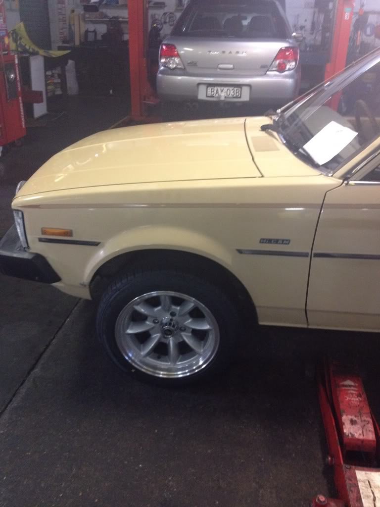

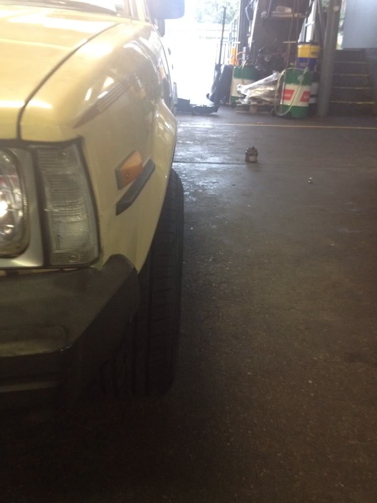

    Also, test fitted some 15x8 +0 on the car, that have 205/55/15. Definitely not enough stretch, however with some 185/55/15 or 195/55/15, it will look sweet. Definitely will be needing to roll the guards, possibly even flare them a bit more, and run about 4 degrees of neg camber on the front to make them streetable.

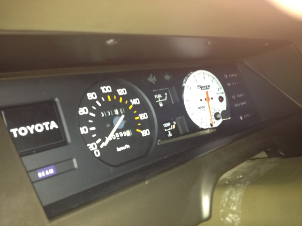

    I had a 3.25 inch speco RPM tacho, with an internal shift light that I got years back, so I dismantled the housing on the tacho, took the internals out and put them into the dash where the clock was. I accidentally broke the plastic that goes over the front of the cluster, but it was a shitty green color so I'll just the broken one down to a Perspex place ad get them to bang up a new one. It's basically just flat plastic.
    The tacho itself is sitting on a bit of an angle, so I'll need to fix that, but it's 10:21pm and I cbf fixing tonight.

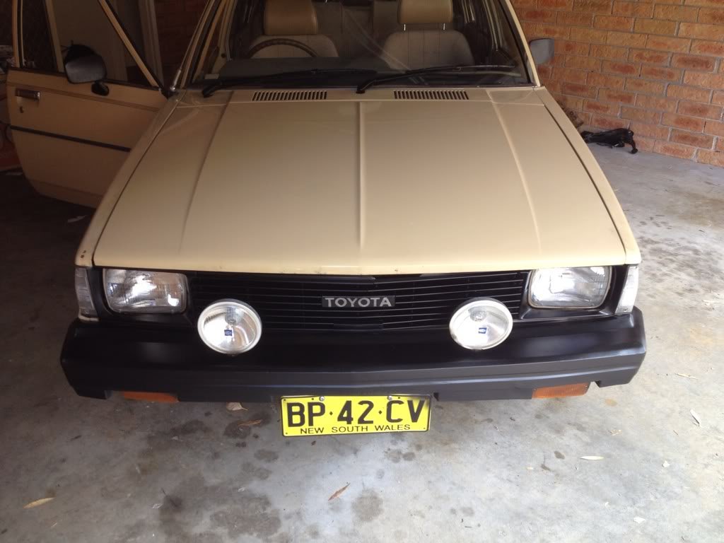

    First, I done the service. Stupidly easy to access these motors. 4 spark plugs up the top, and the oil filter right next to it.

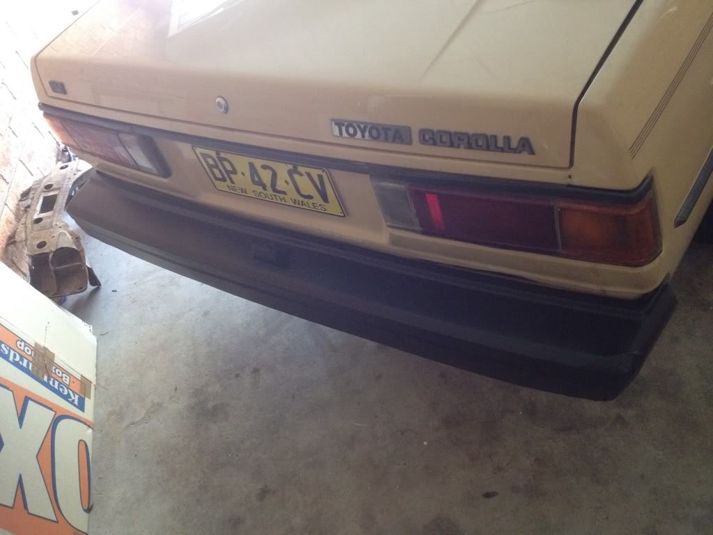

    Once the oil change and spark plugs were done, I quickly swapped the air filter over, and begun dismantling the car. I pulled of the rear bar as it had a ding in it, and was all faded, so i used the heatgun to pop the ding out, and then used a window tinting knife to cut small bits of flaking plastic off. Then took it outside and resprayed it.
    The front bar I sprayed in place as it didn't need any "panelbeating" so I painted that, as well as the grill, wiper blades. rear plastic on C pillar and the headlight surrounds. Looks so much better now IMO. Also hooked up the speco gauge, and it works a treat.
    Pics:
    Little bit more cleaning and shit this morning.

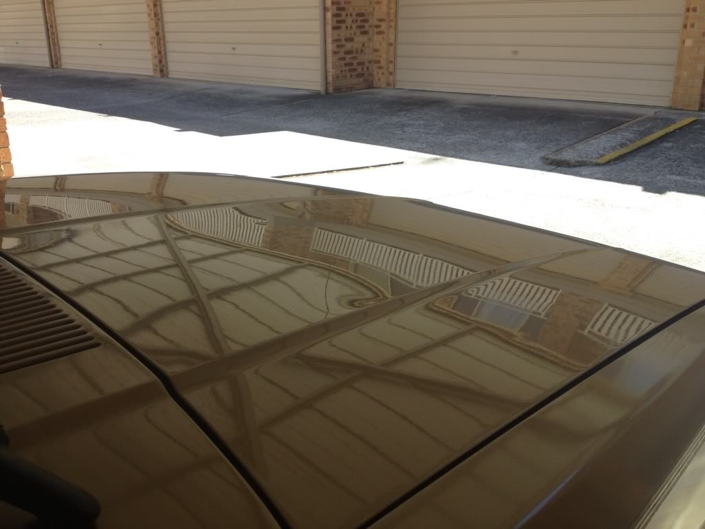

    I attacked my AE86 steering arms with a bit of course sandpaper and a fresh coat of VHT Heat Proof Gloss Black. Claybarred the roof bonnet and boot. Then polished it with my orbital buff. Came out okayyyyyy, but I think its going to need a respray down the track. The paint has just seen 30 years of abuse so its almost beyond repair. Initial color thought is a deep vibrant silver, with a satin black bonnet and black fender mirrors.
    Also razor bladed the wfront and back windscreens, then buffed the glass. Came out schmick. Few chips and stuff in the glass, but overall okay. Still has original glass in the windshield as there is a australian standards date sticker adhered under the glass.

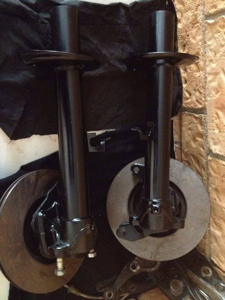

    Few more little bits and pieces today.
    Flushed the cooling system yesterday. What looked like a caramal latte poured out of my radiator. Gave the radiator a huge high pressure flush, along with the motor. Filled it up with clean water, ran the car, dumped it again, and then filled up with coolant. Temp stays generally around 1/4 and 1/2 now. Replaced thermostat, wire brushed thermostat housing, new radiator cap, etc.
    Wired in the front spotlights to find that one of them is blown. Luckily, you can pull it apart and replace the bulb with another, so I'll duck down next week and grab another.

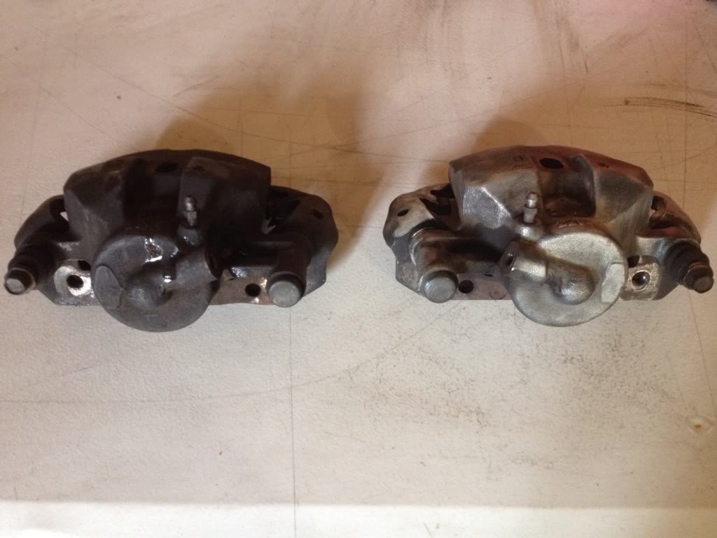

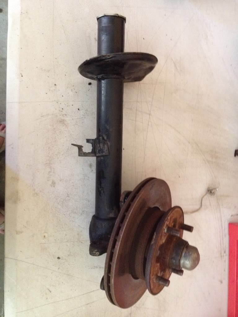

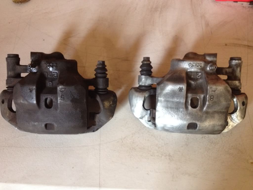

    Also started to refurbish all the second hand parts I got. They were filthy after almost 30years worth of grease and oil and crud. Gave the struts a clean, a wirse brush then a sand, followed by lick of black, and the steering arms a nice silver. Going to paint the brake calipers silver too.
    Pics:
    Before:
    After:
    Wire wheeled halfway on the right.
    Also replaced all the bolts with new bolts.
    Cheers,
    Shazza
