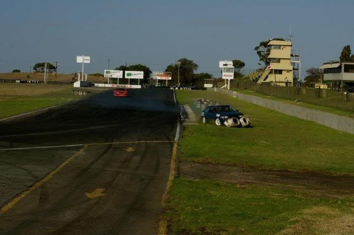

    So yesterday i had a bit of a meeting with some tyres at turn 1,
    Came in for a bit of a flick into turn 1
    After the the car stopped, there was absolutely no steering input, the boss kit was slipping on the steering shaft.
    Im not 100% sure but the car really didn't feel nice once i gave it the first flick.
    Im guessing the nut came loose, and that caused obvious loss of control.
    Once we had a look over everything else, and fixed up the bosskit (with a bit of coke can) went out again in the later sessions.
    Damage really wasnt too bad. both sidelights, grill, lower lip, bumper bracket. bent both guards (bent back ok) and bent all my cooling panels.
    Im booking the car in for a full cage over the next few weeks.

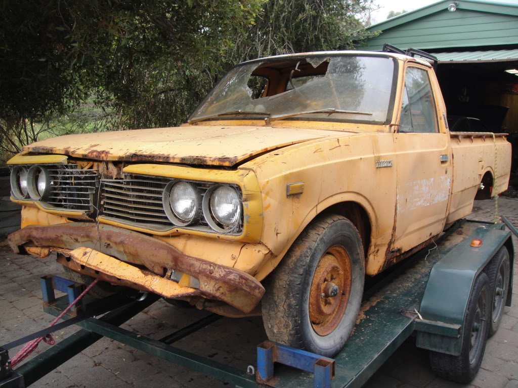

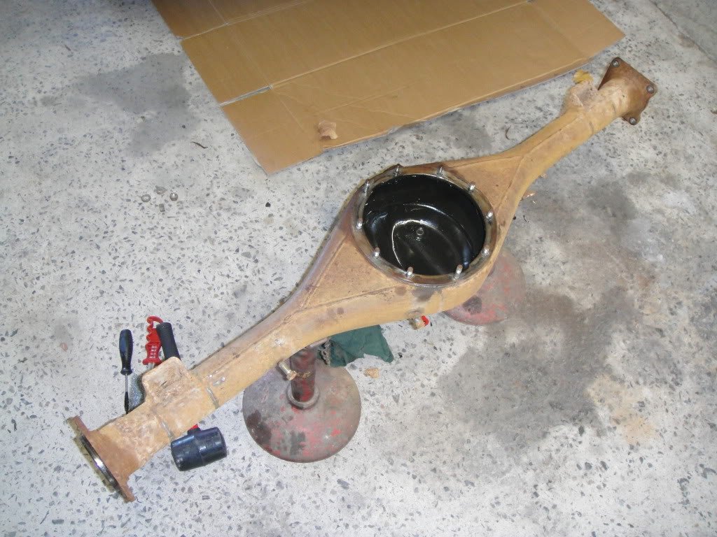

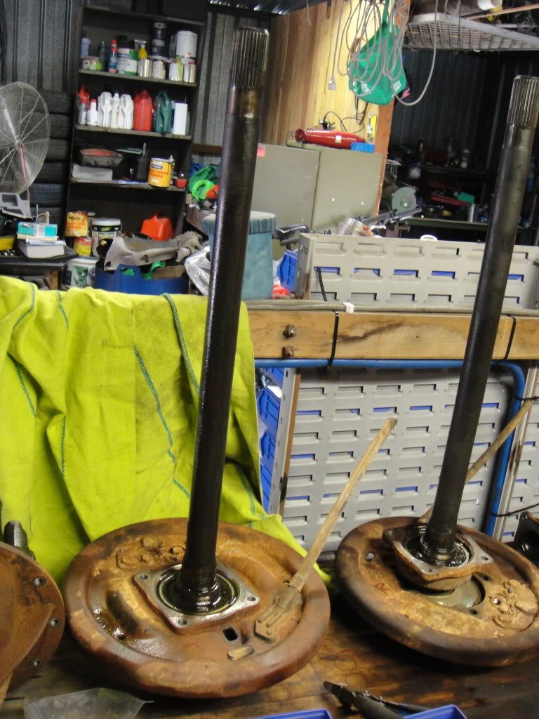

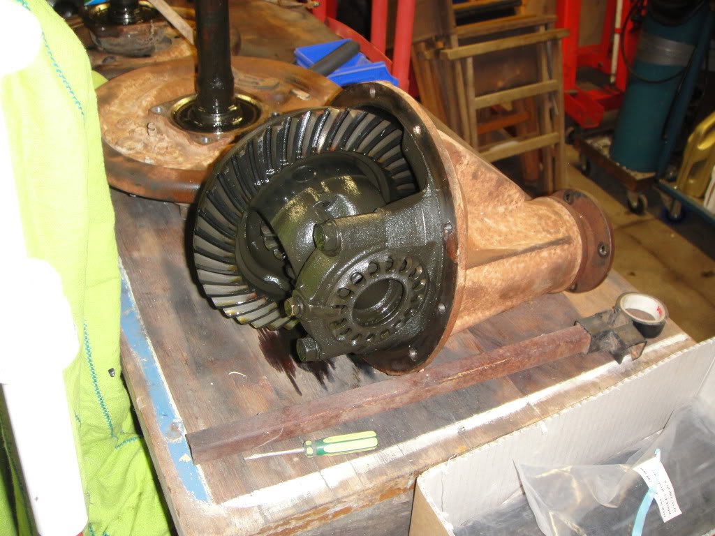

    So as some of the people on this forum would know, finding a RN25 diff is getting pretty hard now.
    People selling them usually know what they are and they know what they are worth.
    The RN25 diffs have a 8" crown wheel and they are about 50mm shorter than the stock diffs.
    I found mine in the most random place, Mallala Motorsport Park.
    I was down there watching some time attack with a few mates, we went for a walk around the outside of the track.
    During our walk we walked near it, i seen an old hilux and had a quick look. I got in contact with Clem, (the owner of Mallala) and made him a offer for the whole car.
    Anyway, here are some pics of it.
    I also made some money back on the shell when i took it to scrap.
    I have converted the diff back to 4 stud, and welded all the diff mounts on. (using a jigg)
    The only work left on the diff is the brakes, and they are nearly done. im using mx73 disks with r32 gtr calipers.
