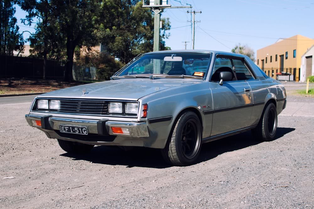

    '81 Mitsubishi Scorpion.
    Engine: Rebuilt JDM 2.0L G52B, balanced everything, No.3 works copy cam, beehive valve springs, head shaved 1mm and ported, standard 2.6 carb+manifold, unknown 4-2-1 extractors, 18" hotdog, 2" back to a standard rear muffler
    Drivetrain: GE Scorpion short KM132, Daikin HD clutch, 4.667:1 diff gears
    Suspension: Chopped Falcon springs, Monroe shocks (Chrysler Centura, front), GE/GH Scorpion Lovells Low springs, Monroe shocks (rear), red poly bushes (because red goes faster )
    Brakes: Stock, new Repco pads
    Wheels: 14x6 +17 (f), 14x7 +0 ®, 185/65 tyres
    Interior: Momo dished tiller/HKB bosskit, Panasonic head deck, 6" Sony speakers
    Body Work: GE/GH guards/beaver panel/bonnet/indicators
    Estimated Power: I dunno. Allowing for intake restriction and drivetrain losses, maybe 100rwhp? Feels similar to a bigport KE70, has heaps more torque though.

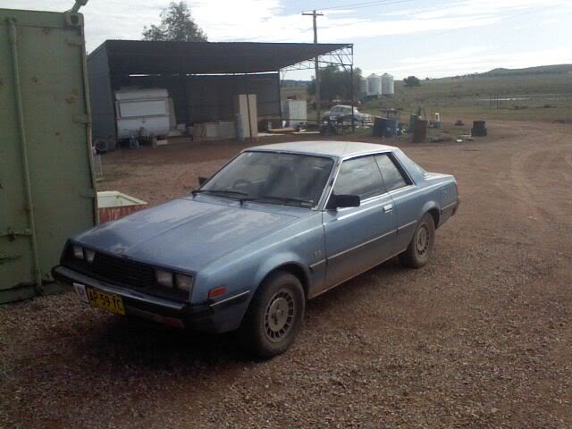

    The day I bought it:
    A couple days after I got it on the road the first time:

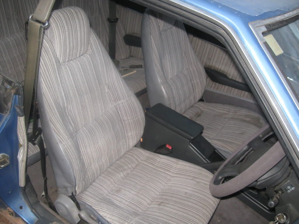

    Interior:

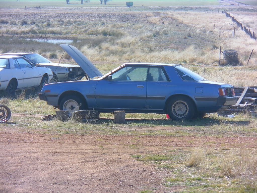

    After it exploded the first time:
    Due to this:
    Back driveable:
    That lasted about a month, then there was the second engine explosion:

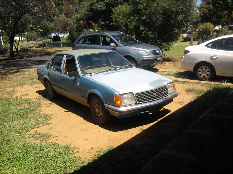

    And, finally, the POS Bombadore I'm stuck driving around in. At least it's reliable, I guess.
