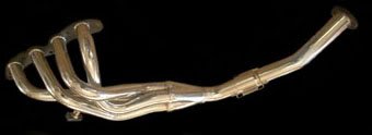

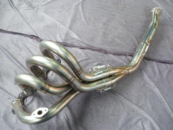

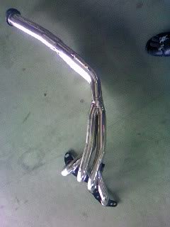

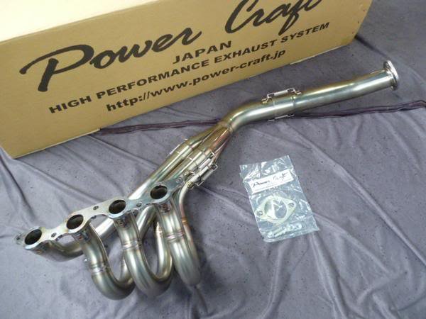

    POWER CRAFT
    ANOTHER SET OF POWER CRAFT
    REINHARD
    5ZIGEN
    NO IDEA. YAHOO JP SPECIAL?
    NO IDEA... ANOTHER YAHOO JP SPECIAL ?

    McLevin:
    the ones i posted are in my price range, apart from the 5zigen and the reinhard which are slightly more.
    i considered going to an exhaust place but i haven't really found a place i trust and all the places i have spoken to, tend to put this in the "too hard" basket.
    Ok so your suggestion would be with the 4-1. which means the run free or the powercraft
    question:
    the reinhards are 4-2-1 but the secondaries are very short. any idea on this design type?

    According to Toda their 4-1 design gains 3% in the top end but loses out on a huge 15% in the mid over their 4-2-1. With that in mind even a track car shouldn't fit 4-1 pipes. I know someone that went from fairly well made 4-1s to 4-2-1s and he picked up lots of mid range power. The pipes whern't even that good, the primary lengths where way too short.
    Interestingly enough on the earlier 3sge engines 4-2-1s make more top end power than 4-1s. Goes to show people shouldn't make assumptions. It's just like inlets lengths- unlike the theory a shorter velocity stack on a 4age hurts top end power.

    the first Yahoo JP special, decent length primary and secondary pipes
