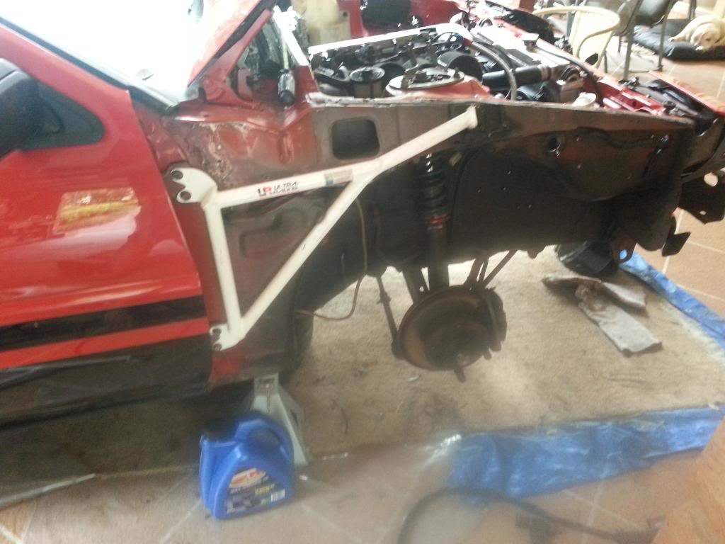

Also added these,

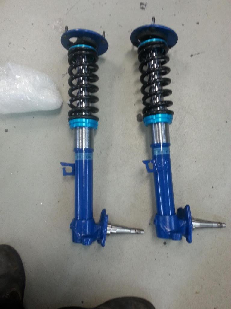

Aaaand a new set of coilovers
These are overhauled N2 circuit, Bilstein coilovers with Cusco cambertops and Cusco 8Kg springs.
Looking good Josh. What spring rate were your old coilovers? You'll have to tell me if the braces make much difference. I've always wondered.

I think they're 8kg. But cant be sure.
The front end feels much tigher and more predictable. But it's hard to say.
Got a wheel alignment at Fulcrum steerers were 18mm toe in. Steers much better now.
i run those braces too, never noticed a difference honestly
I have a mate who used them on his AE92 Levin. He said they make a big difference. It is a WTAC car though.
