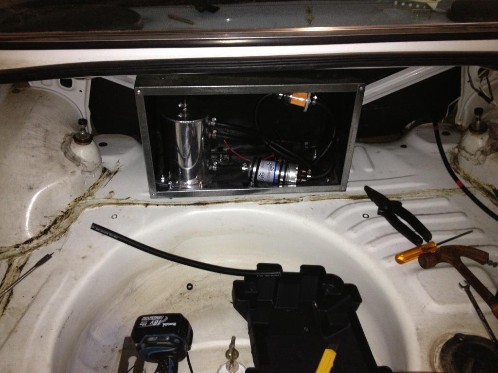

I have also got my fuel system in the boot done, it wasnt as daunting as i first thought it was made simple by a helpful thread here on the forum. i just have to do my clutch master and then the engine can go in and stay in then sort out tailshaft, exhaust, put the 4.3 ratio in my borgy that Casey supplied me and get it adjusted up properly.
A bit messy but it should do the job the toolbox is rubber lined and mounted aswell as the lift pump and fuel pump so it should be quiet im hoping haha.

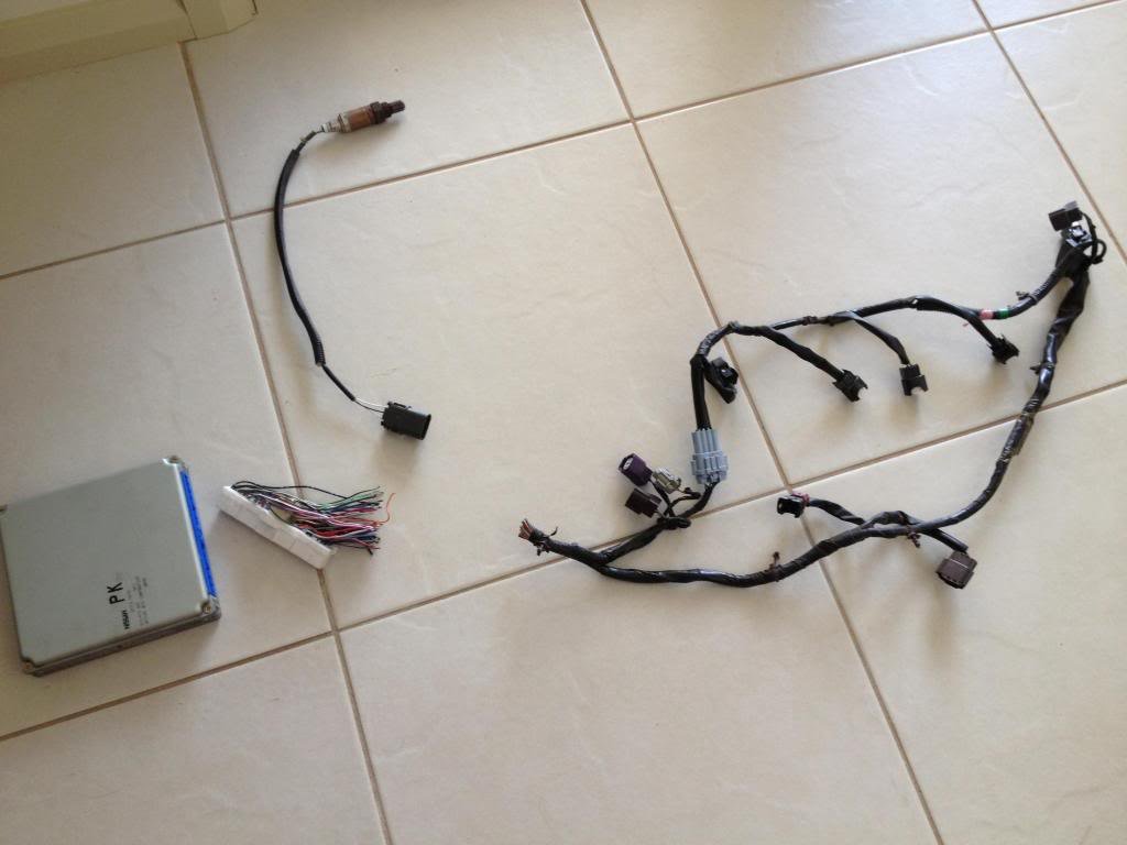

Everything should be done in the next couple of weeks and then the car will be a good looking lump of useless metal until i can get a loom to suit an autech or s15 de motor since the one i got supplied with was cut at the ecu and at the firewall so im missing a metre or more of wiring and have no idea what to do yet.

just to give an idea of what im dealing,there is a fair bit of missing wire. anyone that can offer any advice from previous experience would be appreciated
Instead of the usual Saturday night I decided to stay in and get shit done. I have a loom now so a mate came round and started getting into the wiring and trying to teach me "still does my head in" and we got it to start by about 1am for about 5 seconds, was flippin Loud running off the extractors and I thought I'd show I little consideration for the neighbours (top bloke).
