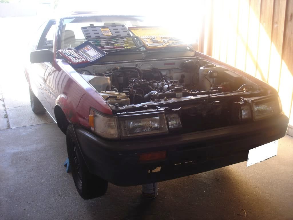

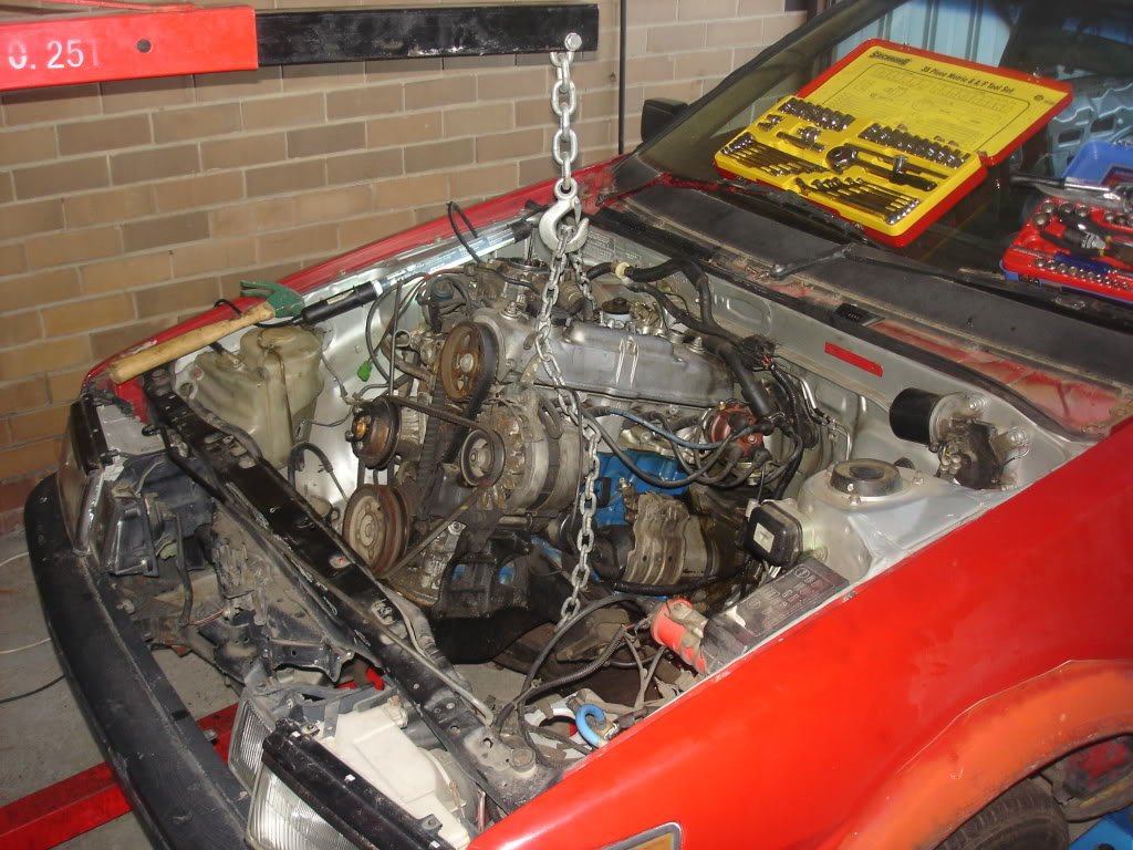

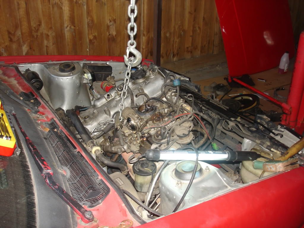

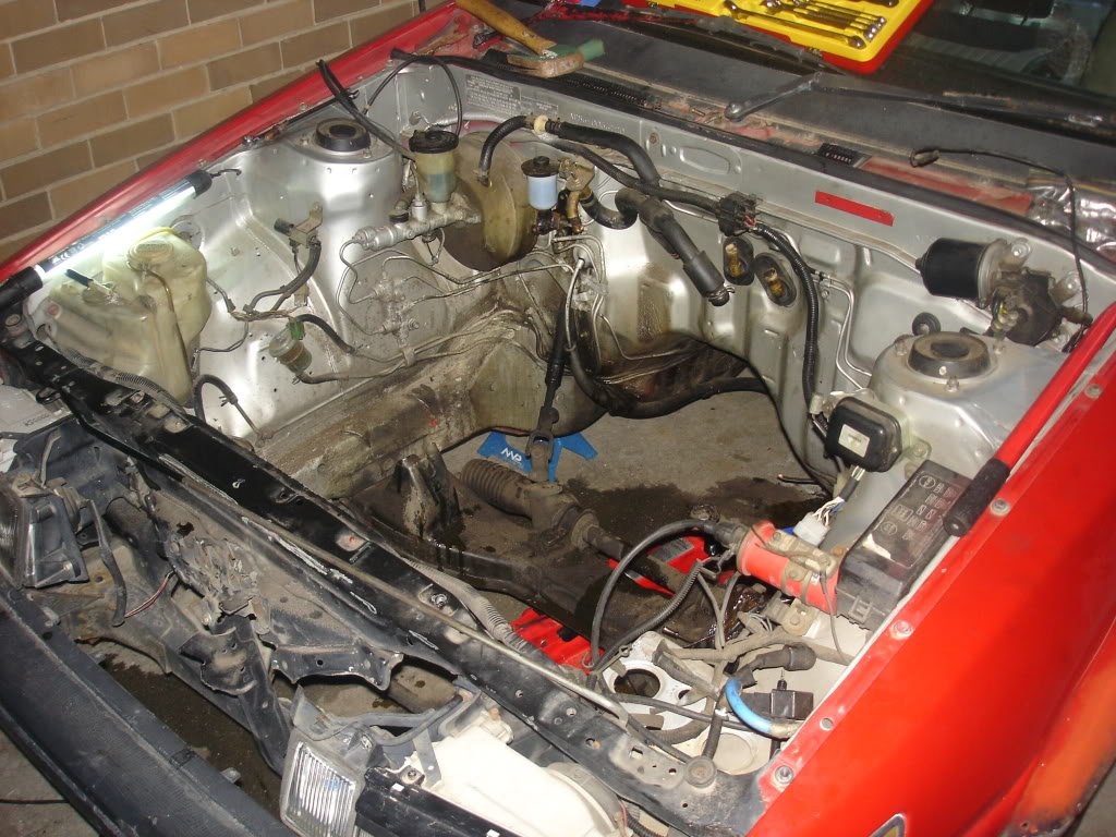

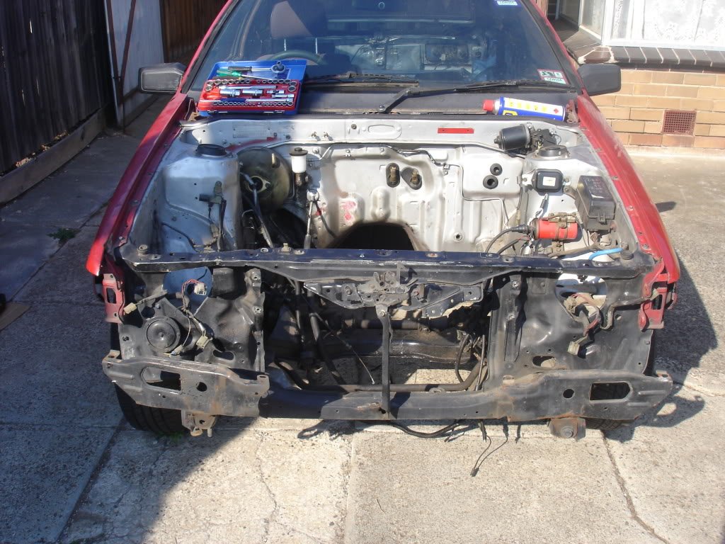

    Well todays objective was to take the t series from the trueno and clean that up ready for the swap with the sprinter but I got carried away.
    I started to take out the rear interior in the sprinter and then I had a brainwave... 'why not take the engine out'
    So yeah I pretty much got straight into it and just redid everything I went through from when I did the trueno and I mowed through it pretty quickly. I started about 1 then I was ready to pry it out by about 5. Took abit longer then expected due to not having access to a lowdown car jack but I pulled through with the goods.
    So from here i thinks its onto the diff/disc conversion and then work out the fuel systems and I should be on the home straight.
    Well onto pics,
    And this is where Im at...
    Cheers
    Luke

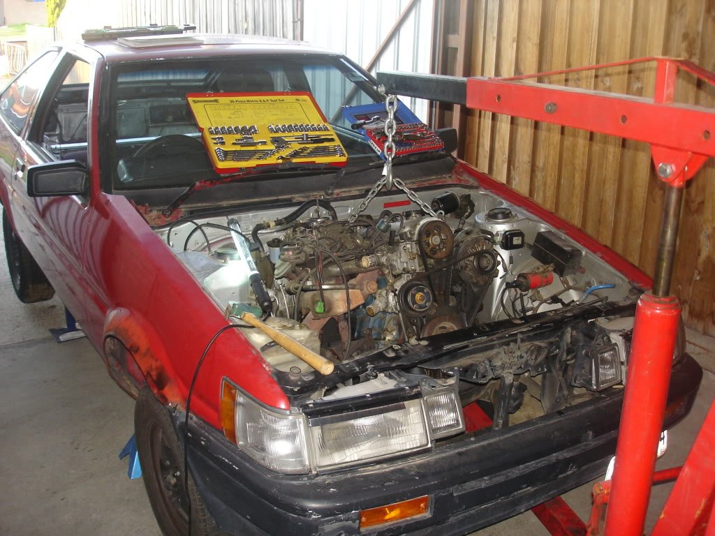

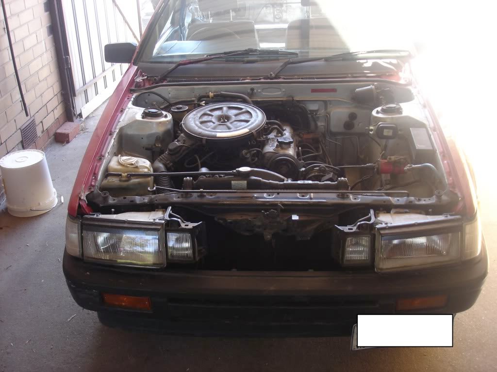

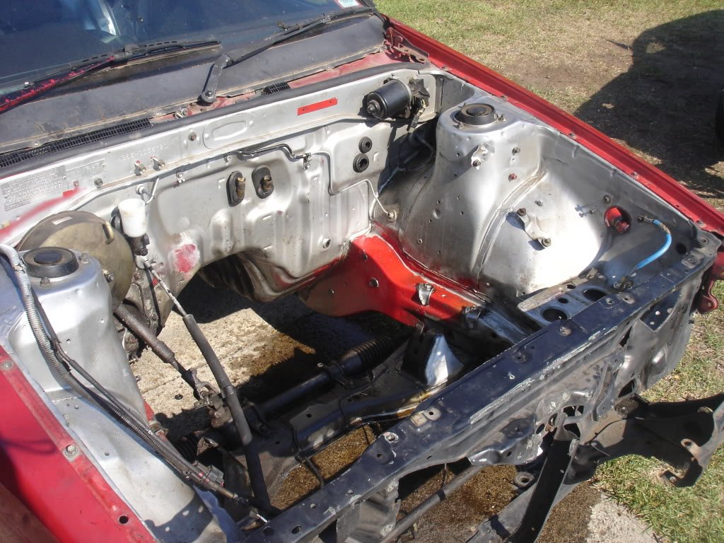

    Well not too much to update besides these shots from the last couple half-days effort. I took out the carby fuel systems and brake lines ready to take out the rear end to be swapped with the 2way and disk brakes all round.
    Can I just say I cant get enough of this wire wheel lol.
    My intentions are to scrub away the silver and maybe give it a quick spray of white so that I can find possible leaks and what not when the new engines in. Im going to drop into Supercheap shortly to pick up some paint thinners/strippers, gloves, masks and other random things.
    Im in need of some bigger ring and open enders as I cant undo the handbrake cables with my pesky 17'' *sigh* The booster is proving to be difficult but I'll get there eventually cbf taking out the dash right now.
    I've got a question also, If I take off the booster is there any gaskets that need to be replaced at all?
    Thanks anyways guys.
    Luke
