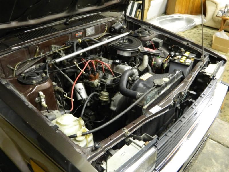

Plans as the title suggests is to get back to where i was around a year ago when some lowlife stole my ride. With a few changes here and there. So once again im going with a CA18DET between the towers.
Started collecting all parts to get this project started.
I picked up a CA18DET and Box with loom ecu etc

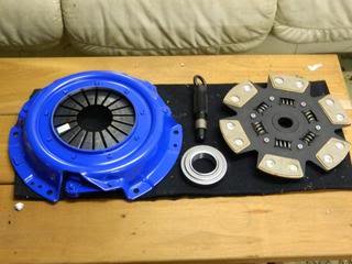

New clutch and Lightned Flywheel

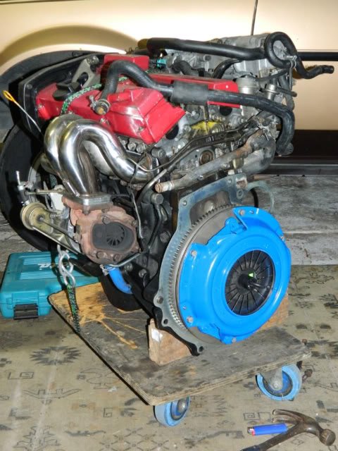

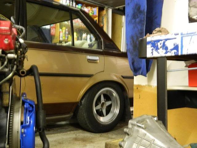

Chucked a new timing belt and tensioners and waterpump on. New thermostat, clutch and flywheel fitted.

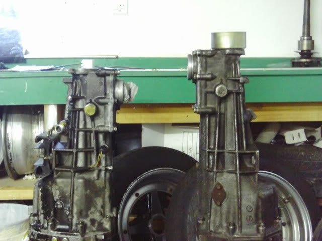

Once again i have put a split my ca gearbox and put the rear half of a skyline r33 gearbox onto it. the main reason i have done this is because the ca box is about 75mm longer then a rb box. in turn makes you have to chop more out of your car and hits handbrake. Plus its stronger and has mechanical speedo.

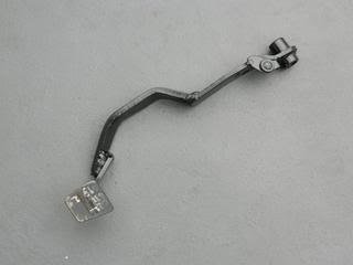

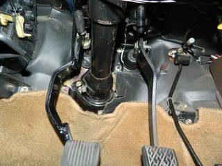

car was almost ready to mount engine. Finished off the TE71 pedal box install. At first i thought sweet its gonna work out. But then NO!
2 problems, steering wheel was out of alignment and clutch pedal hit very bottom of column.

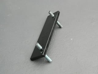

Luckily ive been speaking with a 86fiend and he sent me a link for a spacer. So i went out and brought a tap and die set and came up with this.
And for the clutch pedal i got my stock brake pedal and welded it and chopped clutch pedal to suit. it feels good and in the right position unlike bending it. prety happy

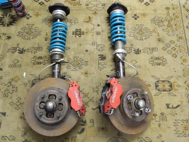

Some adjustable front suspension. They've got Wilwood 4pot calipers and vented disks, ps arms, rosejointed lower arms.
Should give me enough stopping power to get cert, and its still possible to run 14's

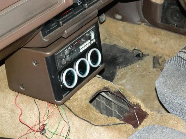

Decided where I wanted all my gauges and mounted ready for when i start wiring up the car.

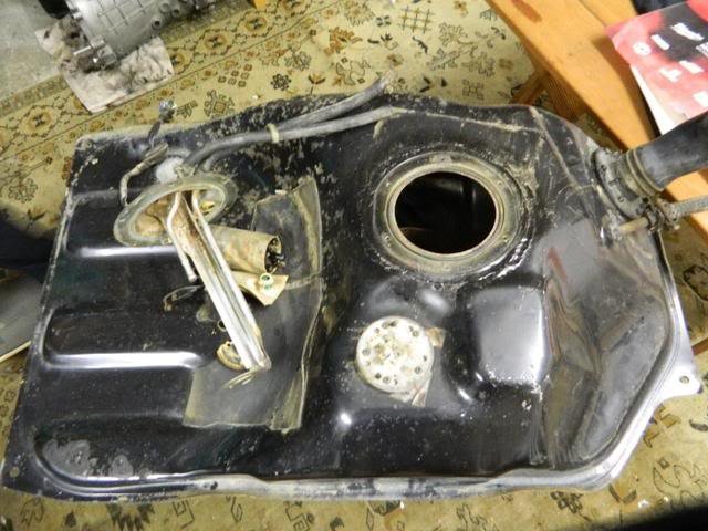

Sorted out the fuel tank for efi. I scavenged a skyline tank with pickup, cut a hole and got it all soldered in the position need. Also modded fuel sender because it hit the new bowl in the bottom, and length as the filter hit the bottom. Just gotta sort out a new pump then bend up some fuel line

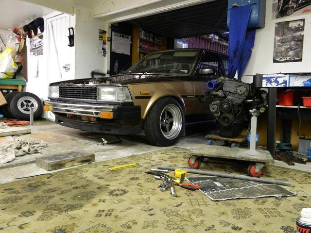

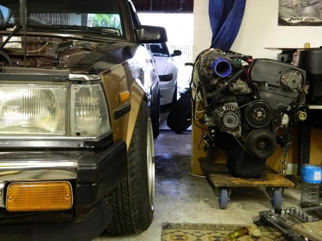

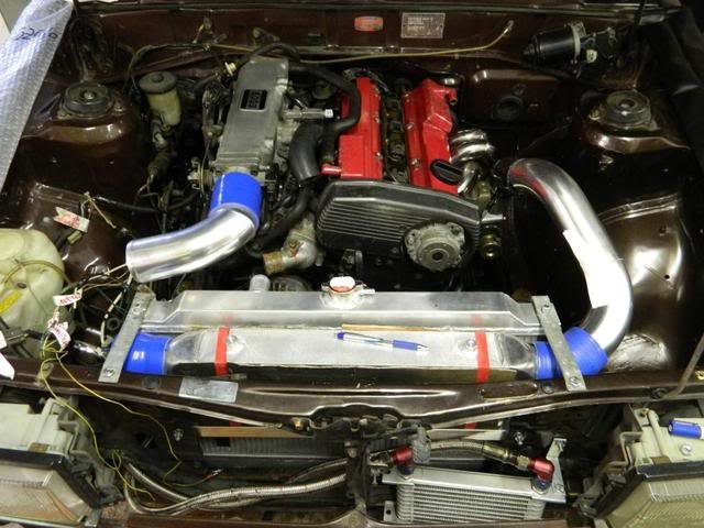

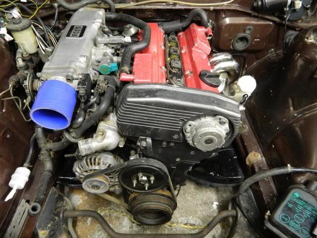

Got the engine mounted, 3inch dump made up and was one step closer to getting this thing on the road without a tow rope or trailer, stoaked
Mounted up intercooler, rad+ electric fan and oil cooler.

Sick build! You make it look so simple... What front lip is that?
Not quite sure when it comes on boost yet, im in the prosess of trying to find how to wire up stock tacho. Seems quick though

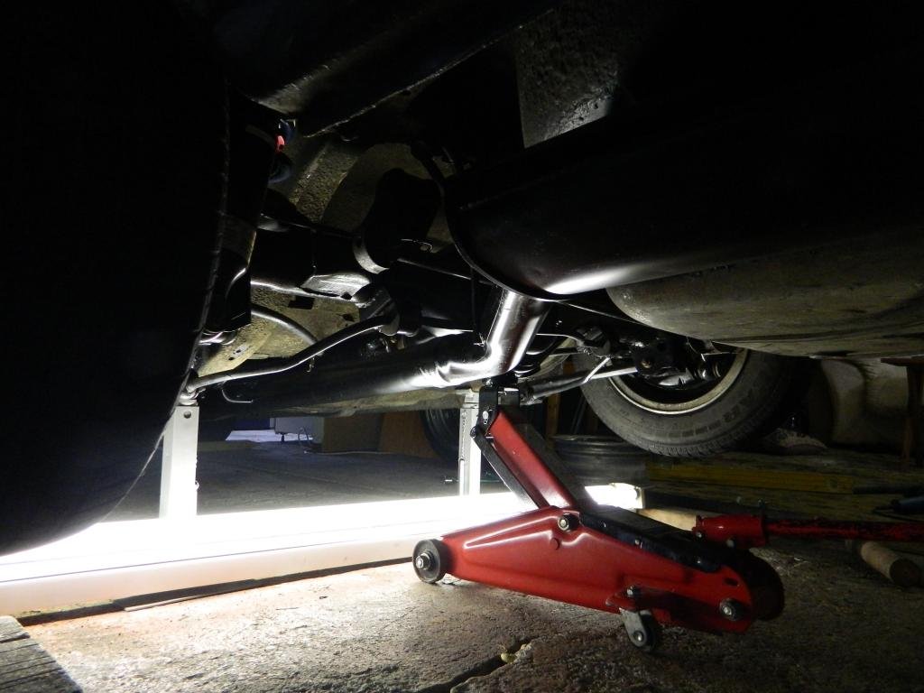

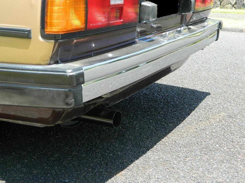

Managed to get new exhaust done before xmas. I went from a 3inch dump to a sml coby then 2.5 the rest of the way to muffler and out.

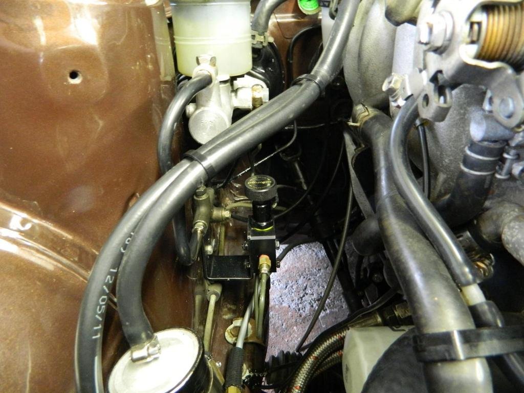

Well my brakes wern't 100% from upgrading to Wilwood setup and AE86 Disc Brake. So I took out stock master and replaced it
with a Mitsi Pajero master which has a bigger 15/16th bore. Also got a Rear Proportioning Valve for adjustment.
It all went pretty smoothly and was a bolt in afair. The few parts i needed was a couple of banjo bolts from a Mazda 626 clutch master and a couple of 323 brake lines. $25 from pik apart.
Also a 1/8th NPT male - 1.0x10mm female adapter for the Prop Valve to the stock line. $30
