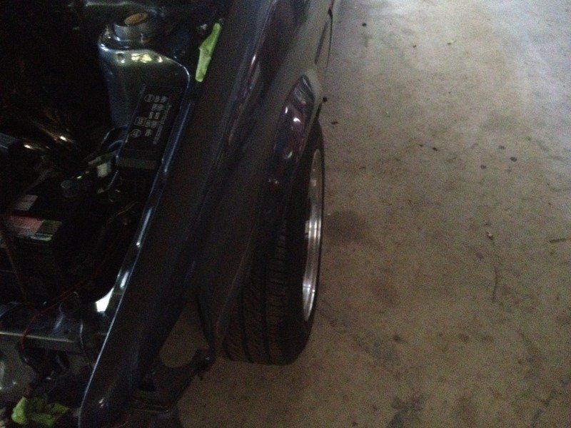

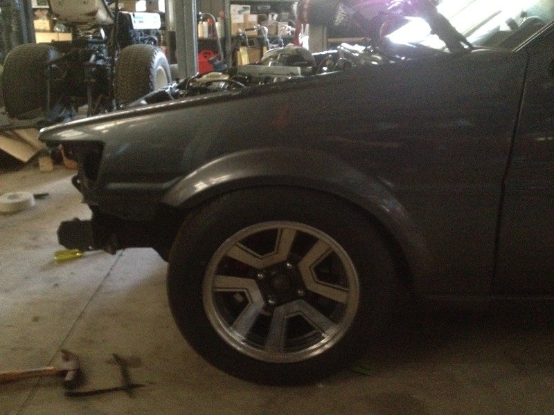

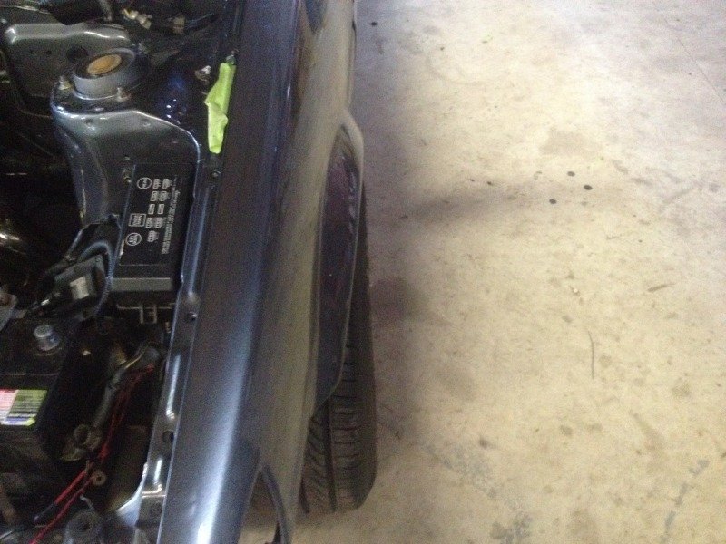

    righto, its only taken me a week to take some but here are some pics
    Any thoughts??

    195/60r14?
    30kw club
    Member _sawyer_'s Avatar
    Paul
    West melbourne
    95
    Ya 195/60/40
