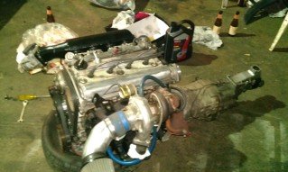

    thought i would put up my current daily,
    Was givin this car when it was stock cause my mate owed me monies,
    Its been through a few different engine/driveline setups since ive had it,
    4ac - t50 - S
    4ac - t50 - T
    4age - t50 - T
    4age - W55 -T
    20v 4AGTE - w55 - T

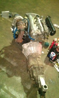

    As it sits now it has the 20v turbo engine with w box and hilux 4.3 diff.
    ENGINE:
    Silvertop 20v
    ACL Forged pistons 9-1
    full balance
    Plenum deleting quads
    Kelway steampipe turbo manifold
    S15 BB T28
    600x300 cooler
    3 inch exhaust
    makes 175rwkw @ 16psi
    DRIVELINE:
    Fidanza alloy Flywheel
    ClutchMasters 4 puk
    W55
    One peice tailshaft
    Hilux 4.3 locked diff
    custom handbrake cables to suit
    SUSPENSION:
    RX7 brakes
    ae86 coilovers 7kg weld on
    kyb excel g shocks
    40mm rcas
    JDI Fabrication Knuckles
    Rack spacer
    rear sierra shocks

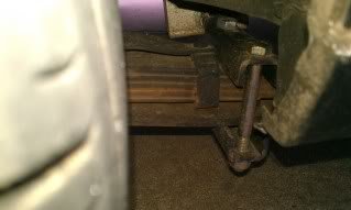

    heavily modded leaves to stop tramp
    INTERIOR:
    MA61 Seats
    Bolt in half cage with side intrusion bars
    Nardi classic
    ae82 twinky dash modified to suit
    bed in the back
    curtains on all rear windows
    2 10 inch subs behind rear seats
    alpine type s speakers throughout
    WHEELS:
    14x7 -2 work equip 03
    14x7.5-10 work equip 03
