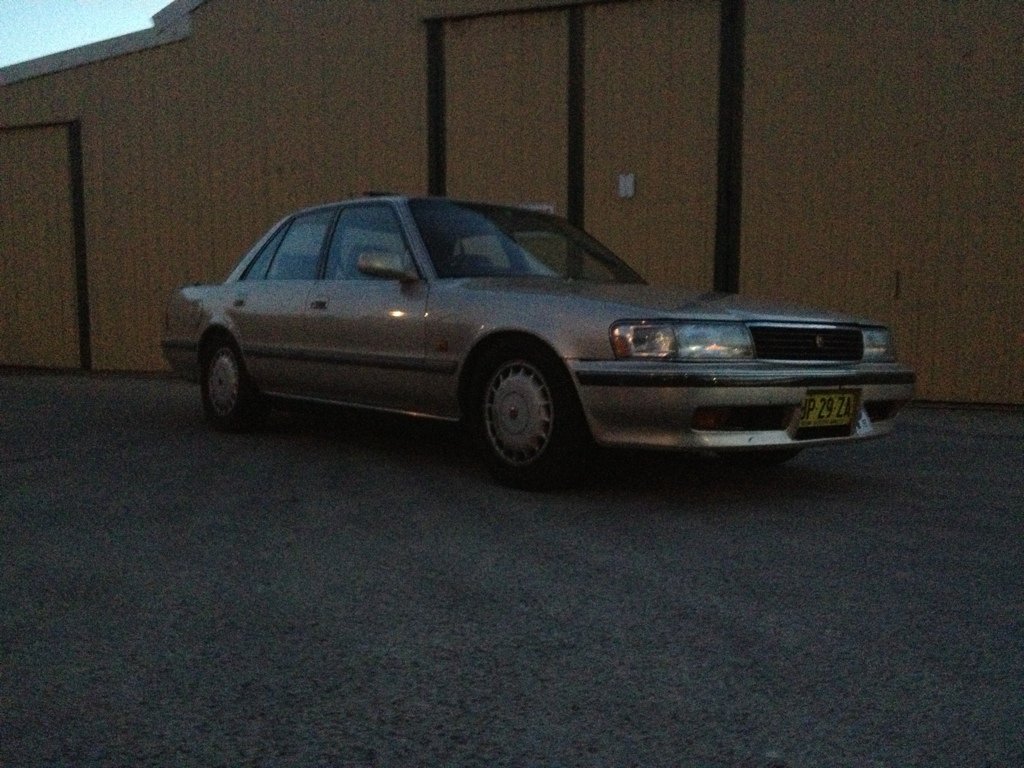

newly purchased
1992 toyota cressida grande genuine 203,000kms
-1JZ-GTE
-600x300x76 black HYBRID fmic with black custom intercooler piping
-2.5" custom mandrel bent catback exhaust/ high flow cat has stock 1JZ dump pipes
-H4 phillips crystal vision 4300k
-2JZ PCV grommet & 2JZ twin turbo PCV valve
-prosport boost gauge
-walbro 255lph fuel pump
-stock twin turbos in good condition with factory wastegate ported 3mm larger
-tinted sunroof
-sony mp3/aux headunit/ 6.5" fusion speakers at the front/ 6x9 JBL speakers at the rear
-front & rear fuji heavy duty brake pads
-heavy duty automatic gearbox with a shift kit
-6 custom high pressure power steering hoses & adapter from steering rack to pump
-custom accelerator cable made up
-alloy radiator
-drift boost controller
-hks fuel cut defender
-10 pounds at 180kw at the wheels
Now running 16.5 psi soon to be dyno'd
plans are crack 350kw
cams
r154
computer
big single turbo
intake maifold
injectors
ect..

bored of 180kw il go take some pics tommoro while think of some mods to do for now
