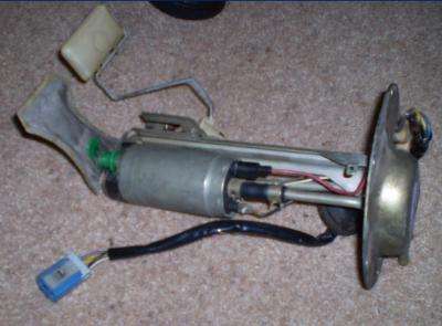

i started my project off by sourcing a nissan silvia s13 fuel sender unit as it had insulated wires and a pump already
(not my photo sourced from nissan silvia.com)
on the bracket opposite the fuel pump drill through the braising on the fuel level sender and bend it around until it comes off. i don't have a pic of this as i didn't think to take one at the time.

these guys were great they measured up the silvia fuel bracket fit perfectly inside the tank they welded in a swirl pot some magnets to pick up any rust particles that might be floating around inside your fuel tank and pressure/leak tested the fuel tank.
Here you can see the completed tank setup
swirl pot inside the fuel tank and silvia bracket installed. *note you can see the drill holes where the sender was removed*
