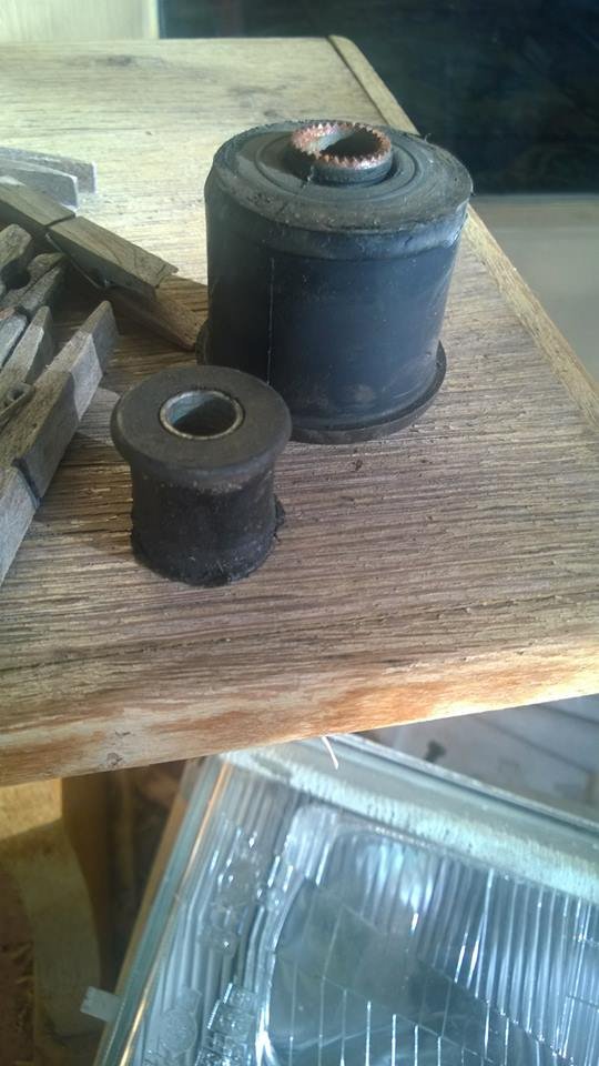

    Got some bushings removed for the powdercoater, are they still useable even though the lips have been broken off? If I can't use them whats a decent midrange option, superpro? Don't want rubbish that will crack in two years..

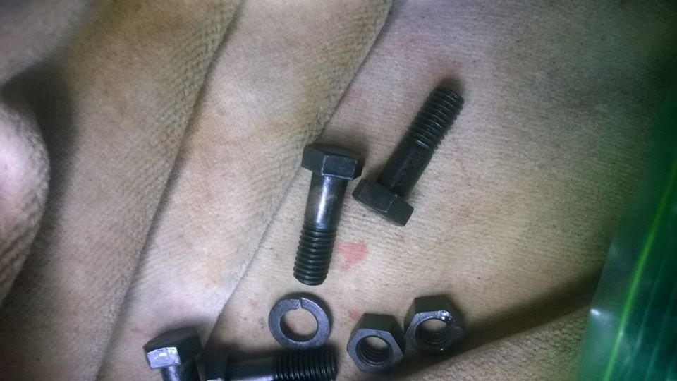

    Also these are what bolts look like after using white vinegar and then soaked in oil. These were driveshaft bolts so were quite rusty etc as you can imagine
