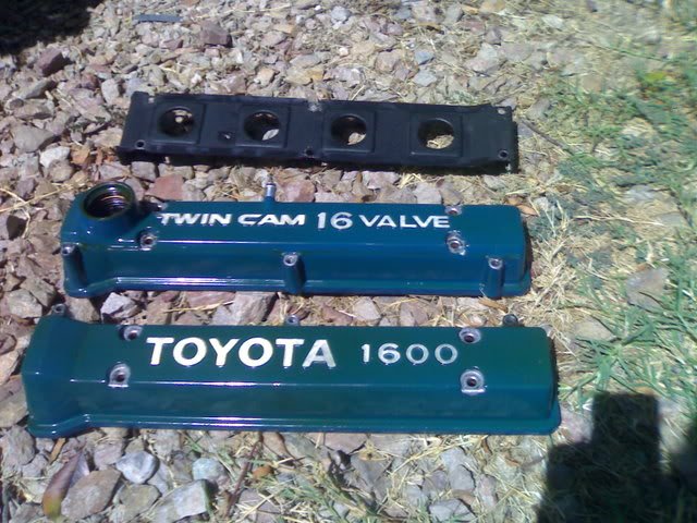

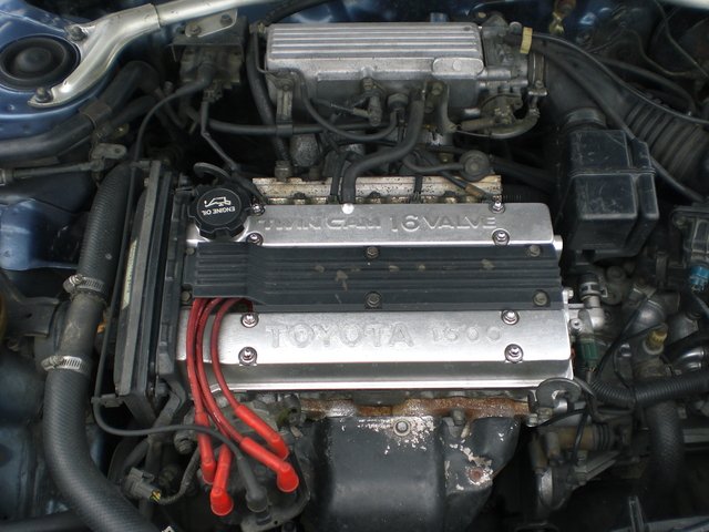

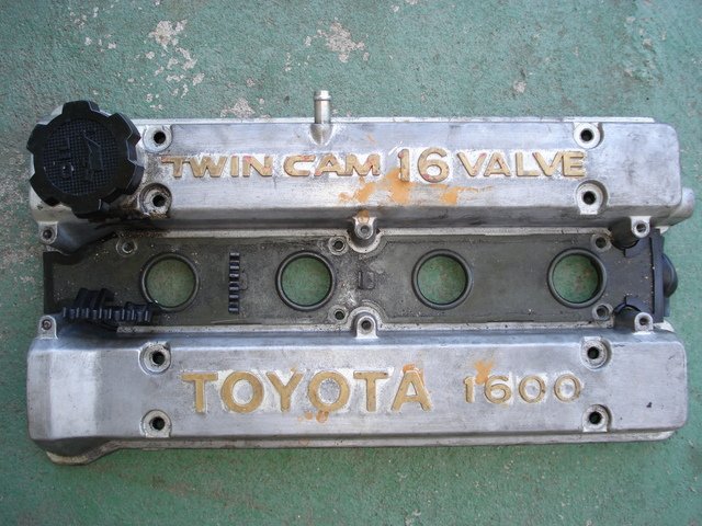

    what is the valley cover
  2. #12
    Aug 2010
    Geoff
    mt dandenong
    2,437
    In between the rocker covers there is a valley. The cover goes there. Leads to suit 4age motors plug into the valley cover to keep debris away from the spark plug holes etc
  3. #13
    Elite rthy's Avatar
    Leo
    Tulla
    7,308
    biport just 1 piece with a rubber seal n shit
    the leads sit on top
    smallport sits half way and has some rubber seals
    then this cover on top
    looks like this at the end, leads are semi hidden for that newage plastic cover look
