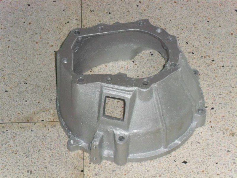

    I know this topic has been covered before.. Just like some other thoughts on this product
    This guy in the states --> has been in the process of updating his design of the 4age to w5x bellhousing, photos of the old one is on his webpage. He has got back to me today with the updated product, here are some pics..
    Theses cost $435 AUD including shipping to aus. At the moment the niteparts bell is $625 AUD delivered..
    can anyone see any problems with this product??
    Cheers

    well it's a rough casting but it's machined where it counts so that's not very relevant. Other than that it has bracing where it's needed and the slave on the intake which is nice.
    Have people given reports back on the use of his earlier one?
    Group buy?

    I haven't heard of any feedback on his earlier one, I know people have used them tho..
    I will be ordering one today.. I can hold off a little bit to see if he will do a group buy..
    would anyone like to put their name on one...?

    I have used one of these bells, and it works. Bit like dellow ones as well, they work

    Will it fit a gze clutch in it?
    Or do they all have clearance issues?
    Senior Member Mirko's Avatar
    Mar 2013
    Mirko
    792
    Would think it would as they say it does fit 16v smallport motors but worth checking just in case as l have one as well and am interested in this incase my t50 goes boom

    Yes.. It says on his webpage..
    "It can also be used in 4A-GZE big flywheel with a minor modification."

    I have got one of the early ones and it is fine. No issues and it was cheap when i bought it around $350.
