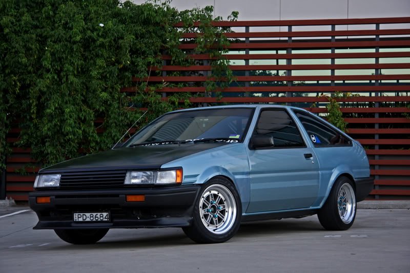

new photos will be up shortly![]()
ROYAL GARAGE NEWCASTLE

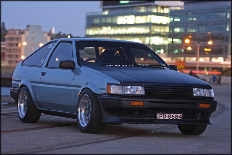

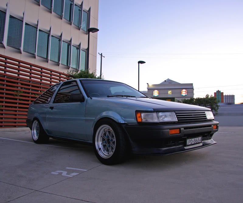

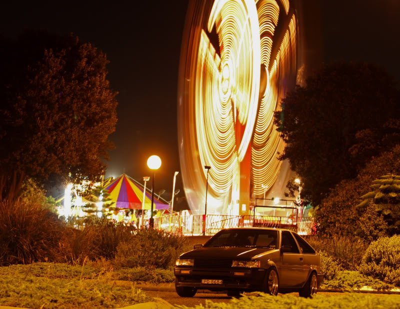

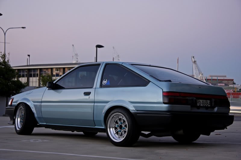

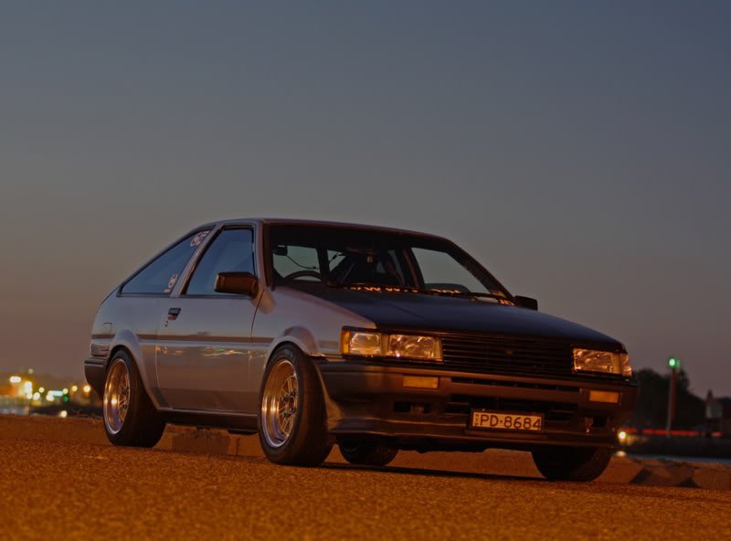

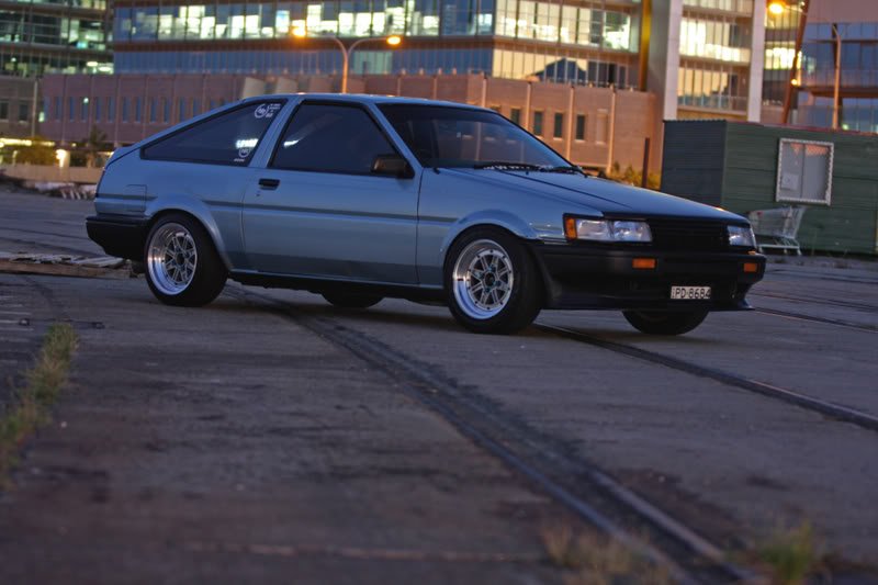

well guys here some new shots from last night of the old girl
the one with the carnival is by far my favorite
leave ur kind comments guys![]()
I like this car a lot hey... its so well rounded.. pics look choice as 2..
BENT MECHANIX - Garage 20:
cheers mate,its taken years to get this far.more pics to come
looks sweet, where abouts in Newcastle are you? i can see that you've been to Bar beach for a pic. might have to go for a cruse with you when my 86 is running.
