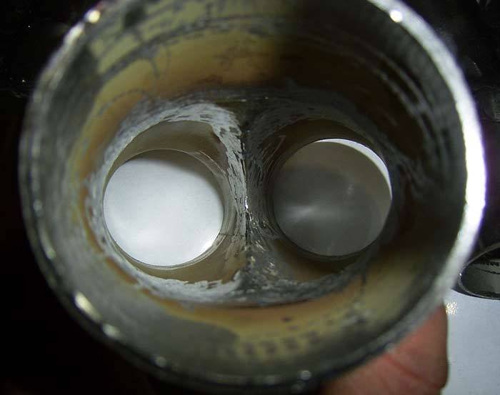

    I wana make these but they look scary lol

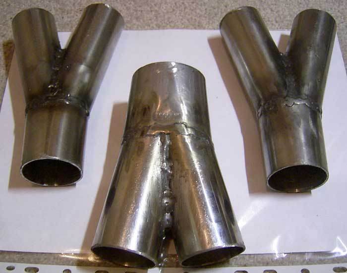

    I just remembered something, quite a few years ago there was someone on here who did a heap of back to back runs and they said a 20v was the most sensative engine out of any they had ever tested in regard to collector design. Small changes had big differences in torque.
    Here is my home made effort from many years ago:
