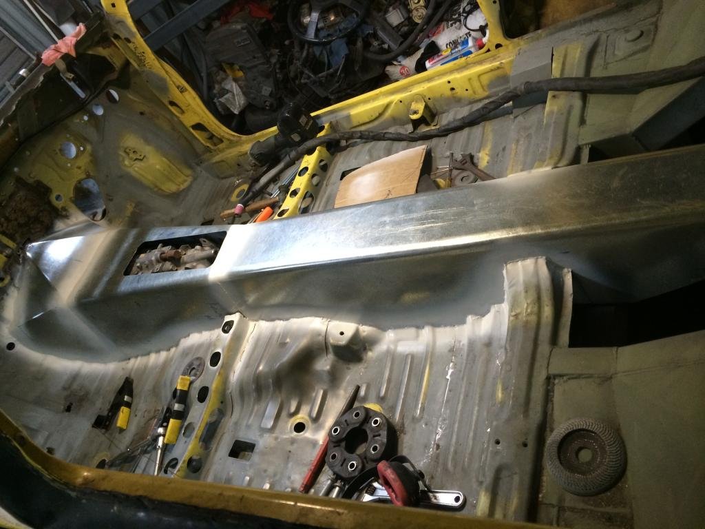

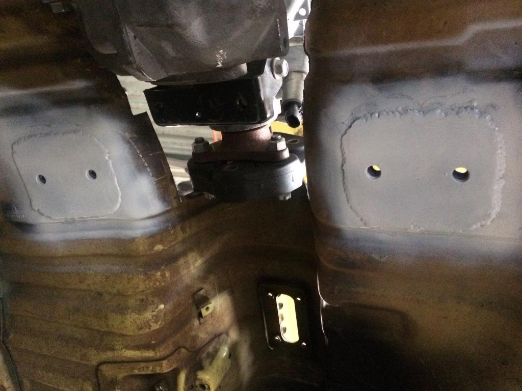

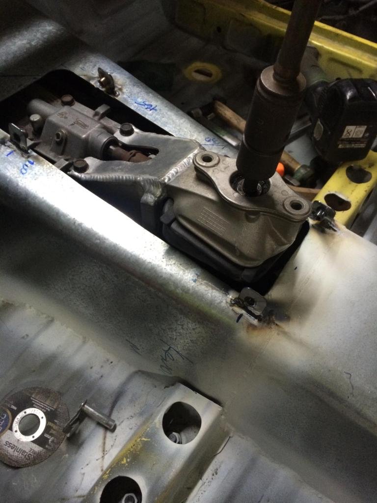

    Added doubling plates with nuts welded on the back side and welded to the underside of the floor brace that the seats bolt onto, made the gearbox cross member and started on the tunnel.

    That tunel is amazing, exactly what I shouldve done from the beginning

    damn you and your sexy tunnel.

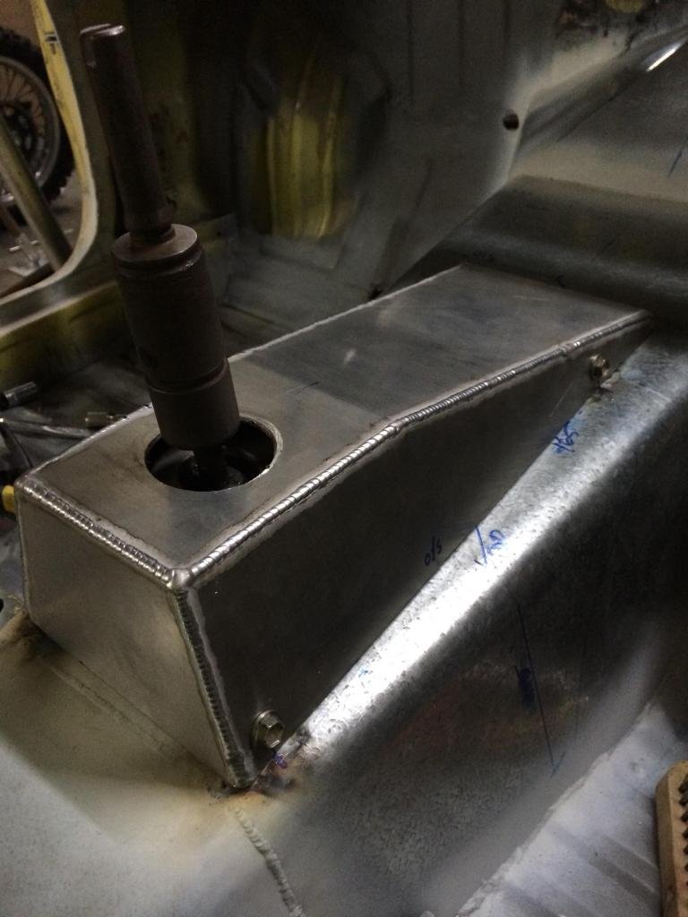

    Made the cover for the gear lever out of 2mm ali
