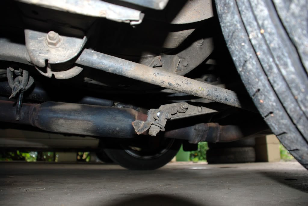

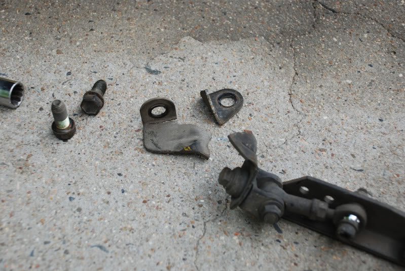

    This explains two things:
    1) Why the rear end has felt a little unstable since the last track day, and
    2) Why the rear swaybar has not been squeaking so much lately!

    Have replaced the swaybar now and it feels much better!
    Both brackets were cracked along every fold.
    Used the selbys swaybar off the wrecked trueno. It has a different style of bracket, so will see how long they last.

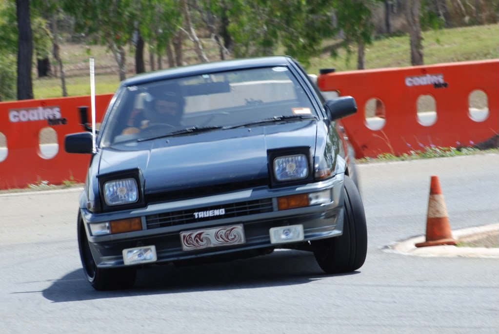

    Considering the car is cornering hard enough to lean over like this, its not suprising! Need to chuck a larger swaybar in the front to level it out a bit and keep the back wheel on the ground!
