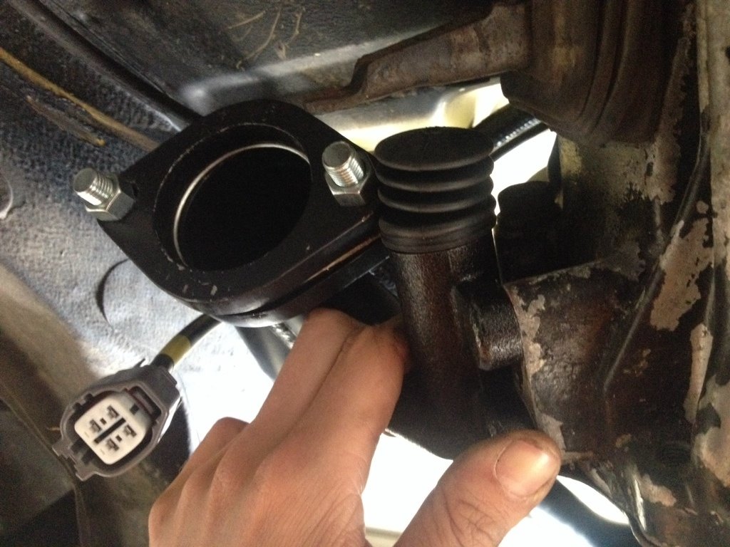

Got a blacktop going into my ke70 with an ADM type t50 and TRD copy headers. When I try to bolt the clutch slave on it fouls on the header flange as per the picture below.
Anyone else encountered this problem? I know I'll need a banjo fitting for the clutch line to clear but I can't even bolt the slave in place at present. Assume I will need to have the flange cut off, rotated 90 degrees and welded back on?
