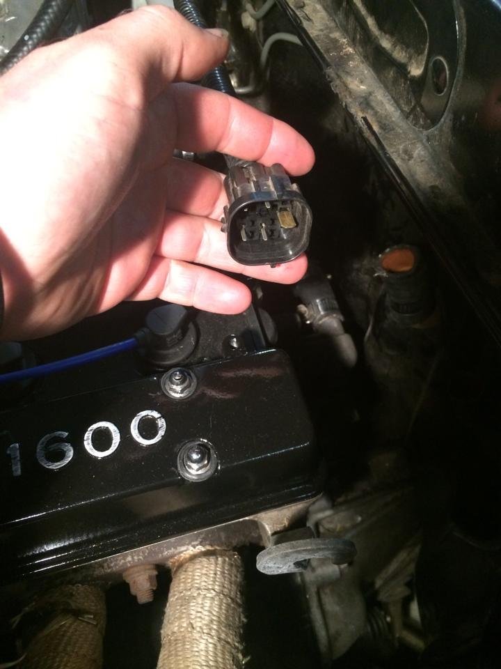

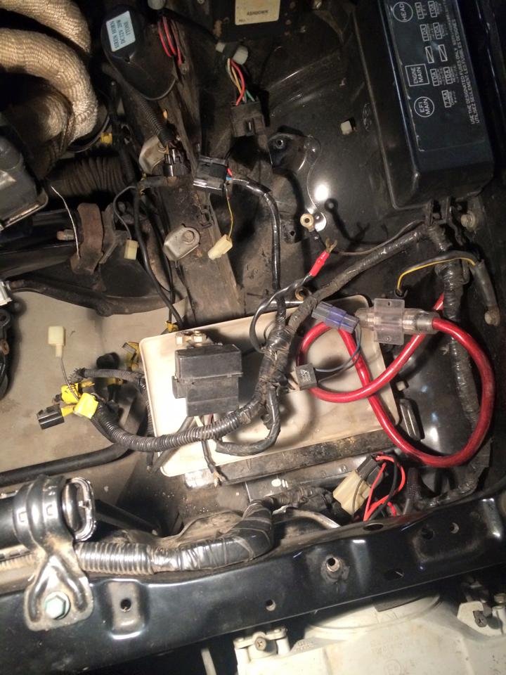

    So on the final legs of my first ever engine conversion. Now wiring scares the absolute shit out of me because I have no understanding of it and I want to change that and understand whats going on.
    The engine gone in is AE92 Smallport.
    All the original 4AC loom is still in the car and engine bay.
    This is the main body plug which connects to the other big plug end in the engine bay which goes off to the gearbox plugs, starter plug and i've got marked here "Temp sensor" plug.

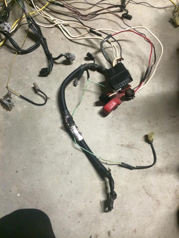

    This next photo is all the wiring that isn't connected to that main plug and goes to all the lights and heaps of other shit, AC plugs, coil plug etc.
    Now i've got a complete FWD AE92 smallport loom here, what the feck has to happen, do the two looms get merged, what needs to be removed etc.

    Being very brief you need to modify the ae92 loom to get power to what it needs for the engine to run. The first picture you posted mostly has the connections for the gauges inside the cluster and reverse lights. Those things you need to sort out are
    - starter motor
    - alternator
    - ecu power
    - injectors
    - igniter
    - coil
    - warning gauges etc
    Where you are at now is where most engine conversions fail and get abandoned because a guide on the Internet has been followed in correctly and the wiring totally messed up. If you don't spend the time learning what needs what, it is very easy to get wrong.
    If you can afford to, hit someone up who has done a heap of these before to do it for you and you will be driving the car by the weekend.
    The neatest way to do this conversion is to modify the ae92 loom to have the ae86 connectors on it. And to achieve the best result will take sometime.

    The loom going to the headlights Etc, just leave as is.
    The cable coming off the positive terminal goes off to the alternator. The 4AGE Alternator has three pins coming off the plug at the back and that will need to be wired up too. I can't remember which pin goes where but one is for 12v Ign, one is for 12v constant which could be spliced off of the thick white cable coming from the battery +, and there will be another pin for the dash charge light which can be found on the big round firewall plug you've got a pic off.
    There was a diagram I think on the page I linked to before showing which Alternator pin goes to where.
    That's basically what you need to know about the positive terminal.
    I used the wiring from the Smallport Alternator wiring and connected that up to the standard positive terminal.
    Once you start stripping the loom neatly and carefully, you will start to see what you need to do.

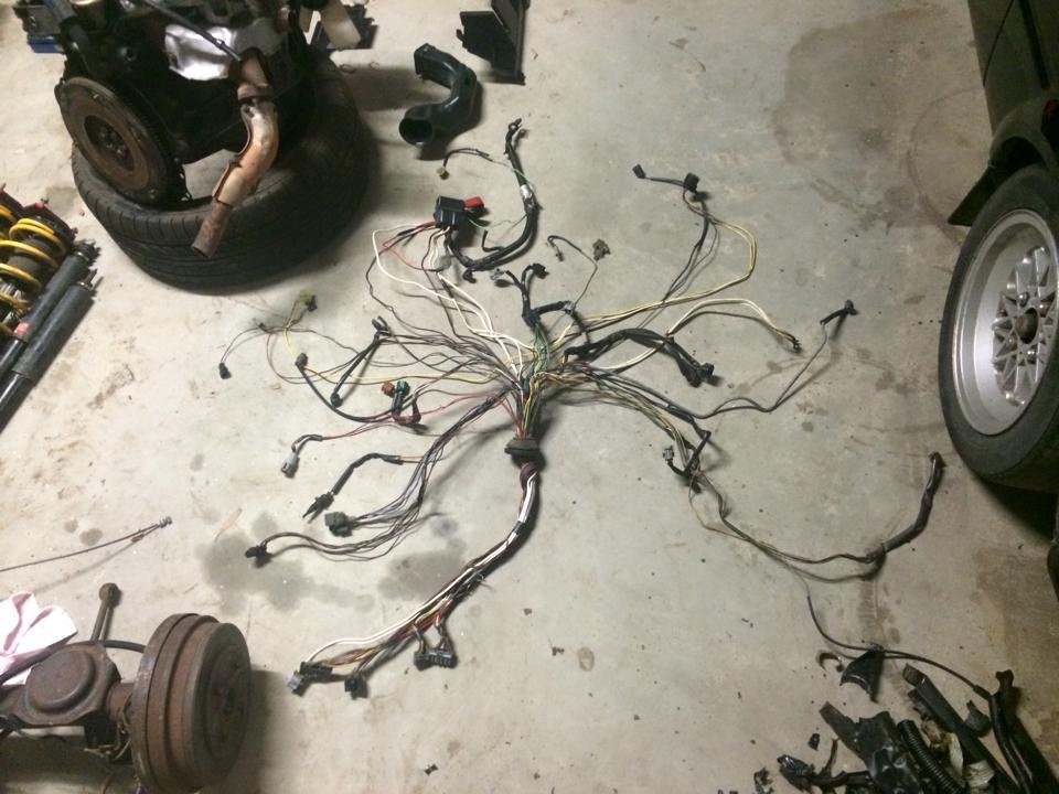

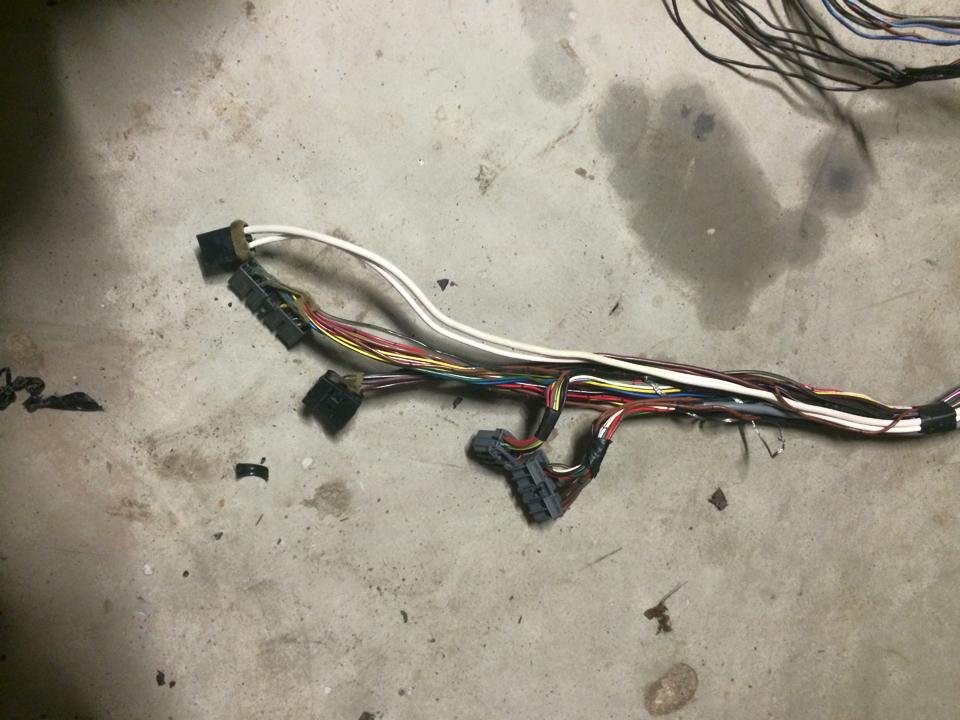

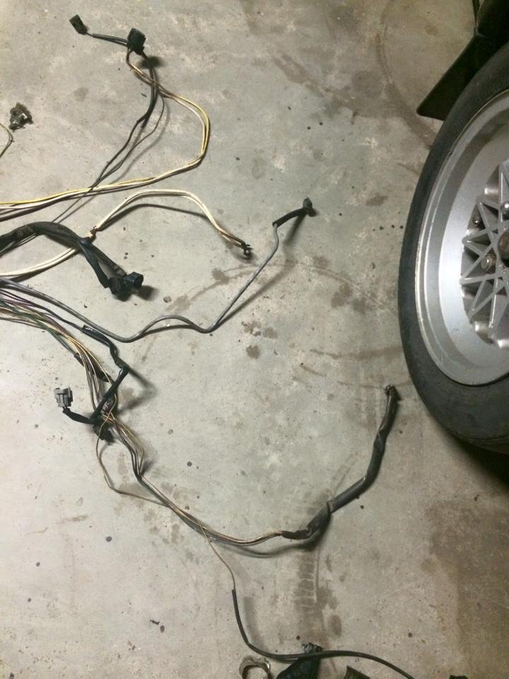

    Hey guys. Had a read of all your replies this morning before work. Got home super motivated and feeling positive about the whole ordeal thanks to all your information and stripped the loom back to it's wiring, keeping a few little covers on them which shouldn't be too much of an issue.
    So now I'm at the stage of figuring out what I can cut out and remove from the loom.
    @Hen , that would be sweet man ! Will be happy to supply some evening beers or whatever for any sort of help !
    Pics related.
