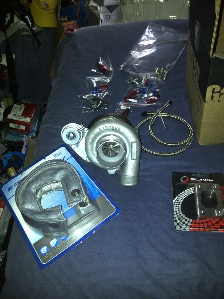

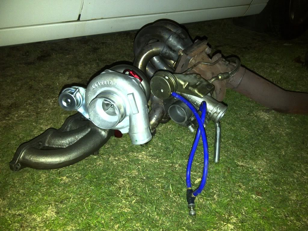

    yeah going good! was at drift practise at barbagello last friday night and had a blast! had a quick squiz over the engine before i left and noticed a crack
    around the turbo flange on the stainless china manifold! amazed it even lasted 3 years of torture. so will go 6 boost manifold and garrets 'disco potato' and a retune......

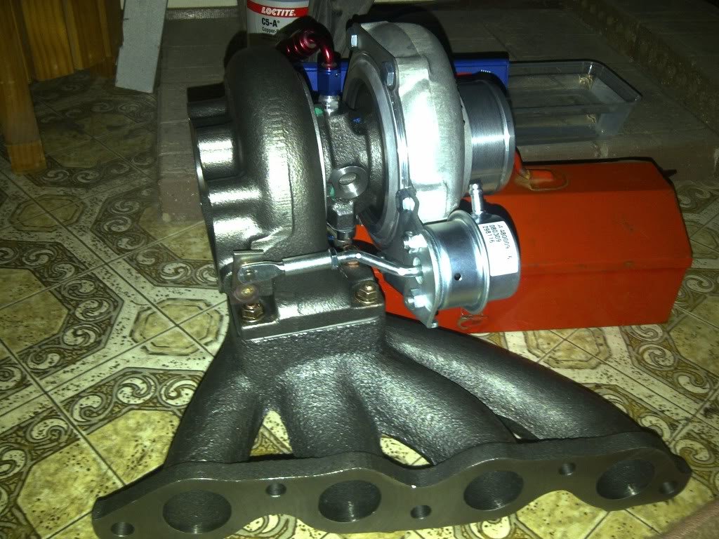

    definately the ugliest engine bay on dc but this new setup should easily push it to over 300hp atw. just gotta do retune inlet and dump and thats about it. will have to pull my diff centre out and get the backlash redone too i think... hurt it drifting lasttime on the track. did 55km of drift that night and now its singing on acceleration. all good
    my old turbo setup is for sale too if anyone is interested. turbo manifold and dump pipe. made 220rwhp on 14psi

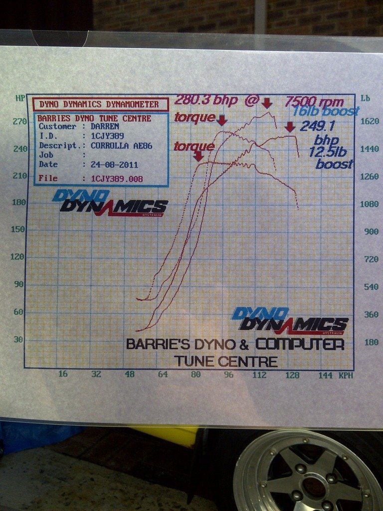

    new disco potato has been on for a few months now, made 280hp atw with the worlds shittest designed manifold, but its reliable and cos its cast iron wont crack like my old china stainless setup. will go a kelway steampipe manifold in the future. Went down to collie a month or so ago for 2 days of drifting, had a great time
