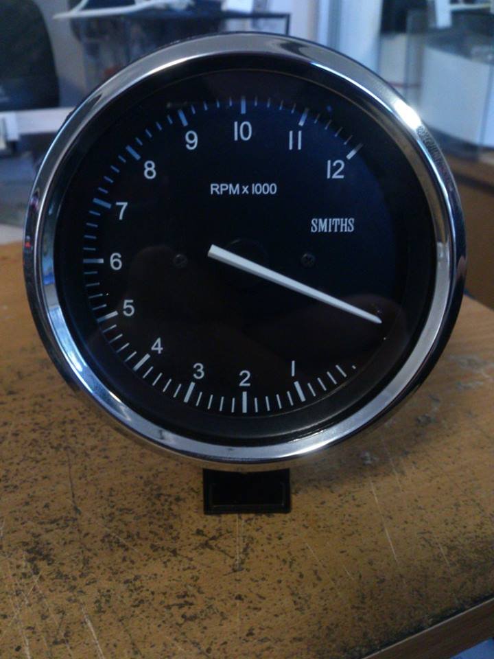

then the tacho i ordered finally came.
now its fitted.
