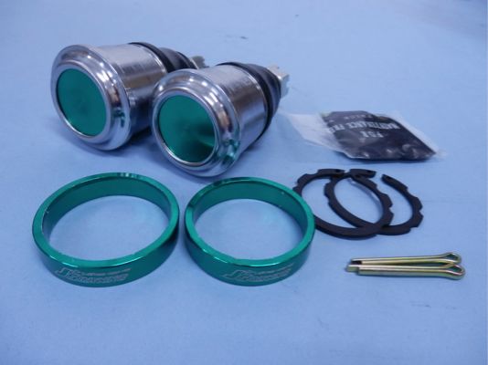

    like these: (honda guys use them alot)
    i wonder if theres some out there that could be made to fit corona arms?
    you just have to use the right ball joints that dont have those big nipples on them and you should have plenty of room.
    i know i do

    i was reading last night about those type of RCA's used on WRX's made by whiteline. They rock themselves out of the LCA and also the rubber boots rip on them constantly. scarey.

    yeh maybe they arnt the best idea then!!
    might just be the whiteline ones that are shit but.....like there swaybar links
