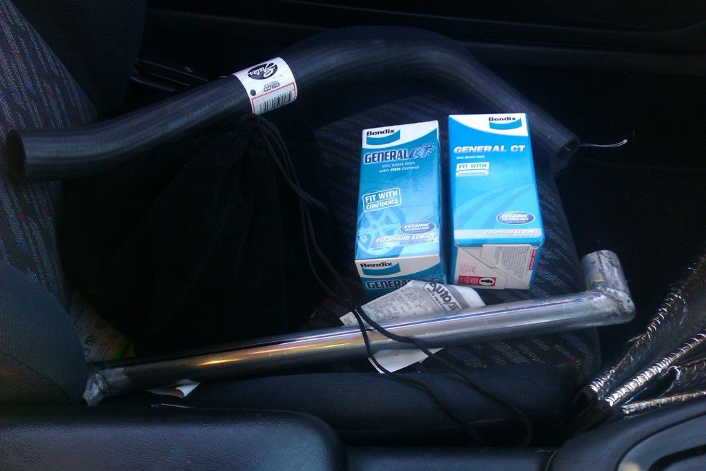

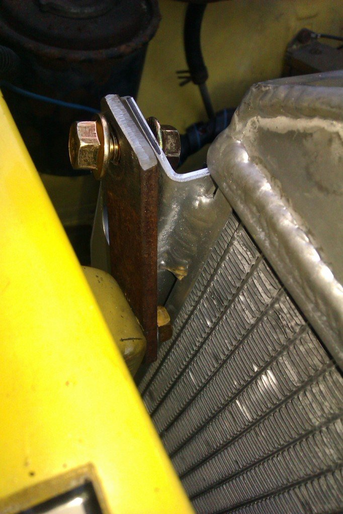

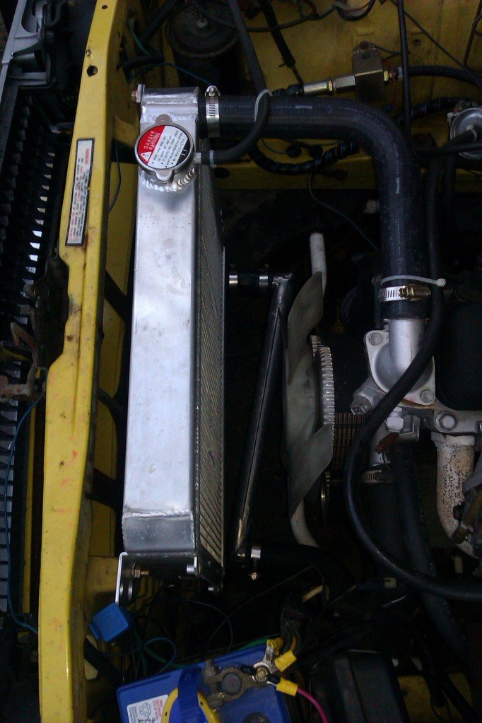

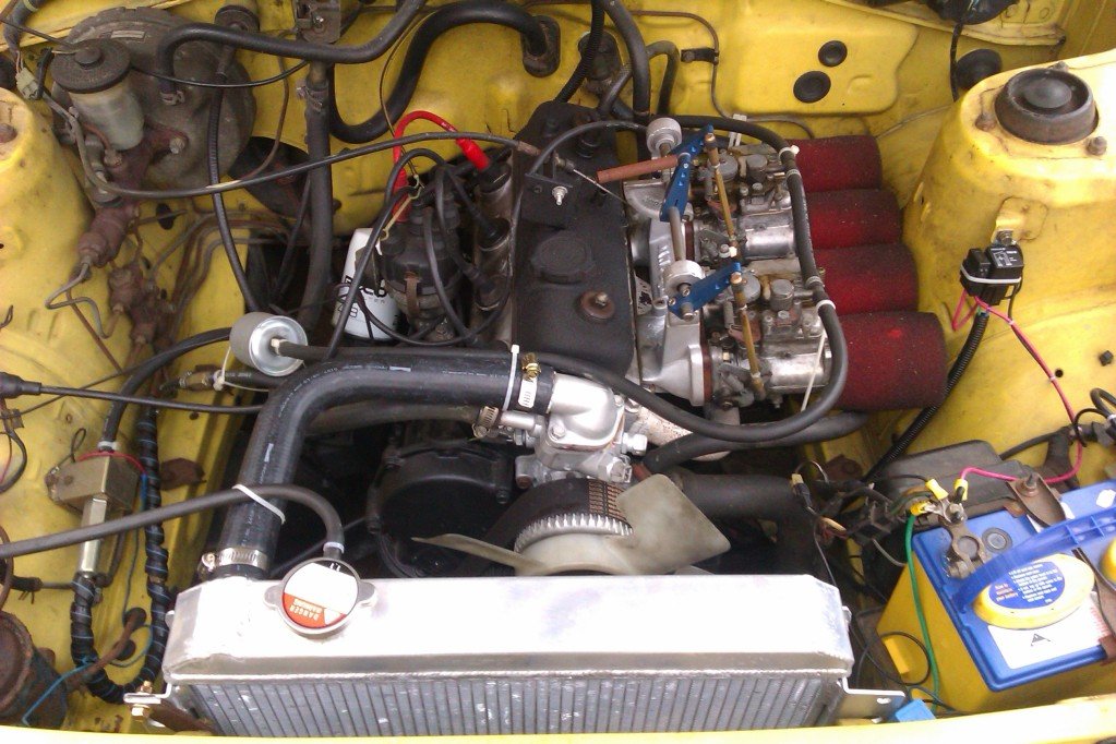

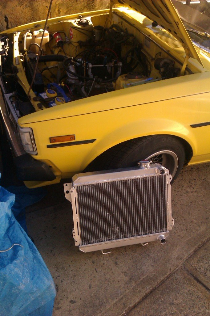

    installed one of the ebay AE71 radiators. the passenger side pretty much lined up had to redrill one hole and the drivers side i just made some
    little brackets up. used a toyota camry radiator hose i think, and made a crossover pipe for the bottom to the original bottom hose. worked out pretty good
    everyone loves pictures "missionuuu ridiathurrr"
    rim party!

    and the engine haha. used a engine inporter in perth, and it was totally ratshit when i recieved it. had water go down the carbies and number 4 piston was seized in there.... i just honed the shit out of the block to remove the rust marks around the rings. this guy has a bad reputation for selling shit engines, especially sr20's haha. but all good
    upon stripping it i pleasantly found the block was debburred inside, crank was knife edged, was bored out to fit 5k pistons, and had a 3k head. so i rebuilt the carbies and kitted them, had to make up some linkages as these were snapped in transit, and fitted new rings.
    its a slapper of a motor but goes really well

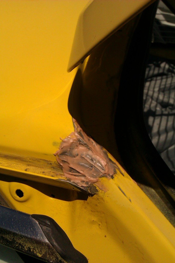

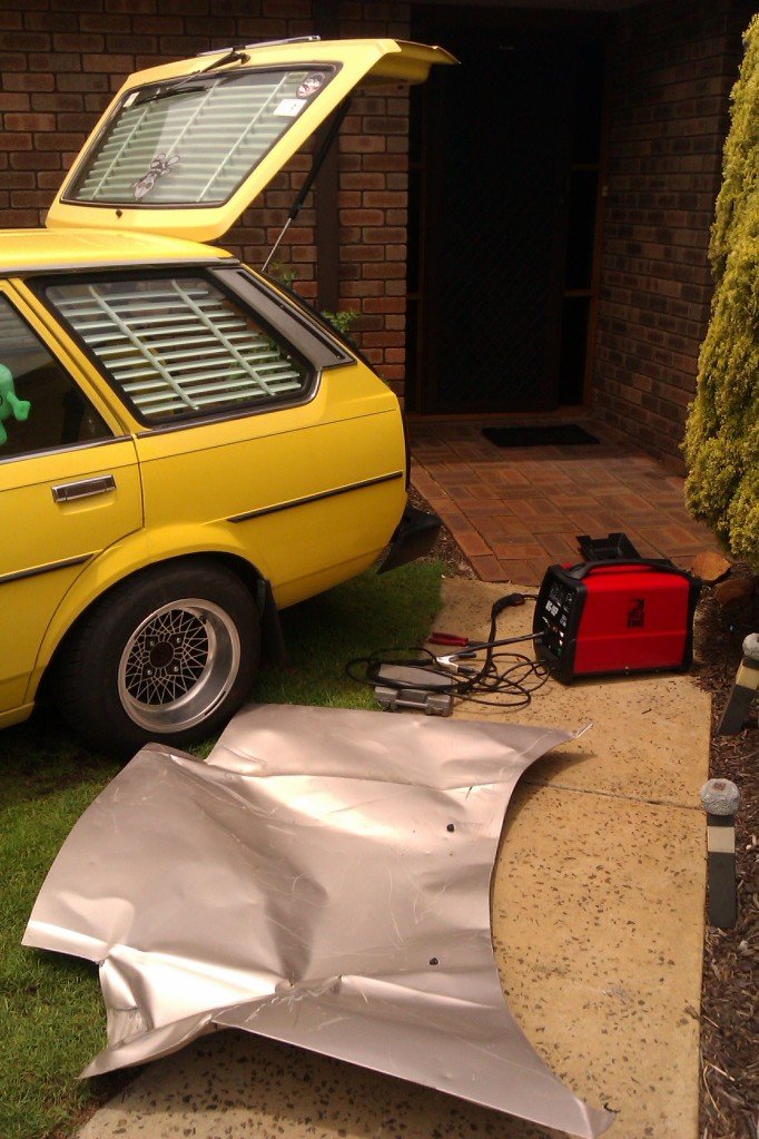

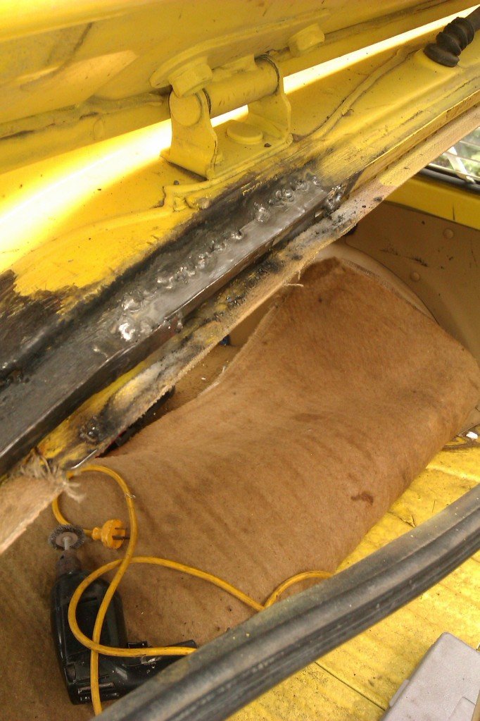

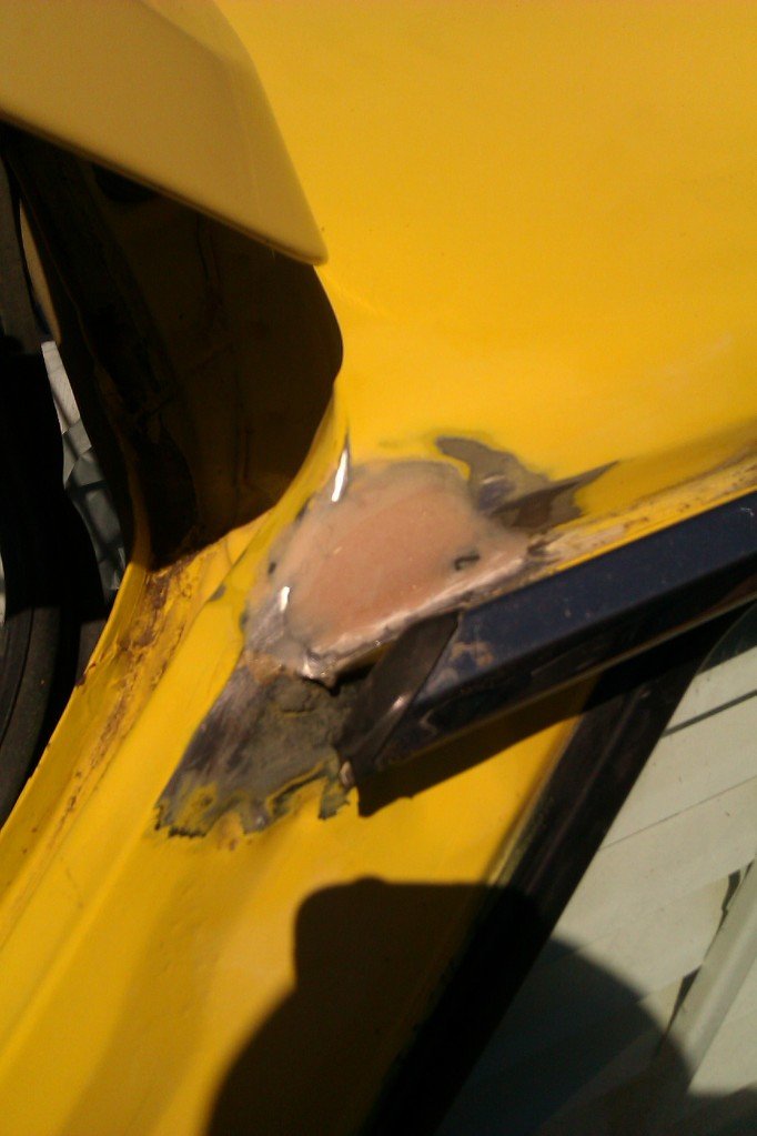

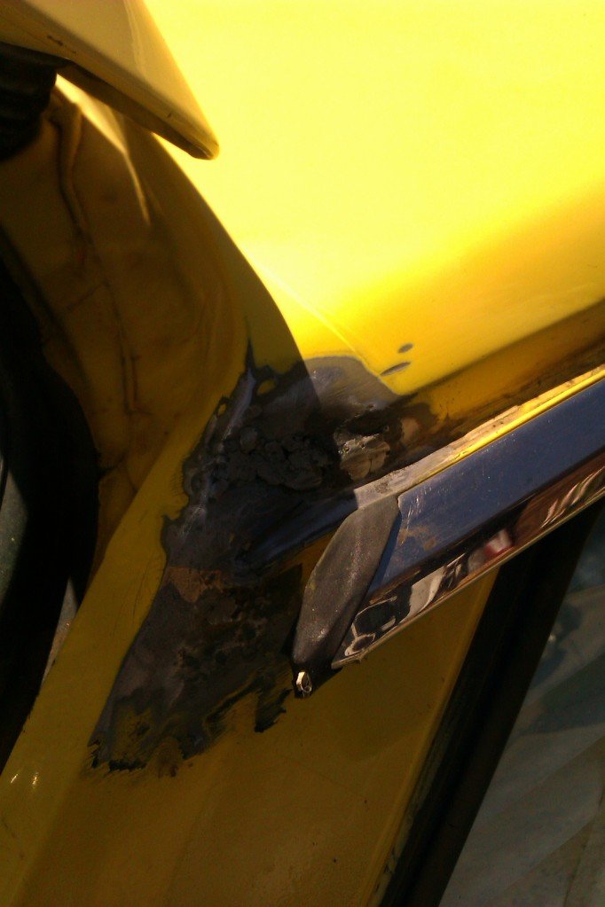

    a few months ago i noticed some rust had started to have a bit of a party on my beloved!! this was not on
    so
    this was after i welded and ground the hole and rust converted it
    wallla. took about 2 days of fairly steady work, and cos its a home job it always takes longer
    then i sprayed from the inside fish oil into all the cavities of the car!! pulled all the door trims off and sprayed like a wild goanna full of crystal meth and a monday night
    the rusts party was over

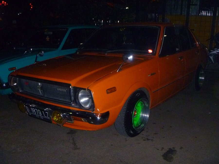

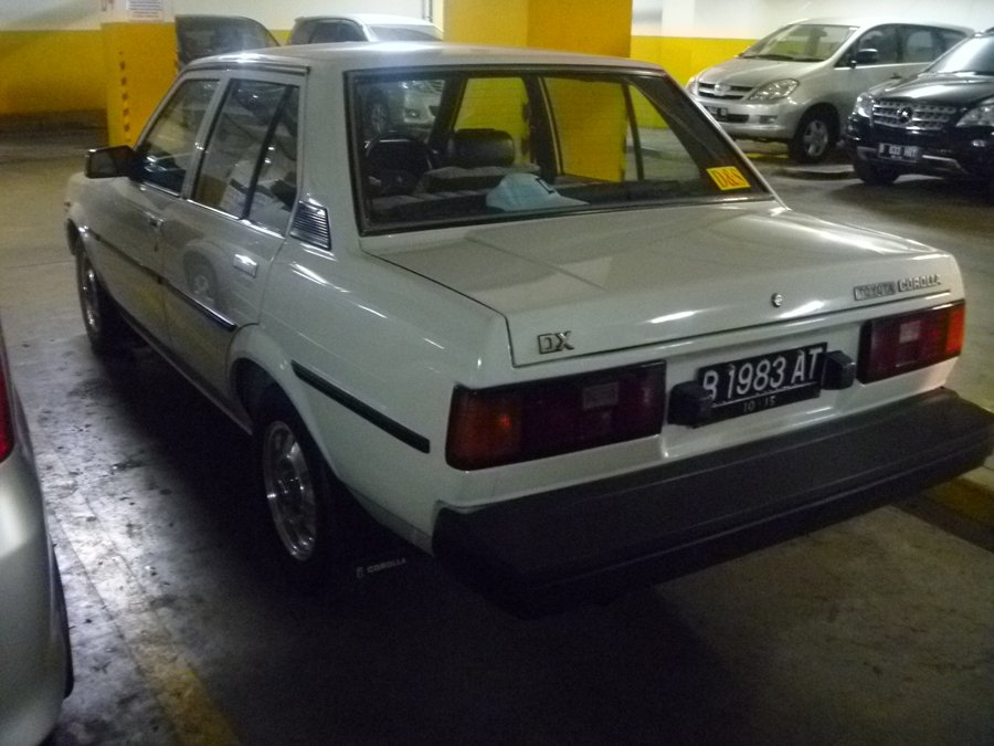

    been in indo for the last 3 weeks at my wifes loving it! went to jakarta to visit my mate denny who i bought my indonesian corolla off, and he took us to Bandung about 2 hours south of jakarta. there we met Corolla Retro Club CRC and seen some of their cool cars.
    seen this
    this is my mate yosefs Ke70 in jakarta. pictures dont do this car justice!!!! 100% original and he is a fanatic!! Even the badges on the boot are perfect.
    and it runs as smooth as a sewing machine. something i really admire
    notice the wheels... i had them sitting around at home, and he wanted them so he got them shipped to jakarta. And he got them polished, came up mint!!
    the Aussie CSX alloys are equivalent to the GT TE70 spec, so these wheels are really rare in indo, hence why he wanted them :-)

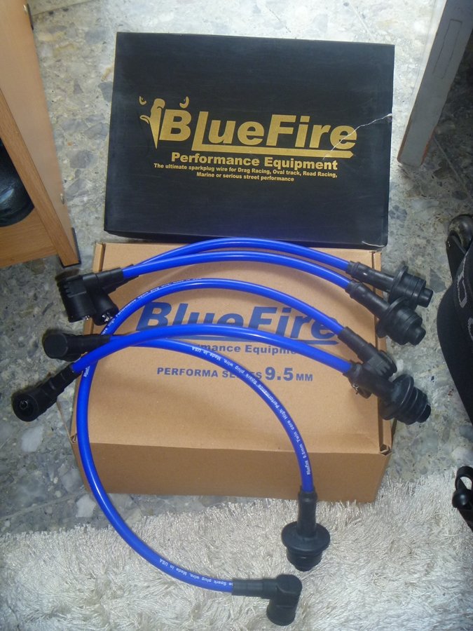

    and finallyyyyyyyyyyyy some goodies for my wagon!!
    9.5mm twin core lead set yeeeooww!! should look pretty good

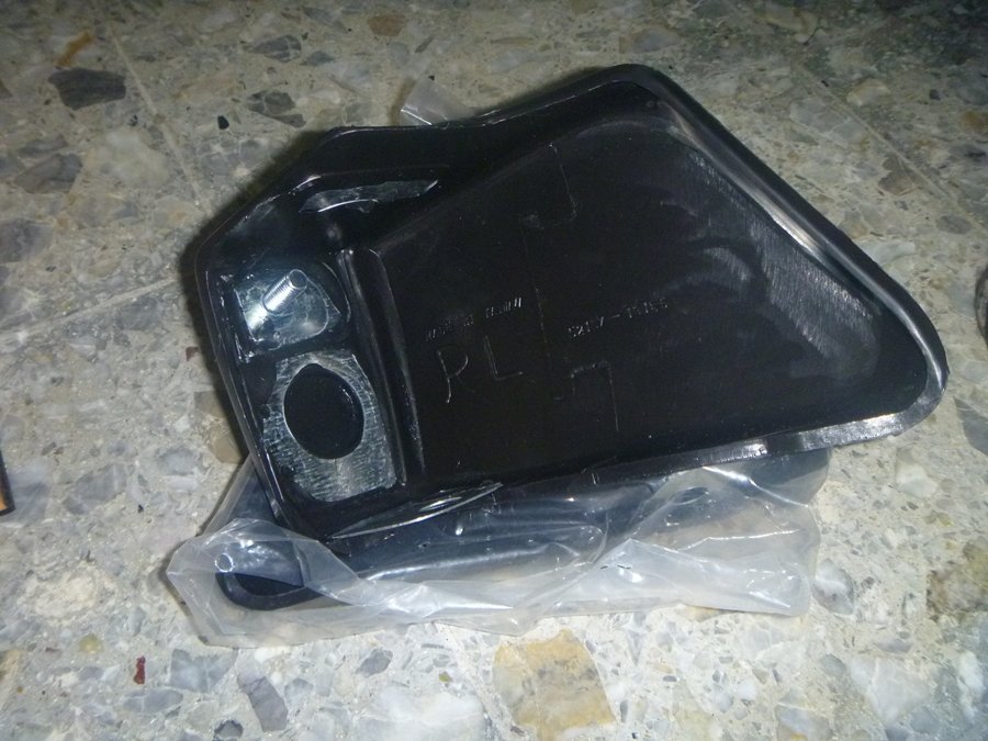

    and some repro bumper caps for my front bumper
    should neaten it up a bit :-)
