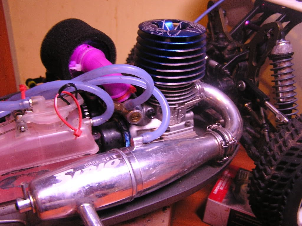

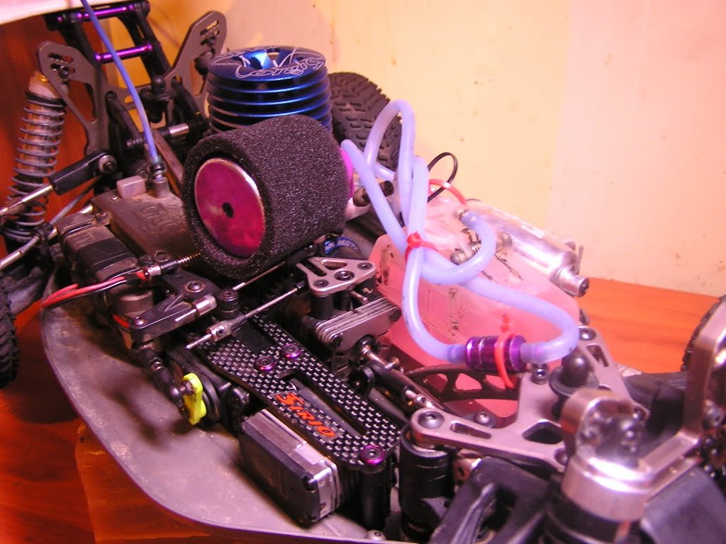

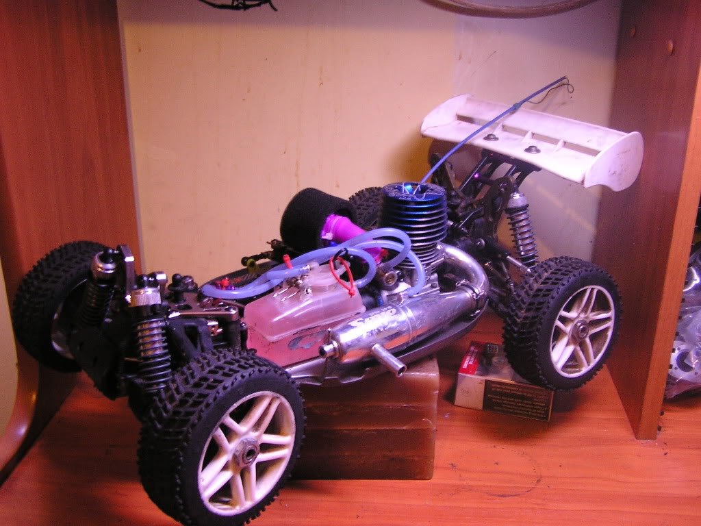

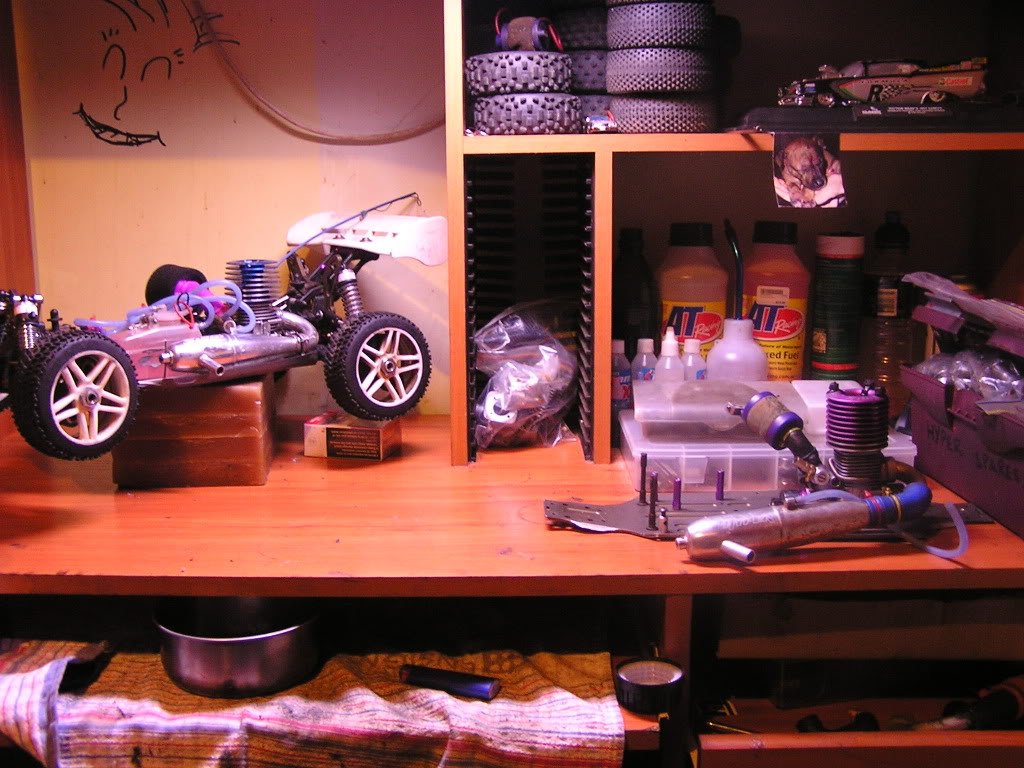

So I have got back into this recently, and really enjoying, heres some pics of my latest Hyper PCR with a Sirio CL3, she goes alright.
I find working on and modifying these things rather relaxing, and have started modifying engines with varying results, its good fun.

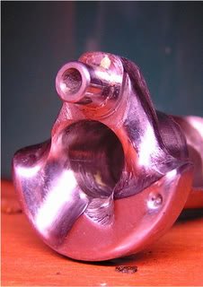

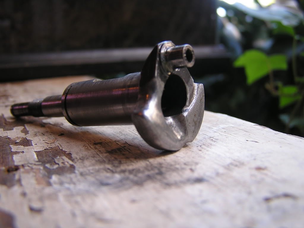

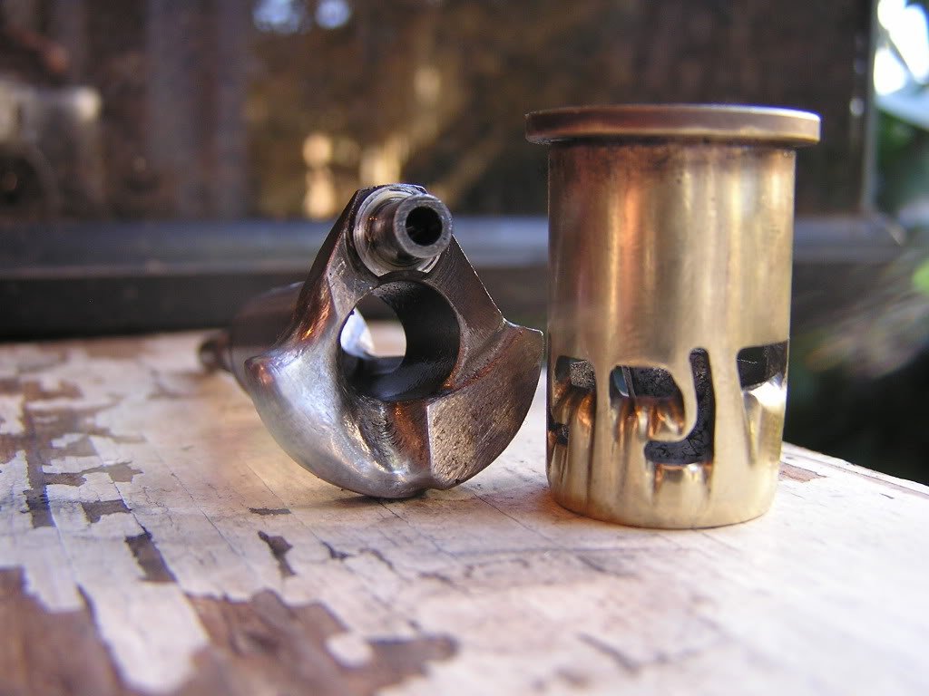

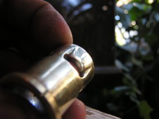

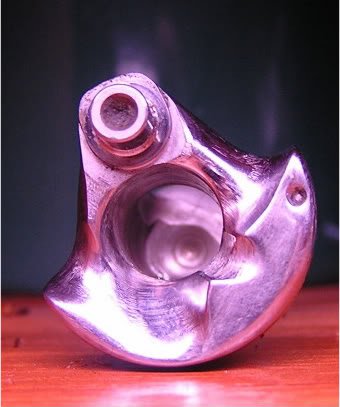

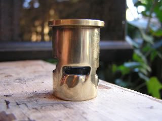

I have been spending alot of time, trying to get into the hobby industry as of late, it's a bitch, though I have secured a part time job doing engine mods. I have since started building and modding my own engines, I feek I am getting quite good at it. So I figure why not show off what I can do.
This is my Stage 4 Sirio CL3 engine, this is my most successful engine to date, one I built for a racer identical to this, has landed on the podium 2 weeks consecutively, quite impressed with the result. Power figures from the short dyno session these engines have seen, see the engine making 3.4hp (2.6 stock) @ 39,000rpm, peak rpm 44,000.
This engine is a Hyper .21 8 port, a cheap engine, but has an insane top end. Unfortunately the bottom end isn't that great, but 90 clicks from a single speed 1/8 scale buggy weighing in at 3.7kg is pretty impressive, Peak rpm is above 45,000 rpm, but my tacho won't read over 45,000 so it could be more.
