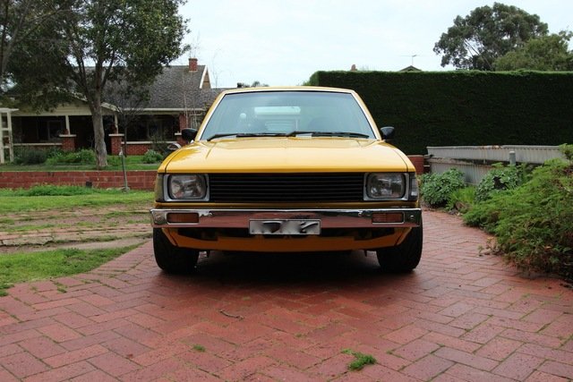

    Hey Guys.
    This is my car, i've never put any pics of it up before as i've never felt it was finished (they are never finished lol) i've put alot of time, effort and money into it over the years.
    Body:
    The car was stripped back and dents pulled, rust removed and painted in Devil yellow.
    The chrome bumpers are custom made.
    All the lights were new when i put the car back together

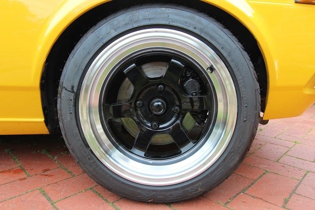

    Wheels/Tyres:
    Rotar Grid Classic 15x8 / Federal 595 RS 195/50/r15
    Suspension:
    Front: Ae86 struts 60mm chopped and weld on spring perch, 6kg springs, shot stroke shocks, cusco camber tops and 40mm rca's
    Rear: 4.5kg springs, ride hight adjusters, short stroke shocks and techno toy tuning adjustable panhard rod.
    Steering:
    16mm lock spacer
    Drive line:
    Exeedy ceramic button clutch, t50 gear box, ae86 late disc rear end with trd 2 way and 4.77 gears
    Engine:
    16v small port, ae111 quads, hks 264 cams IN/EX, fidanza adjustable cam sprockets, high comp head gasket, 4-2-1 extractors 2inch exhaust and a extreme aluminium flywheel controlled by Motec M4
    Brakes:
    Front: Mazda rx7 s5 callipers with sw20 rotors
    Rear: Ae86 disc brakes
    Big thanks to my Dad and my brother for all their help, James for the paint work and Charlie for the help with the fabrication work.
    And also thank you to Frak for his help with dyno tuning the cams in all those years ago and ongoing advice.

    Holy shit, that's the perfect daily!
    I can see all of the hard work and effort gone into this, so incredibly clean.
    Is that the Monaro yellow?

    Hey, cheers mate. It was the daily for a long time but now it's my weekender so much fun to drive.
    Yeah the paint is monaro yellow.

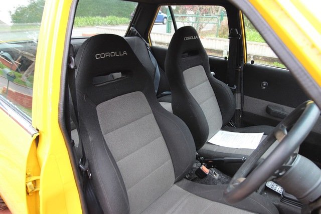

    who made the bars?
    has this car got anything to do with sovereign automotive?

    Wow that looks amazing! Are they Suzuki Gti seats? Did you mount them on the factory rails or did you mod the Suzuki ones?

    Yeah I work at sovereign auto, the bars were made by I guy I work with and the I got them re chromed.
    Yep the seats are from a swift gti, I had to mod the chassis rail in the car as I found the seats sat to high. We did try putting them on the rolla rails first and looked at modding the gti rails to but my head was hitting the roof and I'm not that tall either.
