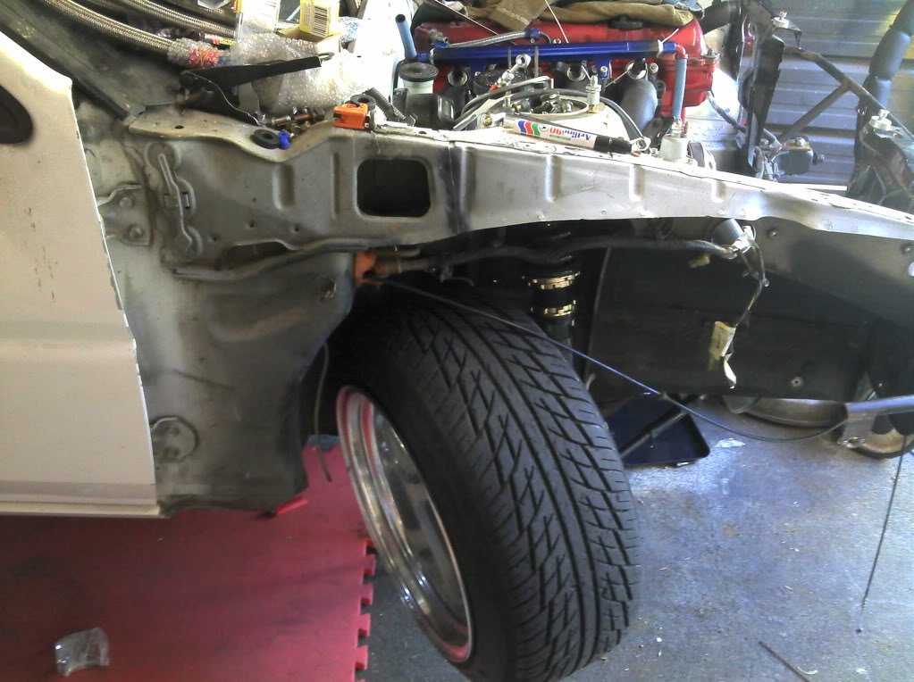

i am using corona knuckles (125mm bolt spacing) with 22mm longer LCA's (no camber tops, guessing around 2-2.5 degrees of camber), maxed out caster rods, when i got an alignment it was about 5.5 degrees, with a lock spacer i made that allows 25mm extra rack travel. (longer than the ajps ones)
running performance hurricanes (8j -10) with 185/60's
i would say i have about the same if not a little bit more lock than you, i was running into the same problems as you, front scrapes on the tub, rear scrapes on the inner guard/tub/rail whatever that part is (this was when i had standard lca's, fixed it with longer lca's), and the brake line where it comes through.
i also had problems like castor rod bolts hitting the strut bolts, might want to check that isnt hitting,
another thing i can think of is that physically the xt130 LCAs might be thicker than standard ones? i have never measured that shit so i wouldnt know, might be something to check.
only pictures i have of my lock for reference
[img][/img]

My current setup. Is cut knuckles. a fair amount shorter and roughly 1/3 the factory angle. Adjustable LCA that I have MASSIVELY notched and is wound out almost as fat as it will go. relocated castor arm. AJPS lock spacer And moved the rack for approximately 25-30mm
With the setup the way it is now My tyre rubs the chassis and I still have rack travel left. To gain more angle I need to make the LCA longer. Which requires cutting and adding and also I need to find longer rack ends.. Using celica ones at the moment which are longer then 86 but need to be even longer again.

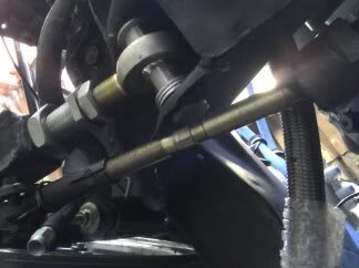

Also considering another set of knuckles. with 0 or even anti ackerman. and not as short.. Which will allow more angle befor bind aswell..
And this is another issure I run into if I run rediculas castor.. Roughly 10 degrees in this pic..
