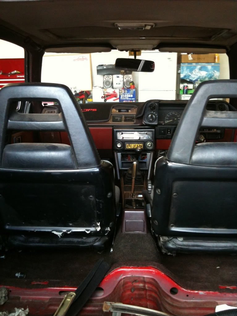

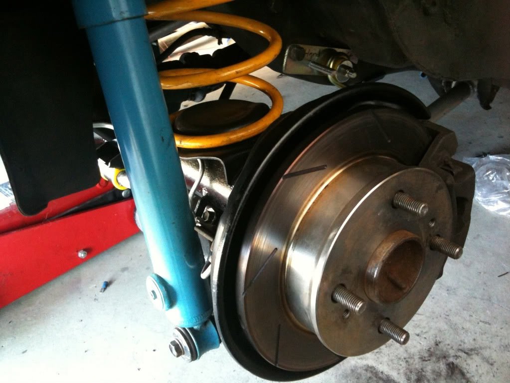

    Coilovers + front brakes in!

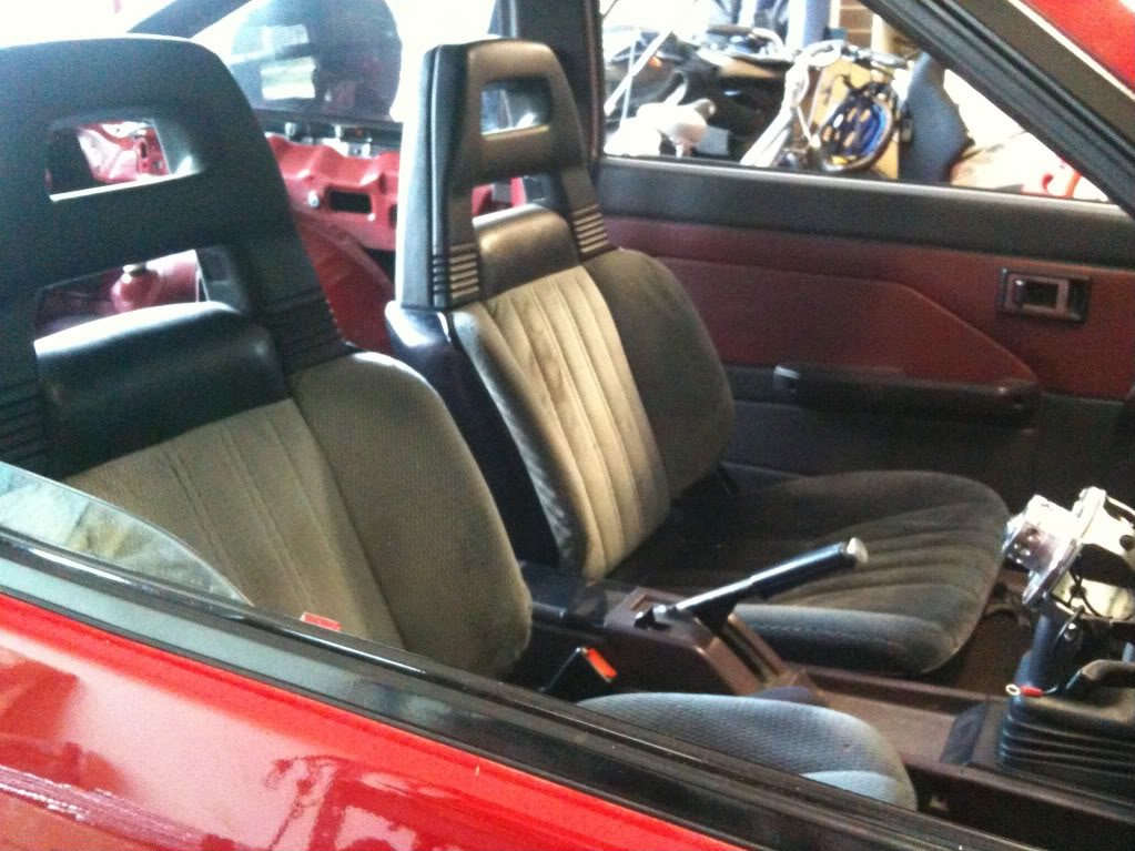

    Front interior fitted: (waiting on 1/2 cage to sort rear)

    Oh yeah, I noticed the passenger seat belt won't extend, it will retract, but as soon as you try to take any belt out the belt lock engages, no matter how slowly you try and pull the belt out... Am I missing a lock out button or something?
    Anyone know a way to fix it?
    Cheers
    Current Cars:
  3. #53
    Veteran MINIHORSE's Avatar
    Felix
    Inglewood
    2,150
    depends on the angle of the car...when I had new belts put in I noticed this....just a matter of pulling off the B pillar trim and rotating the enusure reel by like 2-3 degrees

    yer theres a little ball in where the seatbelt winds up and that ball has to be at the right angle for it to work properly.

    Once again, big thanks for those that commented on the seatbelt (especially Minihorse) turns out it was just because I had the back end jacked up fairly high, works fine level.

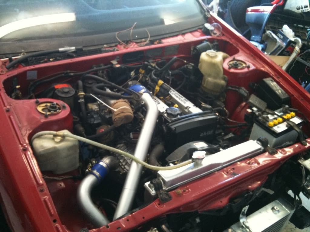

    Righto some more boxes ticked:
    Brakes all on and bled, system complete and pedal nearly solid (just as I like it!)
    Intake pipework Made, painted to prevent surface rust this time, and installed
    Plus lots of smaller items
    Front and rear bars back on
    Bracket for coilpacks modified painted and installed in position
    Strut brace back on
    Bonnet back on
    clutch also bled and working
    horns connected
    etc
    etc
    etc
    Profit (OK maybe not)
    And now it sits ready to be driven! Gotta get a permit on Monday (working all weekend) then Ill be off to get the exhaust modified and fitted. Then Im just waiting on the cage and Im going to re-do the intercooler brackets. Oh yeah, gotta go and grab a cheap radio for it too I guess
