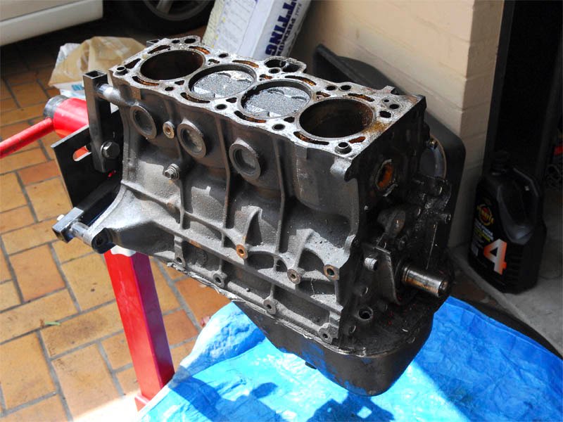

First up, i needed a 4A block for alignment purposes. I will (have) stripped this block down, removing EVERYTHING except the main caps.
I will be getting a 50cm long tube machined (approx ~50mm thick) that will fit in place of the crankshaft, which then aligns with the bearing hole in the J160 (~75mm), with a small lip to keep things aligned in the .. other axis. As far as i can see, this is the most accurate way (within reason) of getting the alignment perfect. I'm sure the picture below will make absolutely NO sense, but somehow my machinist understood what i wanted.

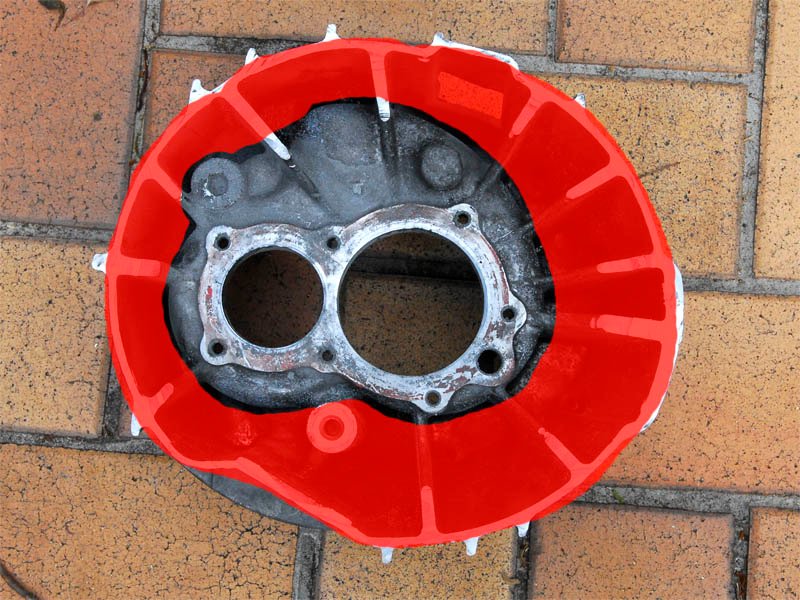

I measured up both the bellhousings, and decided i only need to have 84mm of J160 bellhousing left. I measured 10cm up the bellhousing....
....And chopped the crap out of it. The machinist will be milling it down to the correct size, i was just making his job easier
I'll then be getting a 10mm thick chunk of alloy made approximately this shape. I've seen people use much thicker chunks of alloy, but since the bellhousing itself is only about 3mm thick, this should be sufficient.
I originally wanted to do my cut/shut EXACTLY the same way as the CBY mob, but unfortunately i have an IS200 J160, meaning the clutch fork is all on the wrong side (like ADM t50's YO). The way i'm doing it should also mean i won't have to space the clutch slave, and i can use ALL the standard AE86 hydraulics, including clutch line/slave/throwout/fork etc. At WORST i will only have to machine the T50 bearing carrier out a couple of mm to suit (i had to do this with my previous cars' W58 conversion), and maybe weld an extra bit of length to the rear to the carrier to stop it "falling off", but that's easy.
