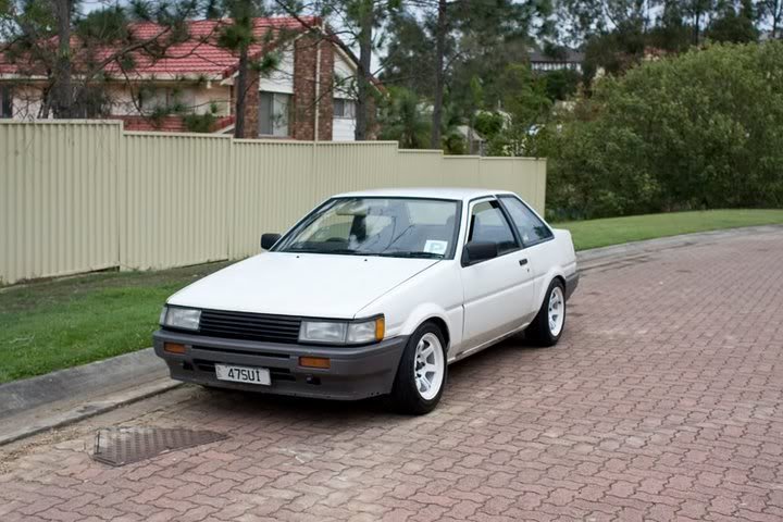

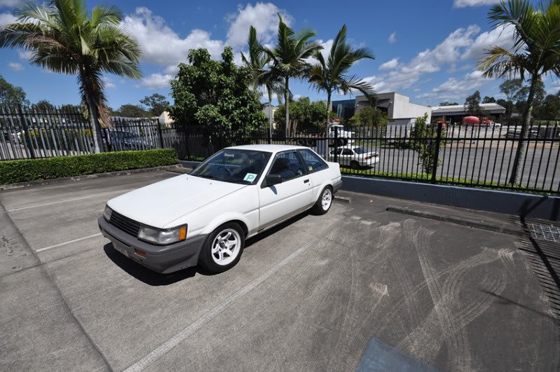

    lol just saw these two pics one after the other. fair change... do miss the coolness :\

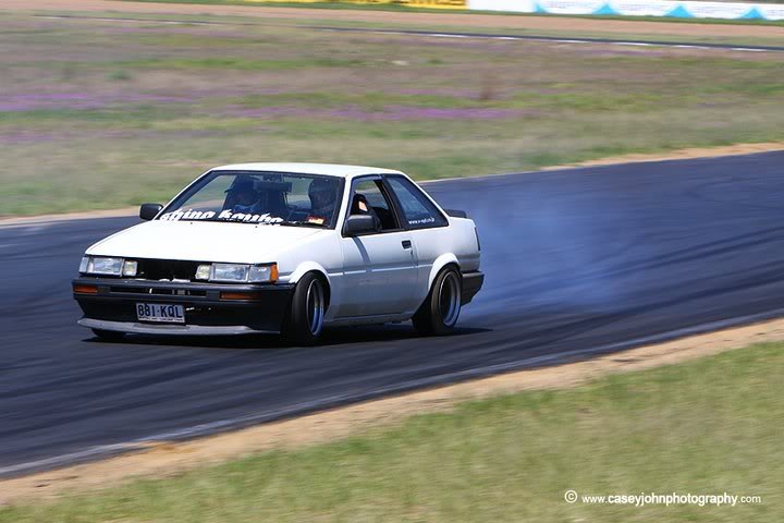

    edit, another random pic cause im bored. this one makes me happy!
