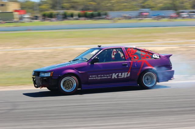

    my tire guy in wa called antique tires in kewdale sells white walls and also puts them on with the grinder and paint. looks cool. he does redlines on my tires for drift comps on my 86.

    [IMG][/IMG]
    INDEED THEY DO MR.Z
