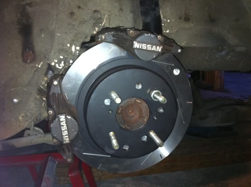

    rear brakes sorted! R33 rear rotors and twin calipers for independent hydraulic handbrake
    Special thanks to brodie and rusty for their help

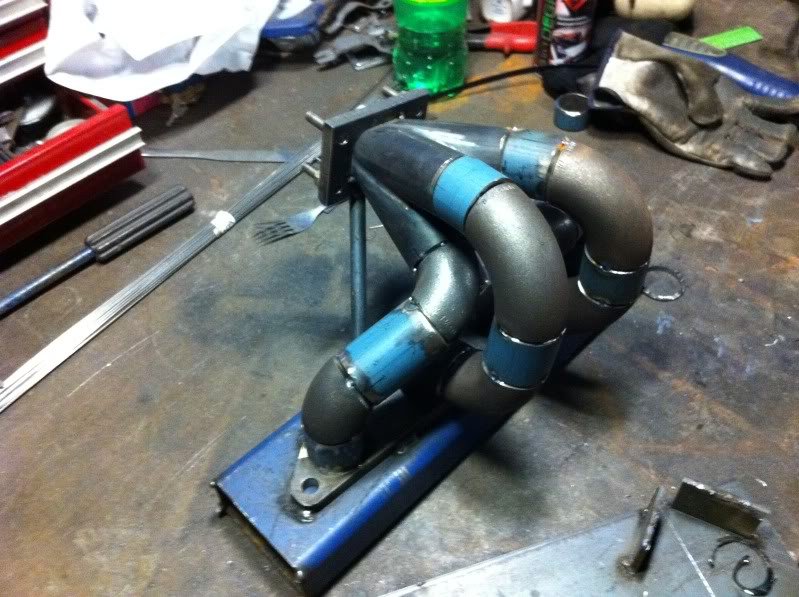

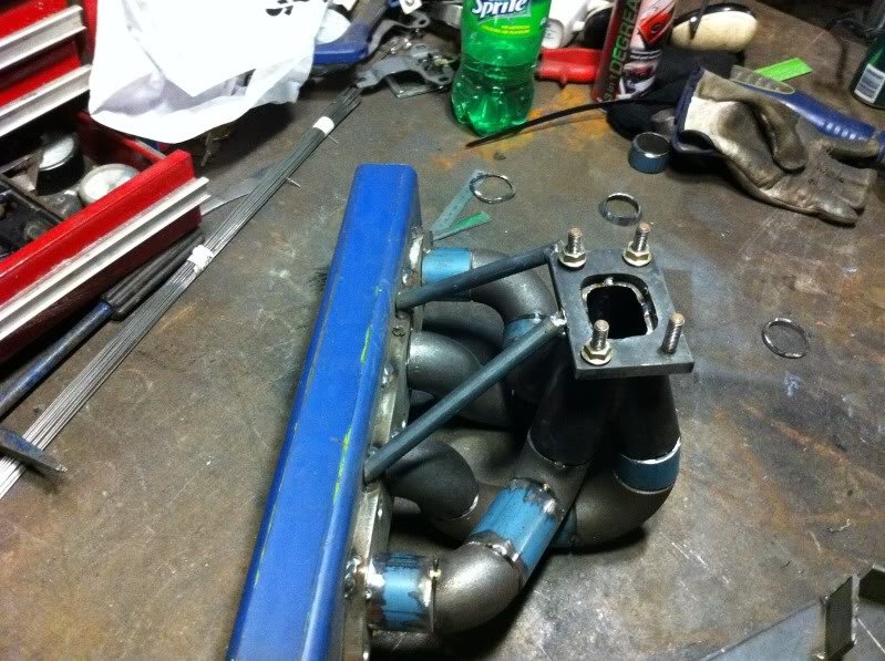

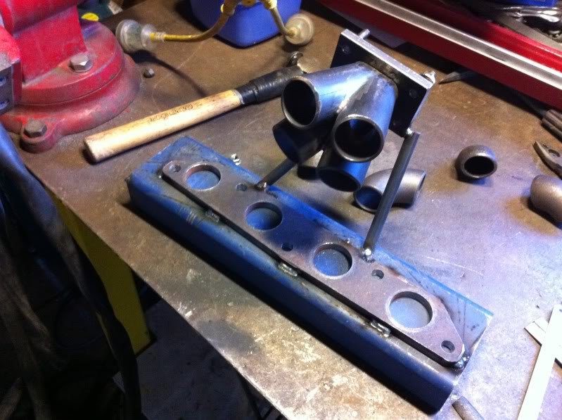

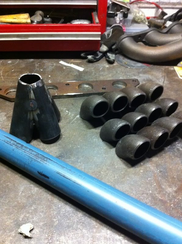

    started fabricating an exhaust manifold, the hks style manifold didnt put the turbo in the best position.
    Ive changed it a little since these photos where taken had clearance issues with the starter motor and CAS

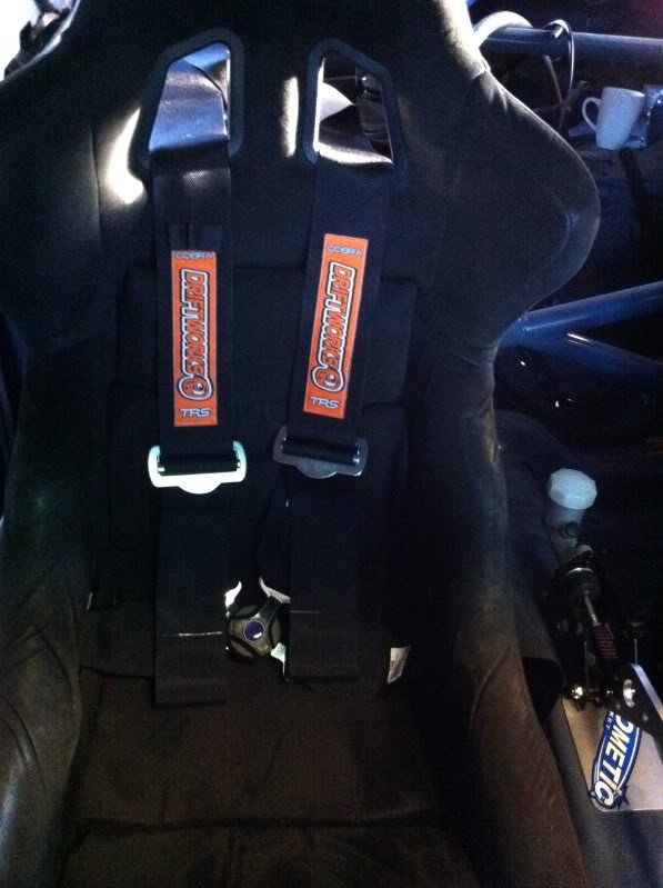

    Also fitted some drift works 4 point harness too
