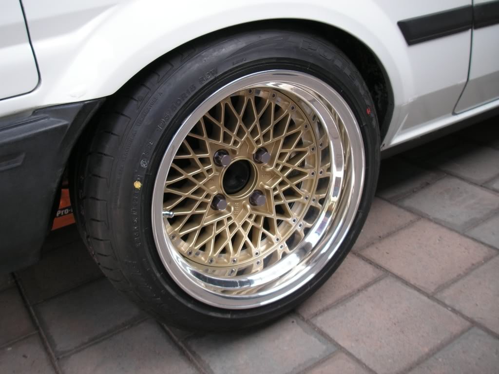

    this is from my old corolla
    14x7.5 -5 fronts, with sigma lcas and -3.5 degrees camber
    14x7.5 -6 rear, with 5mm slip on spacers
    guards are all metal and flared with a hammer.

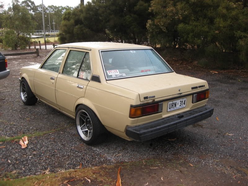

    15x8.5J -21 195/50R15 Origin FRP Fenders (Lipped), Coil-Overs, Camber Tops -2.25¤, Cusco RCA and Castor +4¤.
    15x9J -2 195/50R15 Rolled Guards, Coil-Overs
    But when FD brakes fitted to front required 12mm spacer to clear caliper. so moved 15x9 -2 to front resulting in same outer rim position with spacer.
    The 15x8.5 -21 on rear now scrub over larger bumps so rear guards will require some more modification for smooth running. Current stance:

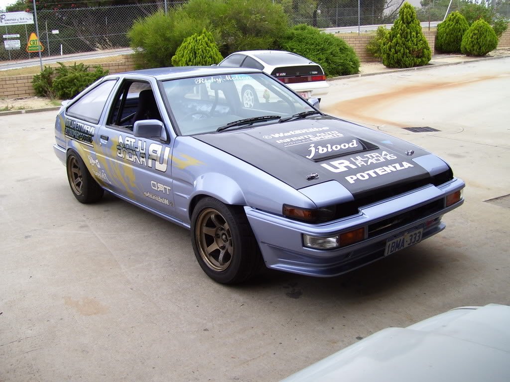

    Veteran driftke70's Avatar
    Ryan
    Buderim
    5,496
    suspension
    coil overs
    gh arms
    +4 castor
    0.5 toe out tot
    -2 camber
    guards different now, as they rubbed on the front, had to cut alot away etc.

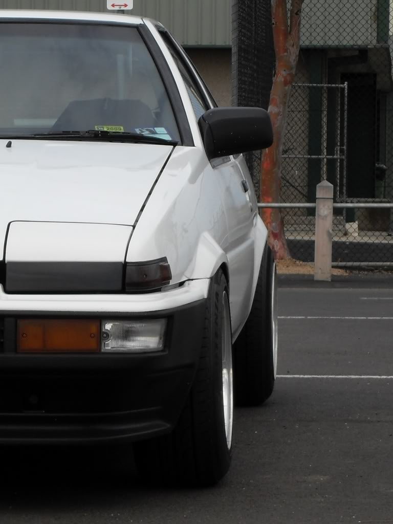

    Front 15x7.5. +15 (+20 with 5mm spacer)
    205/50 R15 Tyre
    Corona XT130 LCA
    -2 degrees camber
    Clears easy. Was flared to suit 15x7 +1 offset with a 205/50. Handles better with no twitch and steers better at slow speeds with 15x7.5 +15 for some reason.
