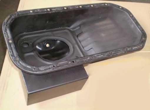

    I was looking at using a 7A-FE sump, but found out that it isn't a easy fit to a 16v 4A-GE block.
    So I'm looking into modifying a standard pan. Just wondering if anyone else has done anything similar and the pros / cons to different methods.
    Seems the most common design is adding "wings" to either side to increase the capacity and baffling to help keep the oil down by the pickup during corning.
    Heard bad things about trap doors getting stuck and starving the engine of oil, so kinda want to steer clear of those.

    The 7A-FE two piece sump bolts up to AE101/AE111 4A-GE block but not the AE86/82/92.
    Because the late gen engines have the cutout in the block/sump to clear the transfer case.

    Bugger. I was thinking of using the 7a sump purely for more volume/more oil which I don't think would hurt, but I see the problem...
