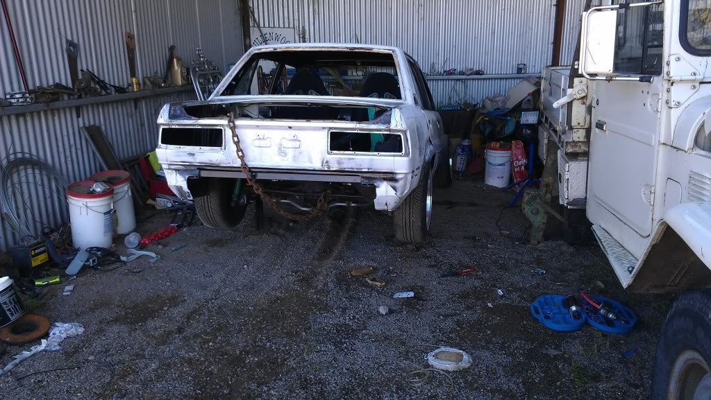

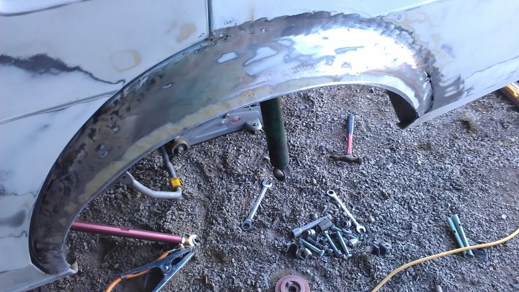

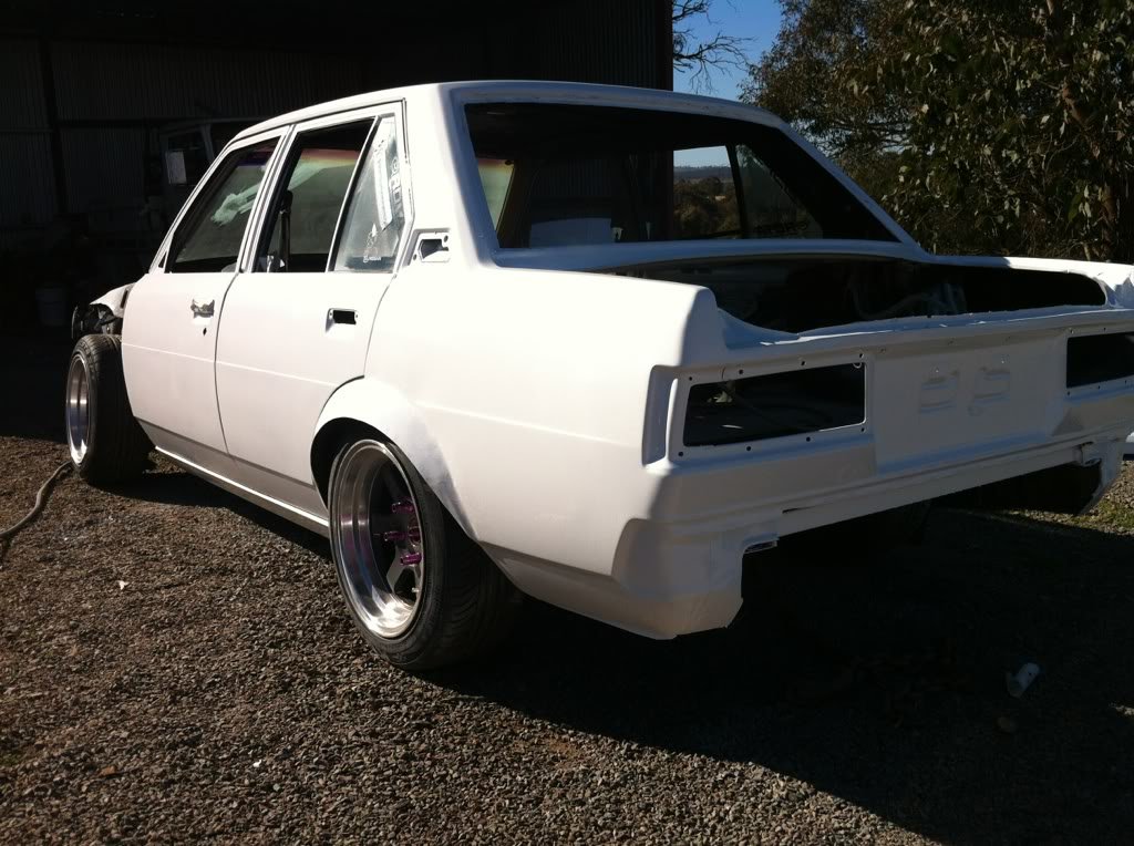

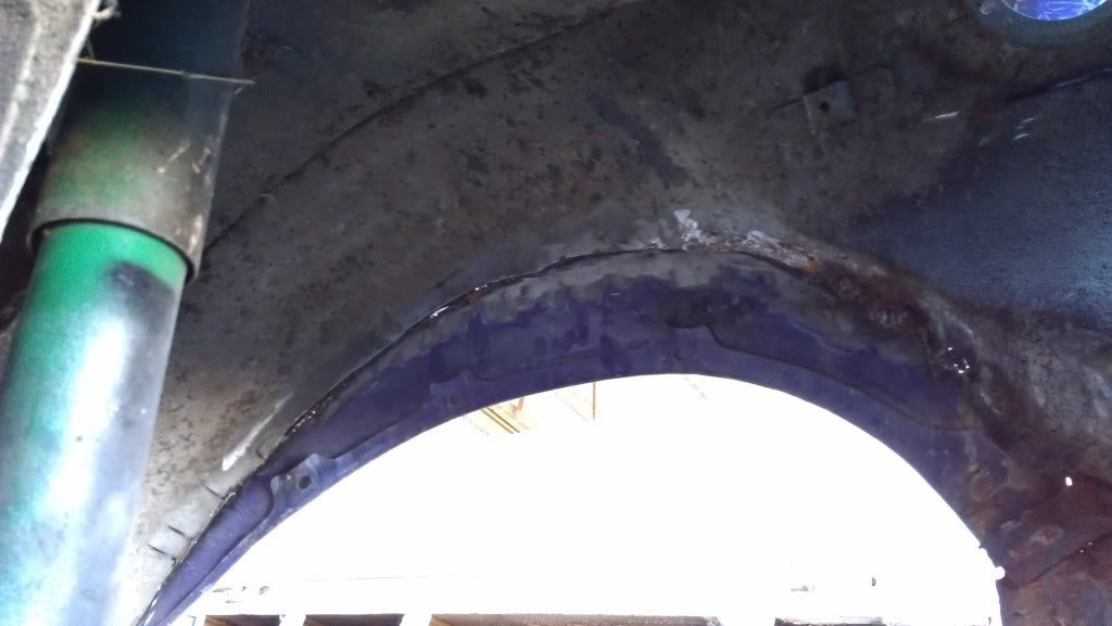

    right into the body work getting ready for primer, seam welding the diff mounts and rails inside the interior etc, I need to get my shocks re built, welded a bit of the inside of my rear flares, then run out of gas, so I stripped the rest of the car and nearly got it all rubbed back ready for primer, I stuffed up my perfectly bog free rear flares when I welded the inside of them (should have had a wet rag handy) so I'm going to have to out a layer over them, as well as a few other small spots, not too worried about the panels being perfect, as long as the paint turns out nice and glossy.. it's not exactly gunna be a show & shine car.

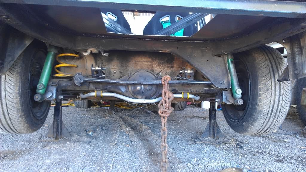

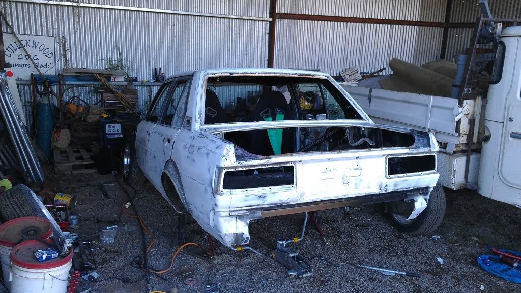

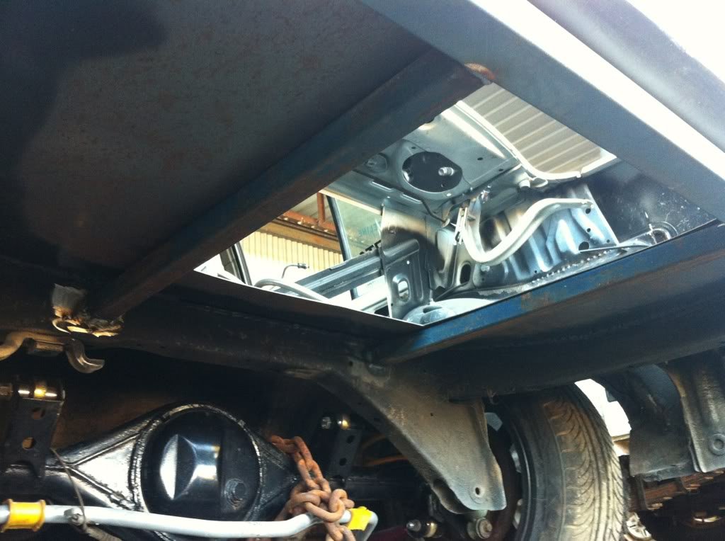

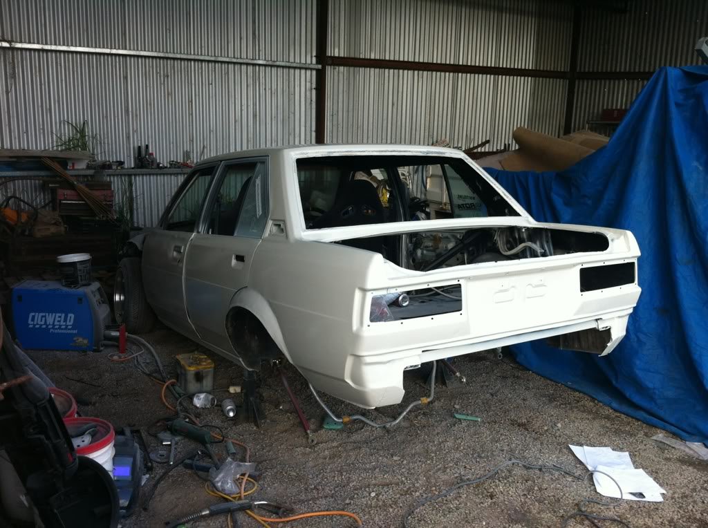

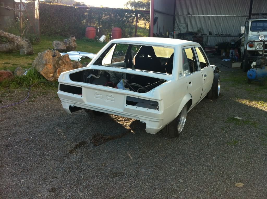

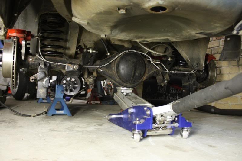

    haven't updated in a while, but I haven't really done too much. for 99.9% of the welding done, frame made up for the drop tank, just have to get some gas for the TIG welder and do the surge and cell fittings, got the t-series diff in and got it rolling again, finished all the sanding on the body and give it a coat of primer, Its pretty rough but dilligaf? just have to finish the front guards and bonnet and lay a top coat on it..

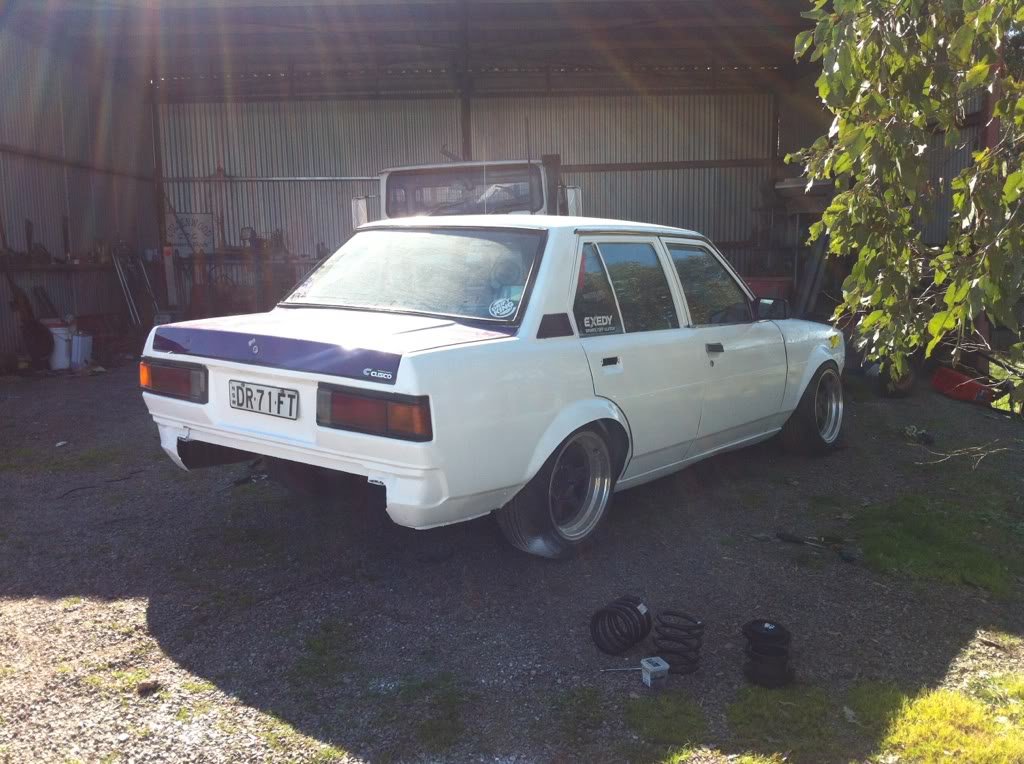

    got the thing painted and slowly putting it all back together, new bailey channels and rubbers.. few other bits bla bla
    over spray and runs central.
