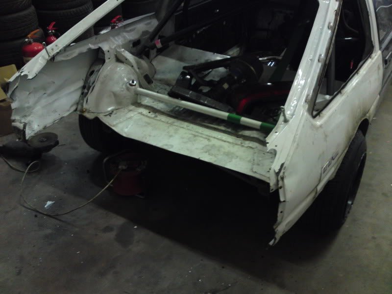

    d-mac makes a fibreglass roof replacement i believe. that will be a good c.o.g saving item. if you were to run fibreglass rear over fenders you can get rid of almost all the metal behind the rear strut mounts. as you said it would look normal from the outside but it would just remain a skeleton inside.
    similar to this but retaining the where the tail lights and shit go
    John
    Hobart
    2,200
    CSO Japan make a carbon roof skin... *dreams*
    Aug 2010
    Sutho Shire
    752
    in the pic above of white 86,what is he going to do with the rear end?
