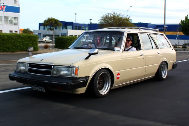

    So after a bit of a stint away from automobiles I was over having a V6 guzzling 4x4 and found something that I just couldn't resist.
    1982 MX62 Cressida Wagon.
    1JZ GTE twin turbo engine
    JZZ30 Soarer motor and auto gearbox
    Stainless Twin dump pipes
    2.5 mandrel bent exhaust system
    Stainless metal cat-converter and straight through muffler
    Front mount inter-cooler off Evo Lancer painted black
    Front mounted transmission cooler
    Bosch 910 fuel pump
    2JZ GTE injectors
    Standard Soarer ECU
    Greddy E-manage Blue piggy back computer
    Greddy E-manage Blue plug in harness
    Greddy boost controller
    Greddy turbo timer
    S13 Silvia adjustable coil overs with adjustable strut tops
    S13 Silvia strut brace
    S13 Silvia front knuckles, hubs and brakes
    Standard open centre diff
    Makes 255 hp atw on 14psi boost
    13.1 1/4 mile @ 106mph turning the tyres
    Plans
    - Set of wheels, will be looking at 15x8 etc.
    - Some form of diff swap and rear disc set up. I've had a few suggestions thrown at me by the local diff joint and others. Toyota F-series with TRD two or R31 diff and brakes LSD and billet axles.
    - Single turbo conversion. As you are probably aware the twin turbo set ups are prone to shitting themselves when boosted above ~14psi. I'd be keen on it making decent reliable power.
    - Manual conversion
    - Seat, wheel yadda yadda yadda
