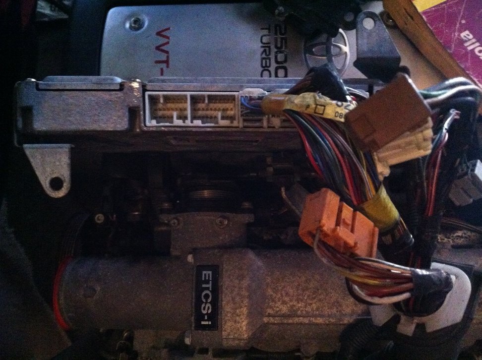

    I bought a jzs171 engine thinking it was a jzx100 without really looking into it too much...
    But I think aside from the etcs-i sensors breaking, I think this engine will be an easier install than the jzx100 as all the throttle body stuff is integrated into the ecu. If i get speed sensors , there is no real reason why i can't wire in the traction control as well.

    I've managed to find the JZS171 ecu pinouts... They are the same as the jzx110.

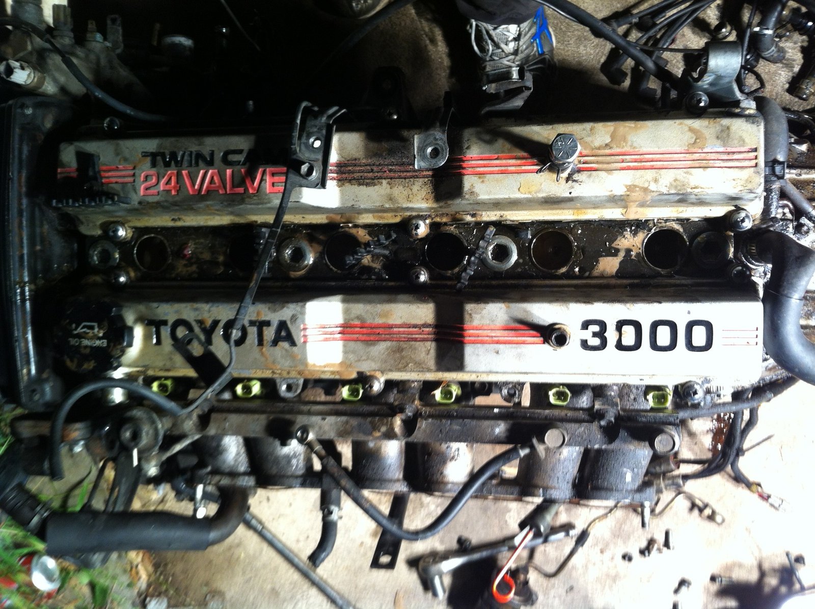

    The 7m was removed over the weekend.

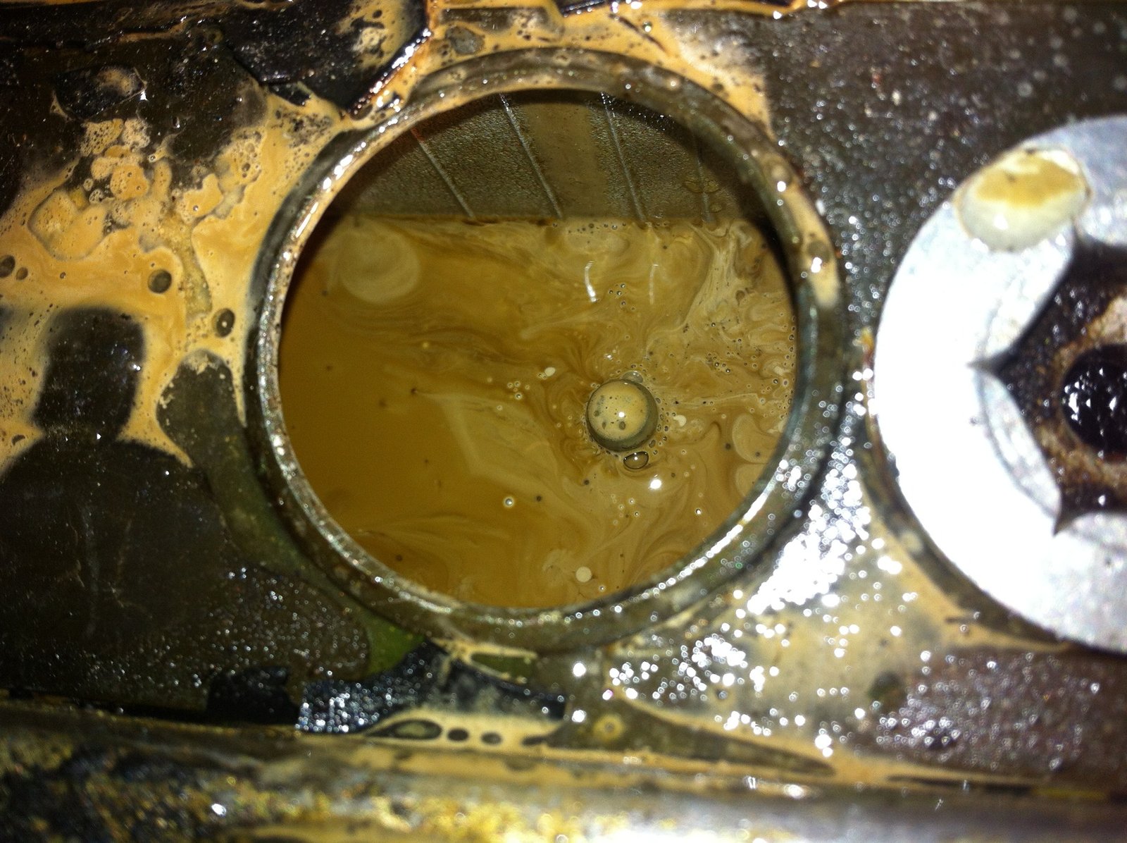

    It definately has a blown headgasket.
    or a closer look. Yep that is the tip of the spark plug sticking out of the chocolate milkshake.
    Though the oil out of the sump, whilst black was normal and the coolant was normal. I haven't managed to get the cam covers off yet, as a bead of what looks like toyota sump sealant has been run around it and the dizzy had the same.
    I'll probably pull it down to assist with easy disposal, but if anyone wants the 7m sing out.

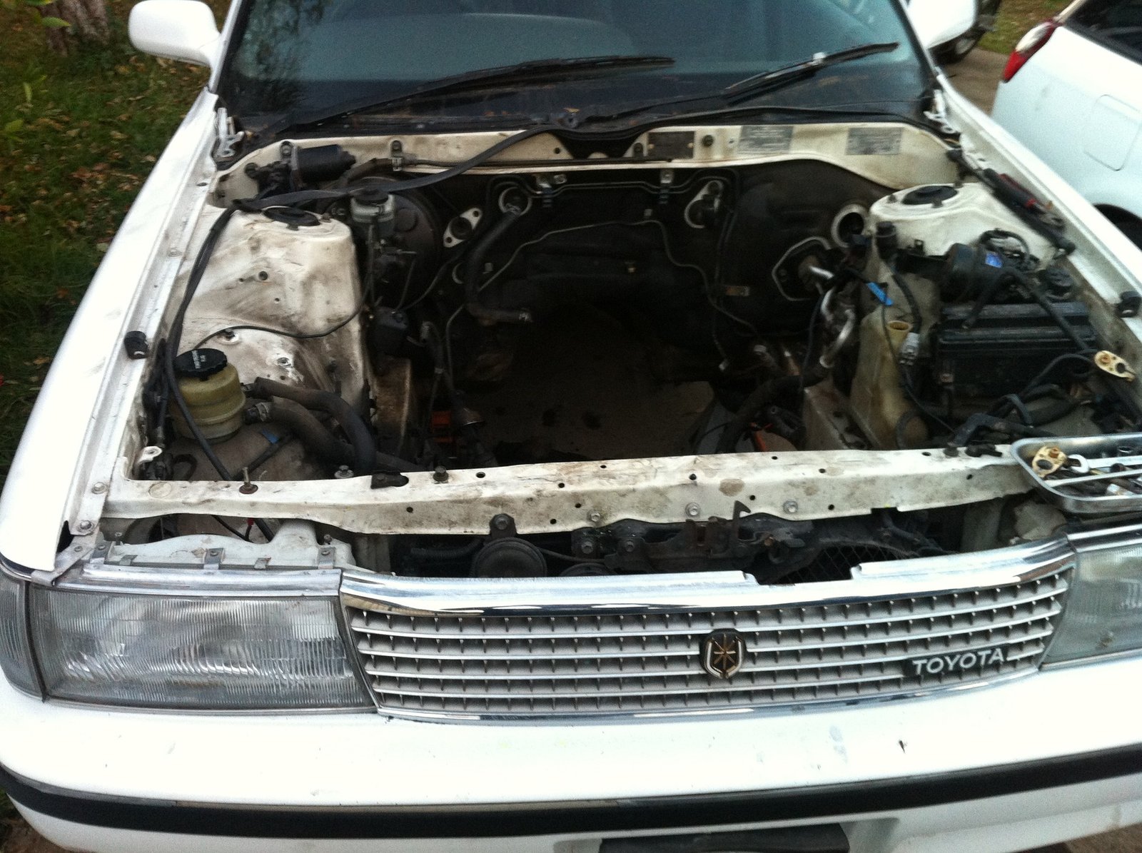

    Minor update, spent most of the day tracing out the loom of the jzs171 and am very confident that when i drop it in it should start.
    Also spent a couple of hours degreasing / washing down the engine bay to make it look that smidge better.
