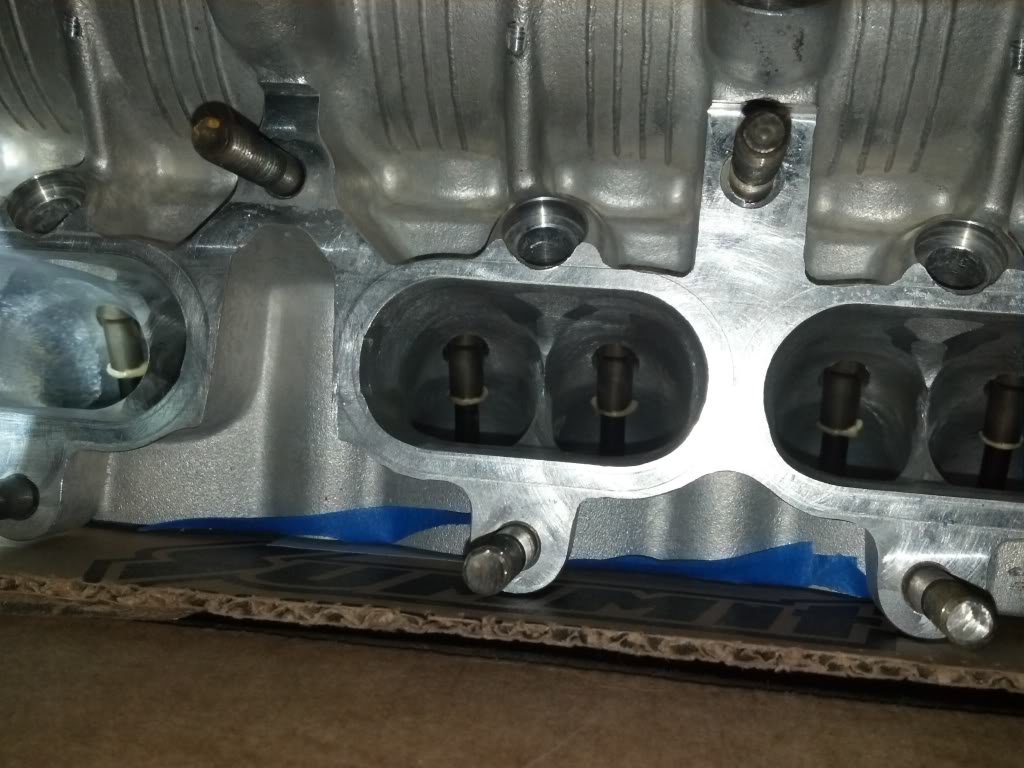

    hasselgren ported atlantic 16v head...

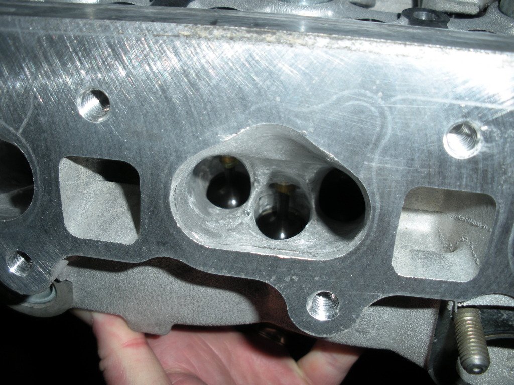

    hasselgren ported 20v head

    Thanks for posting up the pics. The 16V head above is a head that Billy Andrea (Edmonds) had for sale a while ago. Billy is a personal friend of Paul Hasselgren and I believe he has a guy from his shop work after hours to build these heads. This head is ported to suit the TRD Atlantic throttle bodies and is rated for approx 245hp@10,000rpm.

    nice work spotting the head mate...the 20v head is billys personal head...which made 210hp

    What I found interesting is how nice and clean the entrance of the intake port is and yet the blending down the back is probably what most would call average. All Hasselgren heads are like this and I have seen discussions on how disappointed some people who have purchased these heads have been. Hasselgren obviously know the main points of how to get the head to flow and concentrate on them the rest is just a quick tidy up.
    I know a guy here in OZ who purchased a 20V head from Tony with the HKS 20V stroker that Quicksilver race engines had done exactly the same as his head. This head came over bare and he has since got it built buy a head shop here. The first thing the guys said to him is they weren't happy with the quality of the port job and they would like to blend and clean it up before building the head even though it performed very well on the flow bench at Quicksilver.
