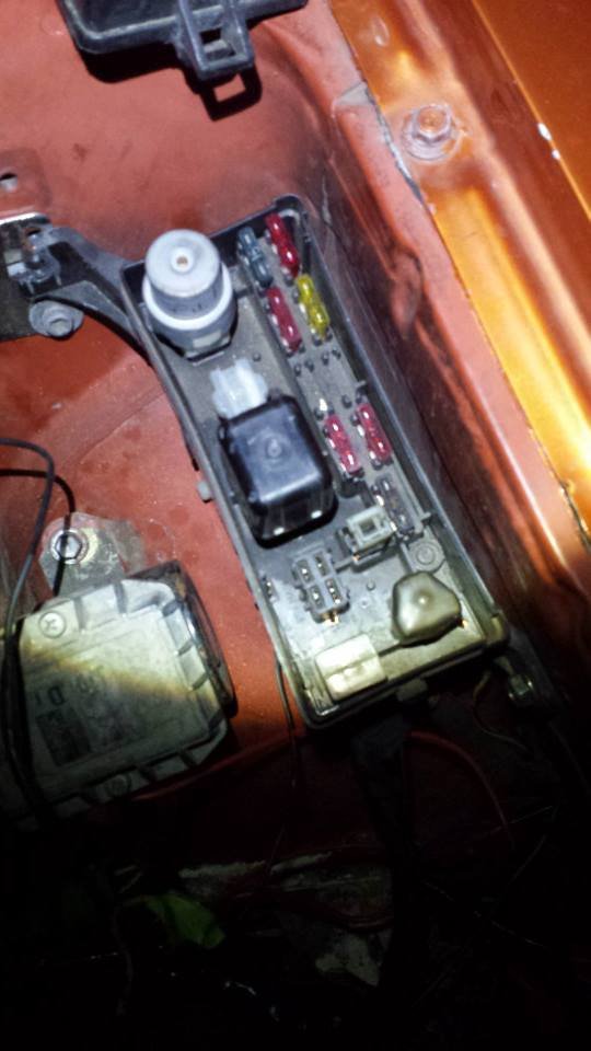

    Many question guys!
    My ISCV has no lines connected to it.. When i start up the car, it literally struggles to stay alive when cold, you have to give it a bit of revs to help it stay on. But when it's at operating temp, the idle feels way better, sits at around 1k rpm, and doesn't feel like it's going to die.
    1) Question is, is the issue caused by no coolant flow through the iscv? If i was to plumb coolant lines back onto it, where do the other ends of the coolant lines sit?
    2) Ive heard that completely removing the ISCV module fixes the idle problem. I'm planning to run A/C in the future, what problems would i run into having a/c without the idle up control?

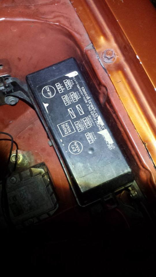

    3) Is this an AE86 4age fusebox?
    Any info would be greatly appreciated!
    thanks guys, sorry for the noob questions ahah

    Yup that's an ae86 fuse box. Where's the relay of the 'EFI MAIN' ?

    Yeh mate having no coolant running through it probably means it is seized. It opens up an air hole behind the butterfly to idle up when cold and closes it off as the coolant heats up, same sort of thing as a thermostat, but a lot of them seize so people just bung em off. You could try plumbing them back up but not sure where they run to on the engine side of things, I've always had carbs.

    I have no idea... There are quite a bunch of other relays right in front of the fusebox, near the headlight, so im assuming it could be one of them. Going to get a new engine loom etc anyway and then take it to an auto elec. Sick of this dodgy cut and shut loom
    thanks for the info mate! Ill try that, either ill block it off or buy/make a blocking off plate haha.
    Do you know if it'll still idle ok when cold if i block off the iscv or do i have to help it a bit with throttle?
