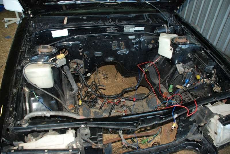

I started off by swapping over little bits and pieces, trim, engine bay accessories and the headlights. The drivetrain and suspension will be installed next trip. As I've mentioned in another thread, the radiator support in the new shell is not an ae86 item and has caused great frustration. Nothing lines up, the bonnet catch cannot be fitted, not even the bonnet stand! The headlights will not bolt on without some fabrication and cutting as there's no mounts, and the holes line up so poorly, the wires cannot be connected.
The lights are attached only to the fenders at the moment, and you can see some of the problems its caused below.

This morning saw me attacking the wiring. Aftermarket management and several engine changes in its lifetime had left the wiring loom in a rather scary state. Because half the wiring was handmade, there were a lot of wires that had to be labeled and unpicked. Several wires for the adaptronic decided to fall out of the plug, so these will have to be sorted out before it will run again.

That radiator support is definately an e7 item. I guess you will remove the rad support and lower panels from the white coupe by drilling out the spotwelds and getting someone to weld it on for you.
