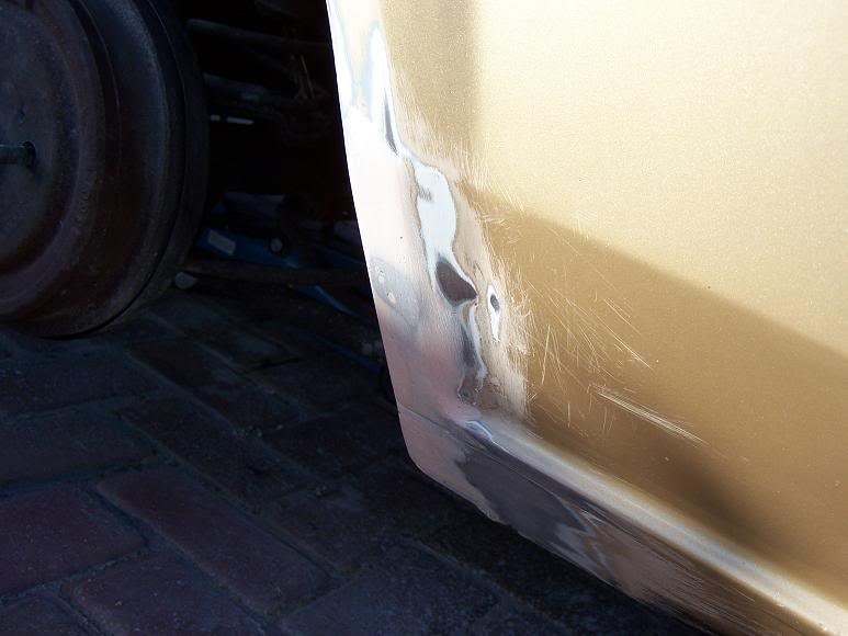

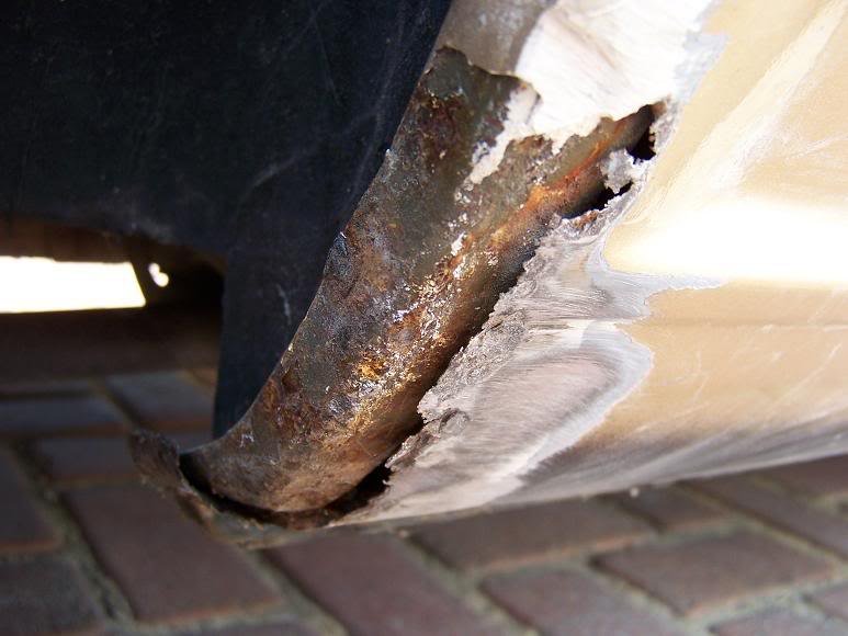

    Started with fixing some rust (not all rust is shown, there is plenty more where that came from)
    The rust was ground out, treated and then using a fibre filler to fill in the gaps. I plan to get it welded up before I respray the entire car soon.

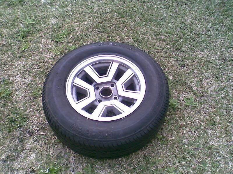

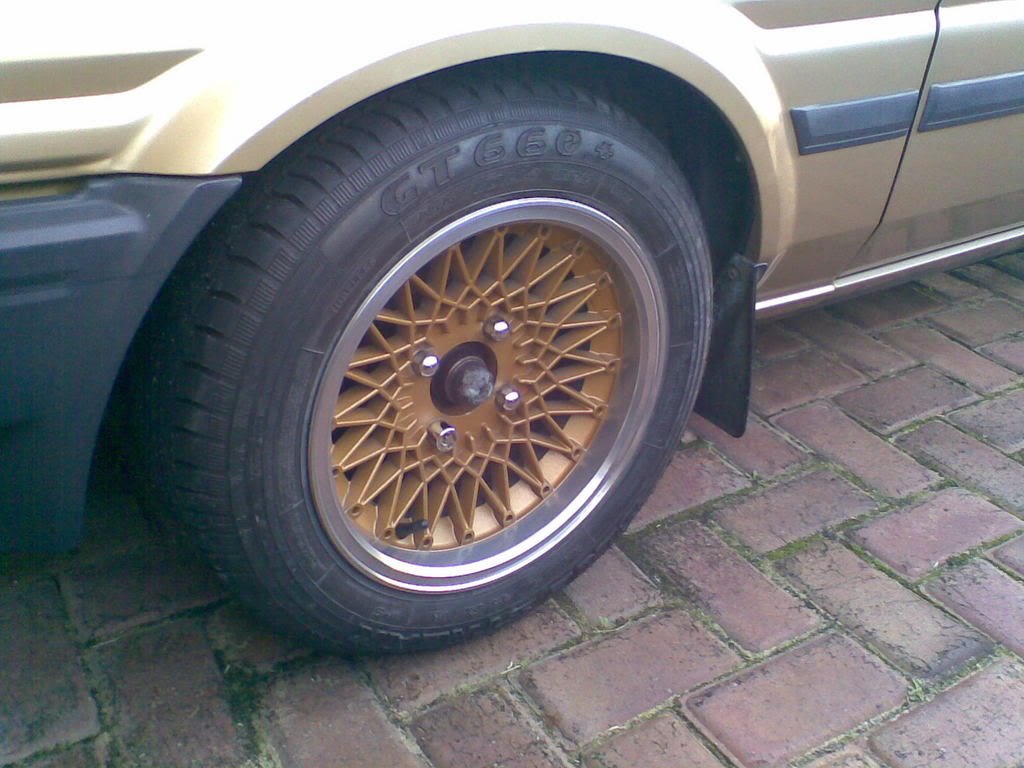

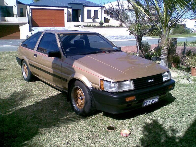

    I then got some gold 14x7" unknown meshies with decent offset (no offset printed on rim, but the look between +20 to +10)
    This is how it stands today
    Plan to get some suspension in it soon, fix more rust when weather/time permit and get it completely resprayed (not sure what colour yet, definately not white)....

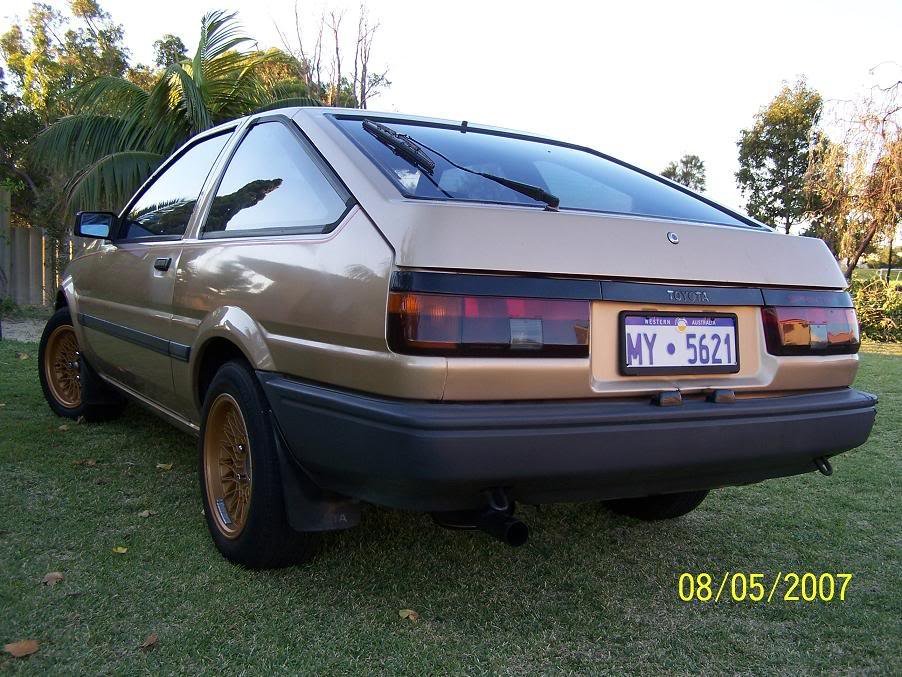

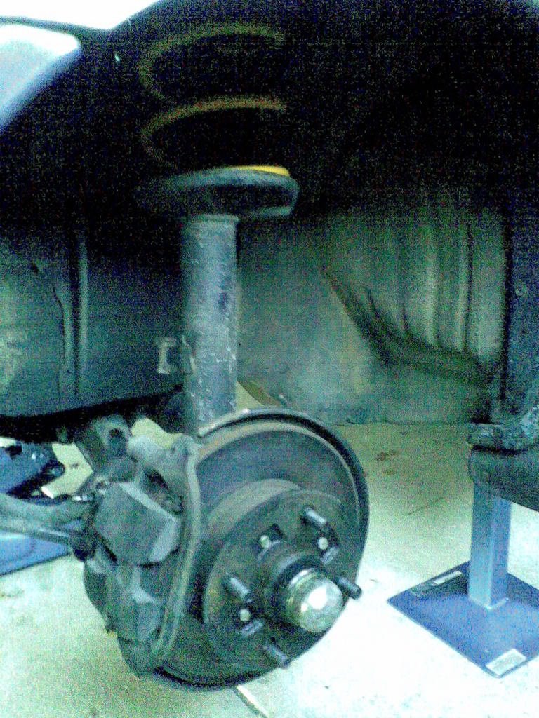

    Got some king springs and kyb exel-g shocks for the front and back put in. The rears are chopped but have short stroke shocks to suit. Fronts are just normal height. I also put some random jap brand camber tops in. Much better to drive now than with the stock stuff

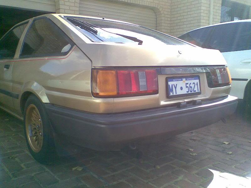

    Pic of how low the rear is
    Also got some full face tail lights on Wednesday (thanks ken) to give the car that jdm look

    - New struts with ajps 8kg springs and kyb excel g short strokes fitted
    - Replaced front brake hoses
    - ajps 6kg rear springs with kyb excel g short strokes fitted

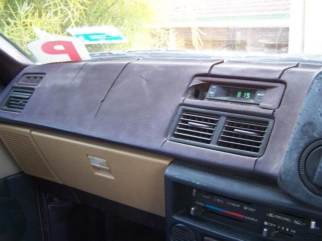

    - Removed mega cracked dash and replaced with a less cracked dash (took about 2hours)

    First thing off the list was the suspension (8kg-Front/6kg-Rear). Together with kyb excel-g short shocks, made a massive improvement in the cars handling. Here are a couple of pics taken just before the brake shop rang to tell me the new hoses were ready.
    Next i decided it was time to treat some more rust (woooooo what ive always wanted to do <_< )
    From this:
    to this:
    The rims looked a bit plain so i did this to them

    Now for more than 6months, every time i looked at my dash it reminded me of a dry desert (also smelt funky). So what do you do? Swap it for one with less cracks of course!
    Also fitted the new clock surround to complete the minor transformation (and man that thing was hard to put on!!)

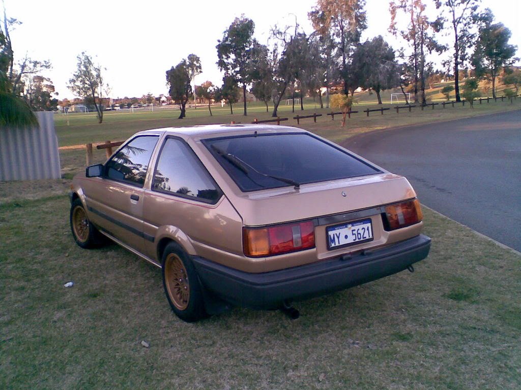

    Last sunday was the OST cruise. After weeks of rain it was actually a nice beautiful day, so i gave the car a clean. I also half arsed polished the back rims to match the fronts.

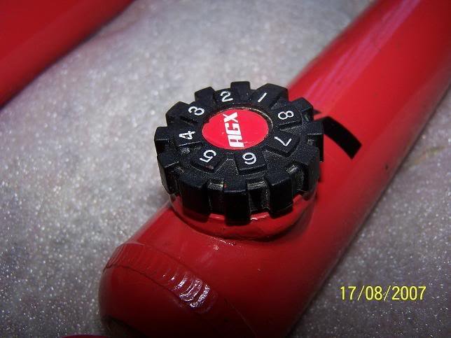

    Camaro AGX 8-way shocks
    Powersteering arms
    I fitted the shocks on friday afternoon and i must say they are fantastic :crazy: I hopefully can install PS arms tomorrow along with the XT130 LCA's.

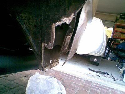

    Picked up a mig last week so im ready to tackle the rust for good and make extra things. Began today by cutting out all the rusted sections of the lower passenger quater panel:
    So far only welded one section in and then it got too dark to see. Will continue on wednesday (should have a coat of paint by then). Next will probably be the beaver panel lower section (you can see how bad it is) and some other spots too.
    It may not look pretty at the moment but the lower section has been replaced with a rust free cut out. All it needs now is a bit of smoothing with bog and a coat of paint
    From this
    To this
    Anyway, got some primer on now just before the rain came today. If i get a dry span, ill finish painting it but weather forecast says showers up until sunday.

    Think it turned out pretty good. Just gotta spray some cavity sealant on the inside and the inner guard.
    Finished off the rust repairs last week with some final coats of paint. The inside of wheel arch was resprayed with fresh underbody and cavity sealant (the inside of quater was also sprayed with both cavity sealant and underbody) making it look all minty fresh .
    Note, pics taken before clear coat applied.

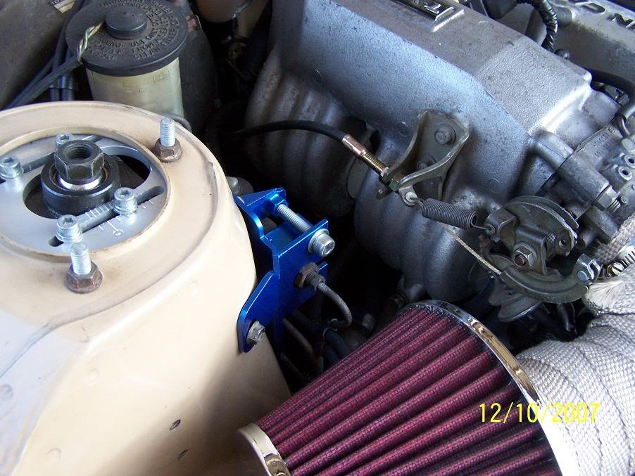

    JDM Calipers and vented/slotted rotors (Thanks Gilly)

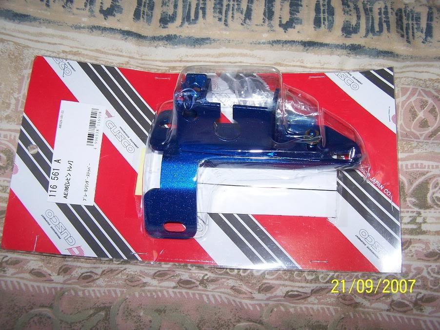

    Cusco master cylinder brace (Thanks Z10)

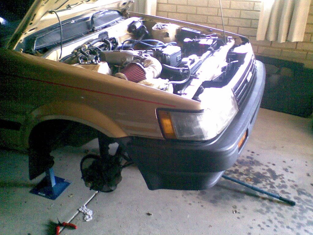

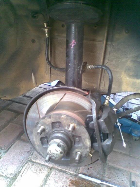

    Early part of today was spent putting the new brakes on and fitting the cusco master cylinder brace.
    Took the wheel off and found too much lock wears paint

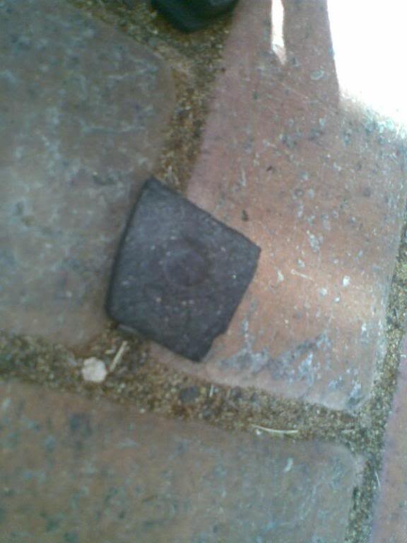

    Began to remove the adm calipers when something decided to just fall out:
    I guess thats what happens when you use standard brakes at the track lol......
    I then proceeded to take the hub/grease cap off with my pliers ready to tackle the split pin............................................exc ept there was none :wacko: lol, ive been driving something that could be deadly...
    In the end, i fitted and bled it all, took about 1hour
    Brakes feel much better than before so now i need another track day to test it all out No pics of the master cylinder brace installed, should know what they look like

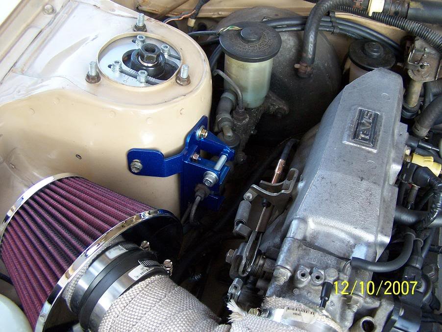

    Update time.
    The last couple of weeks were spent living in Bathurst for the Bathurst 1000 so not really much happened to my car. I did however had a look at the original Group A ae86 at the motor museum which i took lots of pictures as to how it was setup (a lot of under car shots which i may post up later).

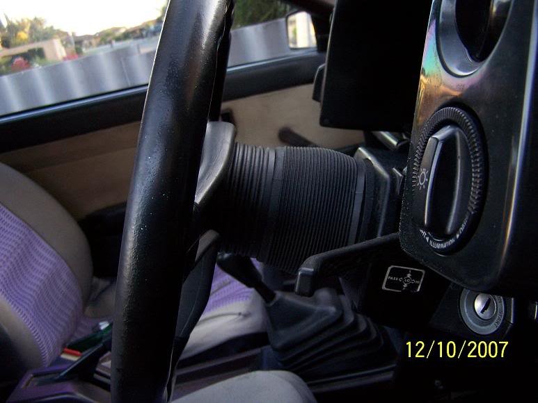

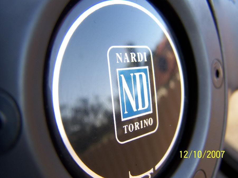

    Anyway, today my Nardi Torino wheel arrived in the mail. Thanks Gilly

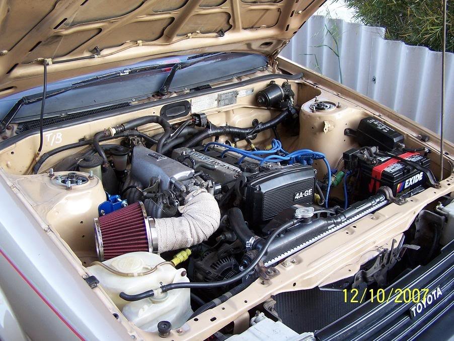

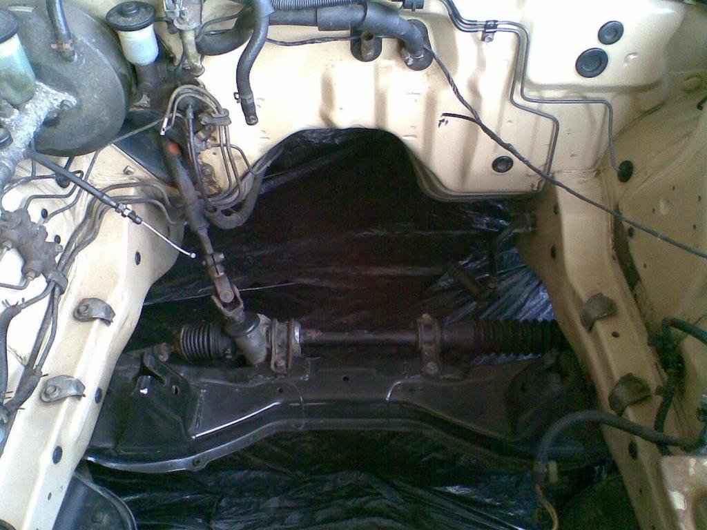

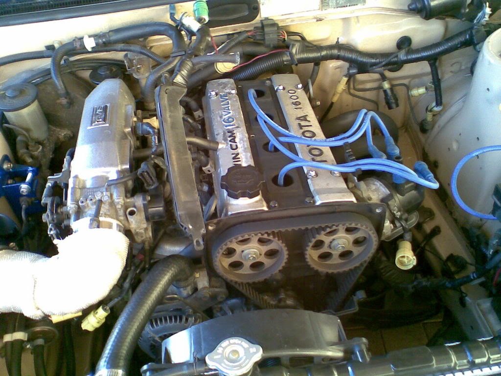

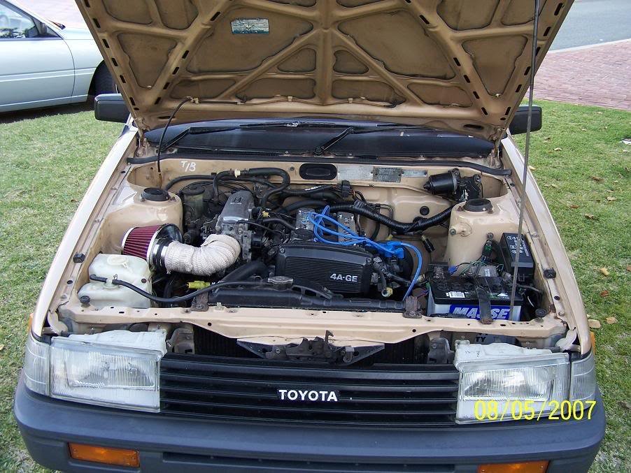

    Some pics of how my engine bay looks
    Also there may be a new engine on the cards very soon if all goes well, more info shortly

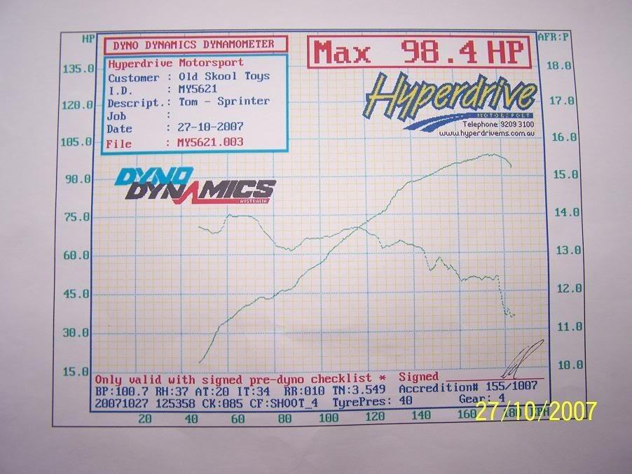

    Attended a dyno day today, pic speaks for itself:
    Sadly, one of the last events this motor will see (in my car ). Have managed to secure which will be going into the car in a months time (and yes, i am going to fix the cooler piping)

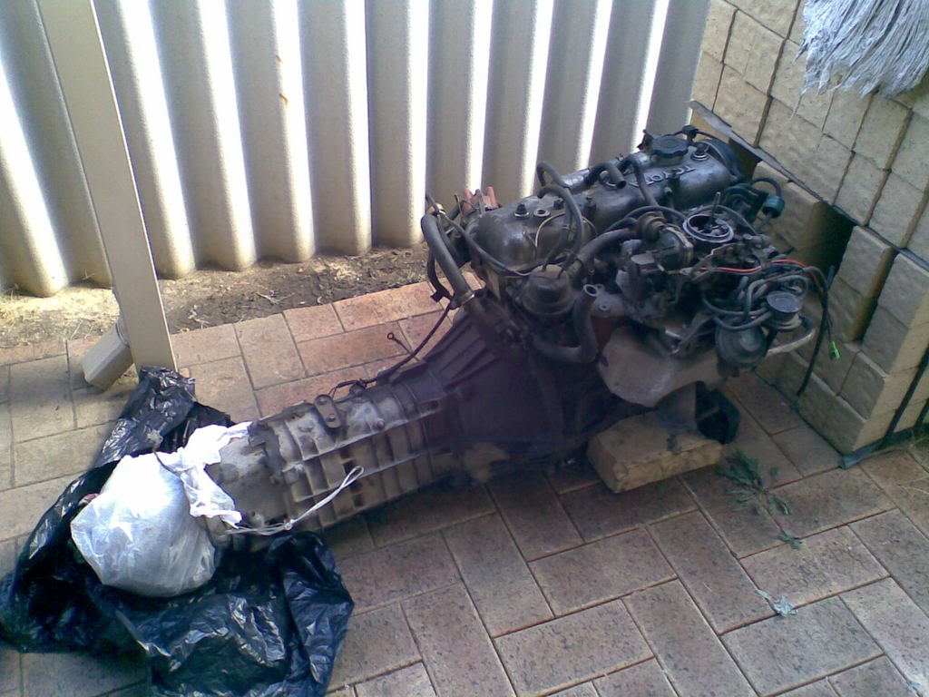

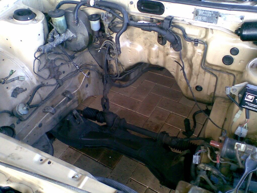

    Engine arrived. Once finished exams, began to pull it out and do the conversion
    PICS:

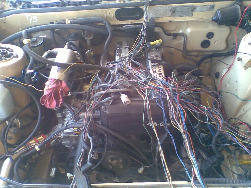

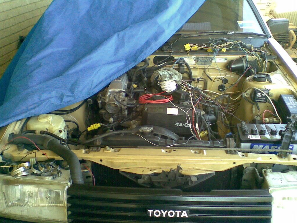

    Motor is in, and bolted up. Tail shaft needs to go back on, a few more things tightened and then i can start the cooler piping (just a bit of trimming and drilling).
    If i get time, will start on wiring but at this stage it will be friday.
    Well, been too busy/tired to update but i'm happy to say the car IS running
    Unfortunately it was not running in time for the cruise (Big thanks to Matt and Ken and other good mates for giving me a massive helping hand trying to get the thing running). It would have been running for the cruise, only needed power to the injectors to kick it into life.
    Still need to do things properly (such as reduce the amount of zip ties holding things on), and neaten the wiring. Motor feels fantastic, can't wait to take it to a track day (no real long stretch of roads to test it out properly).
    Pics, will get some better ones soon.
    Just in:
    During wiring:
    Done (dodgy ):
    I do have some pics, but at the moment im shaped so uploading is painful. I get unshaped tomorrow so i'll try and get them up after work.
