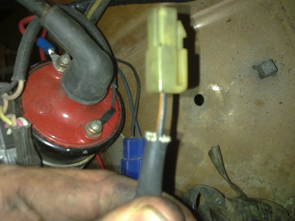

    1) This is how i wire up 12v ign to the coil using one relay and an existing wire in the engine bay (This is a ke70), as he has stated there is a black/orange wire on the passenger side of the engine bay. Pictured here:
    You use this as the trigger to activate the relay. Connect this wire with the existing terminal on it to 85 on the relay.

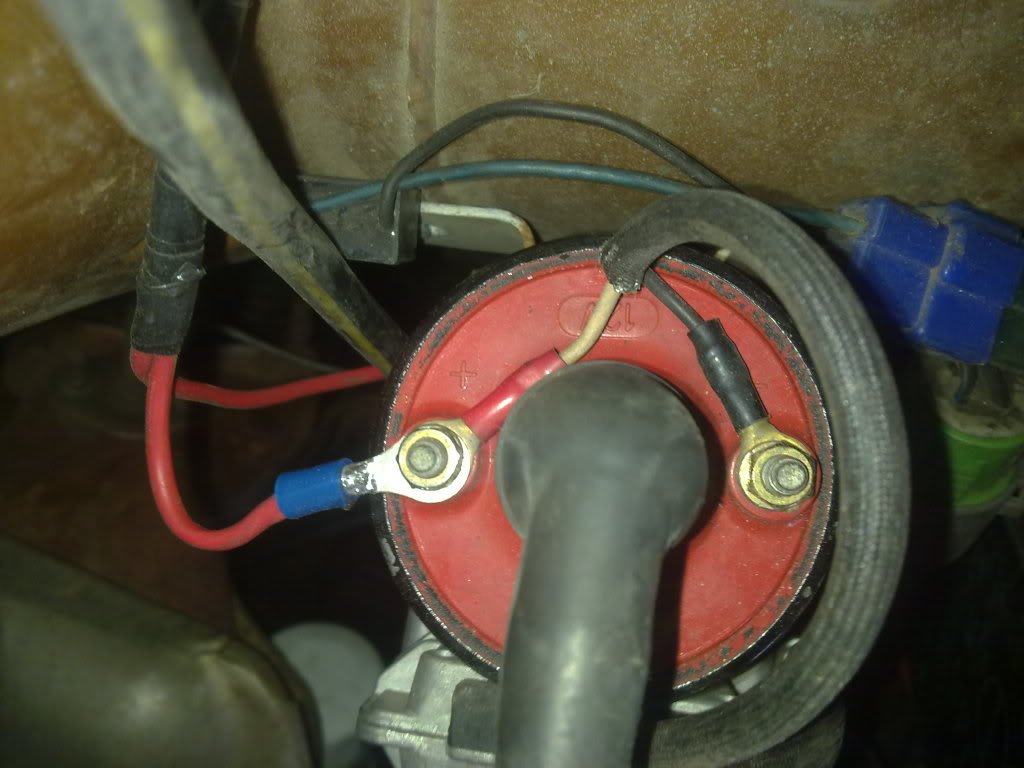

    Pictured here is the coil with the added 12v IGN wire from terminal 87 on the relay:
    Lastly run a wire from terminal 30 on the relay to the battery +ve.
    If you have followed these steps exactly, then when you turn the key to the 'ON' position, you will power up the ignition system of the 4age and all you have to do if power the ECU and injectors and it will start.
