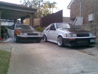

    darren i want ur job .... lucky sucker to have 2 86s i cant find one
    2 in the pink 1 in the stink

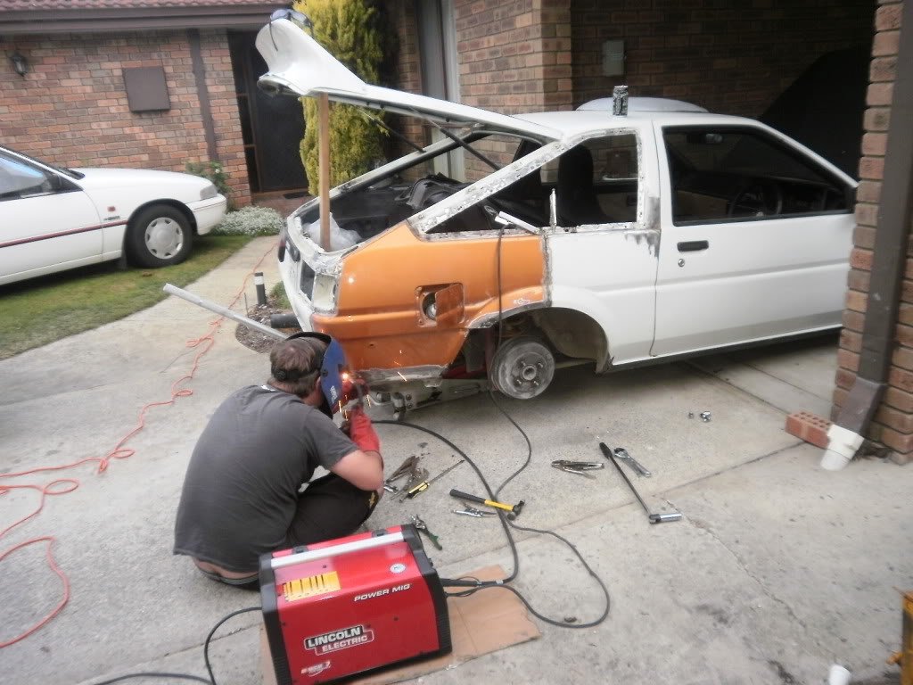

    mate wanted to have a weld! so i said yeah you can weld down here for me while i snapped this picture. started late into the arvo round 3 an by 6 couldnt see as it was to dark an there was welds where there didnt need to be welds. did some practising on a old car bonnet and found a pretty forgiving setting with out blowing too many holes yet still giving good penetration an joining power. quite easy. weld a bit an tap the next bit flat with a hammer, weld a bit. Actually really fun!!!

    crazy as a cut snake hsss! haha yeah man been back for months!! time to go again i reckon. yeah just tackin it, tis the only way to not blow a hole lol. probably 1000 tacks so far. arrr see your flairs are on the roof my son along with a cool beverage and a pair of sunglasses. i have a plan..........................................

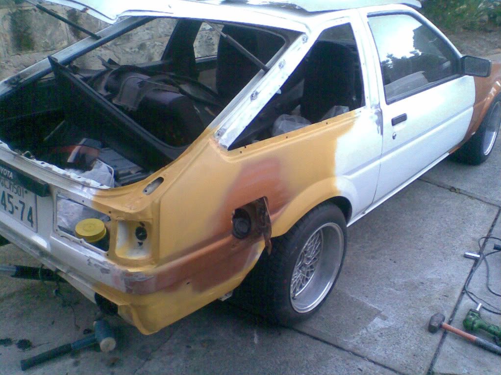

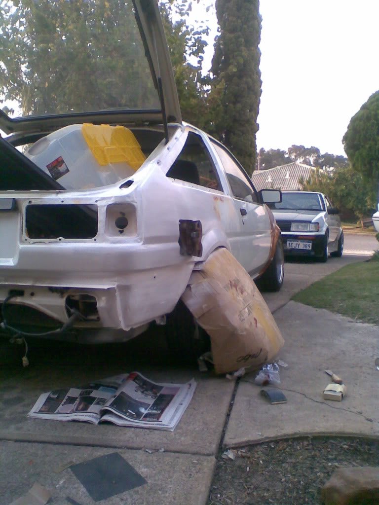

    had a small sucess. came up perfect, spent about 5 hours bogging and sanding it all. the vertical join only needed the lightest smear of bog then sanded it all flat, primer filled it and sanded smooth again an gave it a quick seal coat with white topcoat. good enough to waterproof it for now.
    progress is slow because i work 2 weeks away 1 week home, so i get more time to think about it than work on it haha

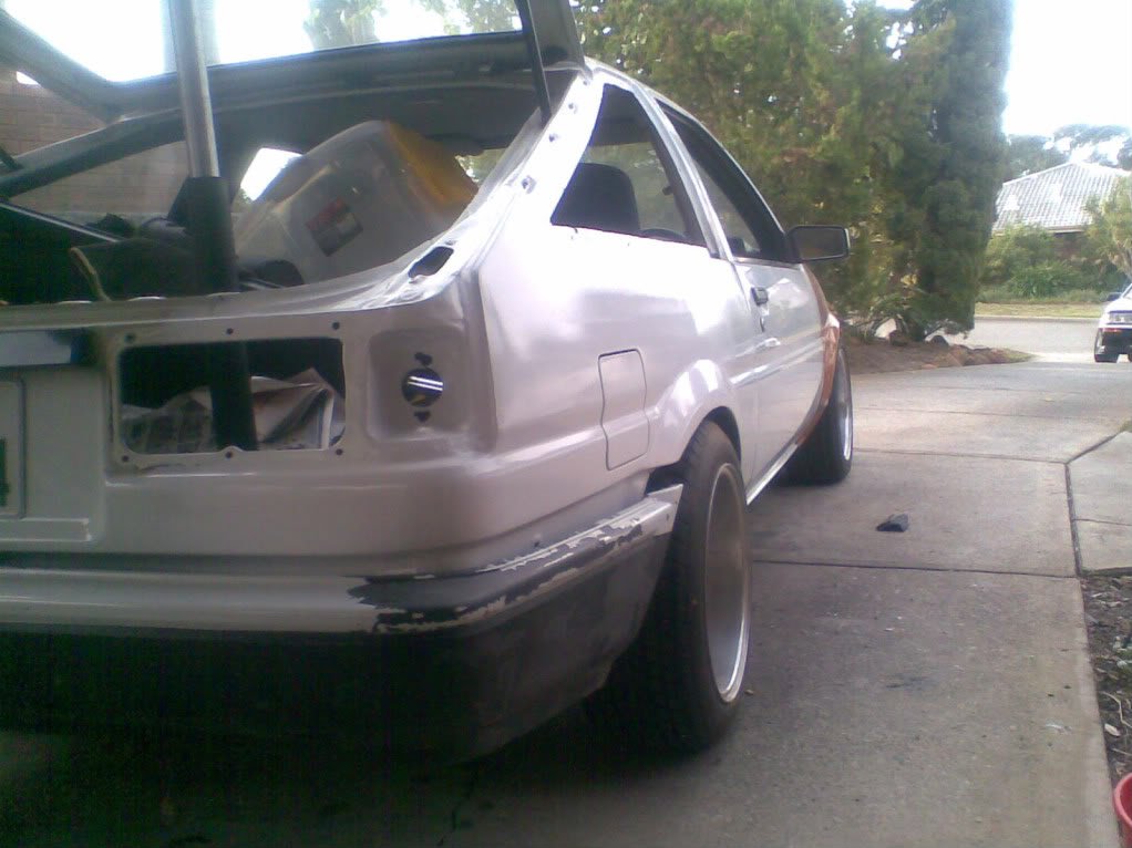

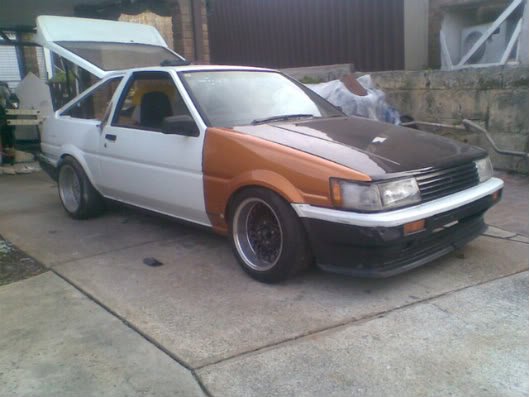

    pretty much finished the quarter, been attacking rust around the door jamb lately. all welded up nice and fresh
    progress is going good need smore fixing here and there...
    hmmm been trying for a hour to get the pics non sideways, im going to sleep
