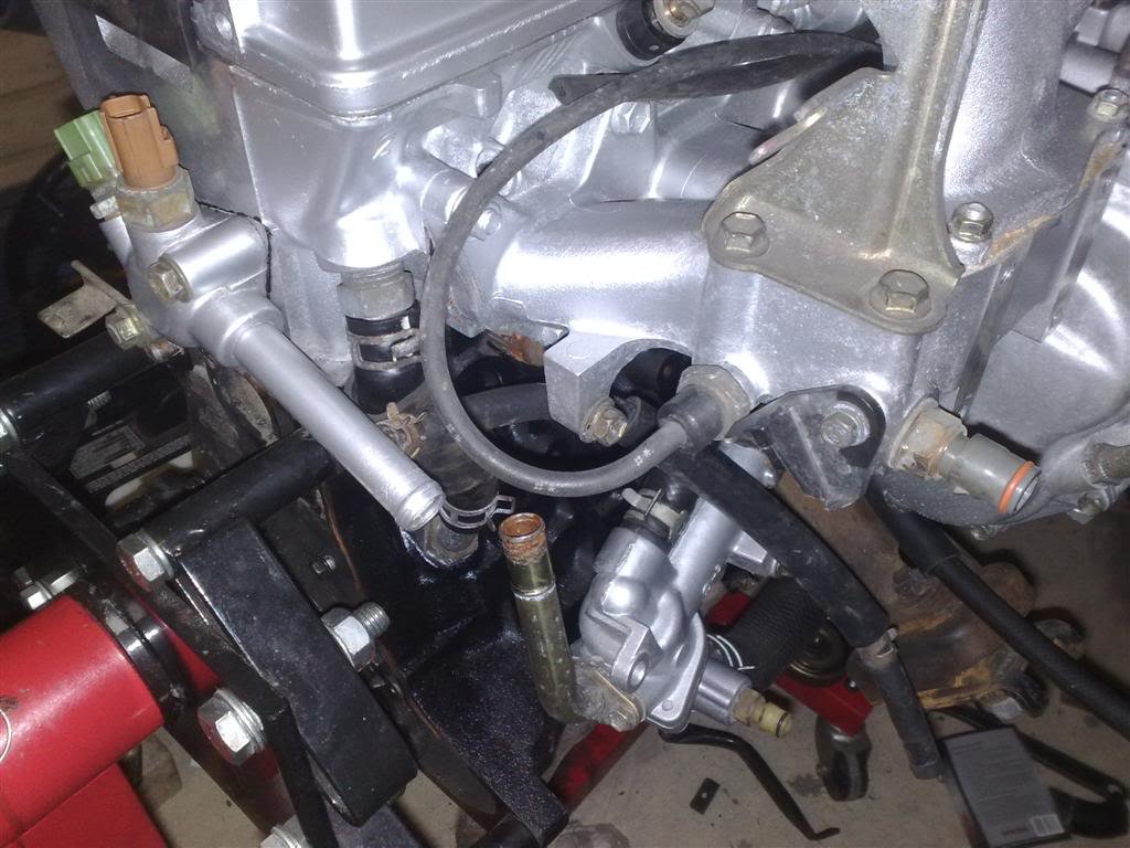

    Arrh im an idiot i labeled everything on my 4AGZE when i pulled it out but got carried away with engine enamel and painted the things i label ahahahah genuineness ay. not so much a problem but now i forgot where the map sensor plums into exactly some one has to know please help me

    Plums into a part which sees boost. Assuming its a standard ecu and therefore a smallport engine, the map sensor line connects to the single port on the rear of inlet manifold.
